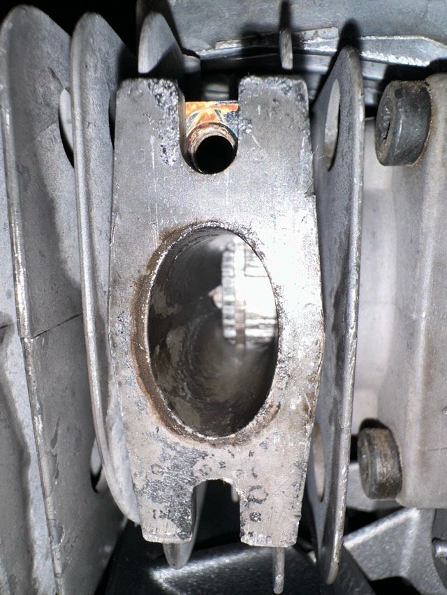

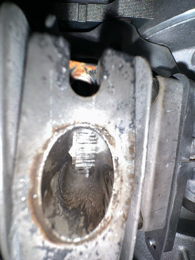

    Well, I was mistaken when I said it had compression. It has a little resistance on the rope, lol.
    Pulled the muffler, screen is clean. Piston has grooves galore.
    My money is on someone ran it with straight gas and that’s why it was locked up.
    Hard to get a photo but that’s the piston through the exhaust port.
    sdk1968, Kbar, ACEkraut and 3 others like this.

    Do you have one of those inexpensive boroscopes they sell on Amazon?
  16. Oct 14, 2024 at 9:10 AM
    six5crèéd
    six5crèéd [OP] Be the light
    Jul 9, 2019
    #298734
    36,225
    Southern Virginia
    8 lugs no plugs
    I do but I can see in there good, just can't get a good photo of it.
    sdk1968, Kbar, koditten and 4 others like this.

    :eek::eek::eek:looks bad

    The scored can shows up good on the 17" monitor. It's dead.
