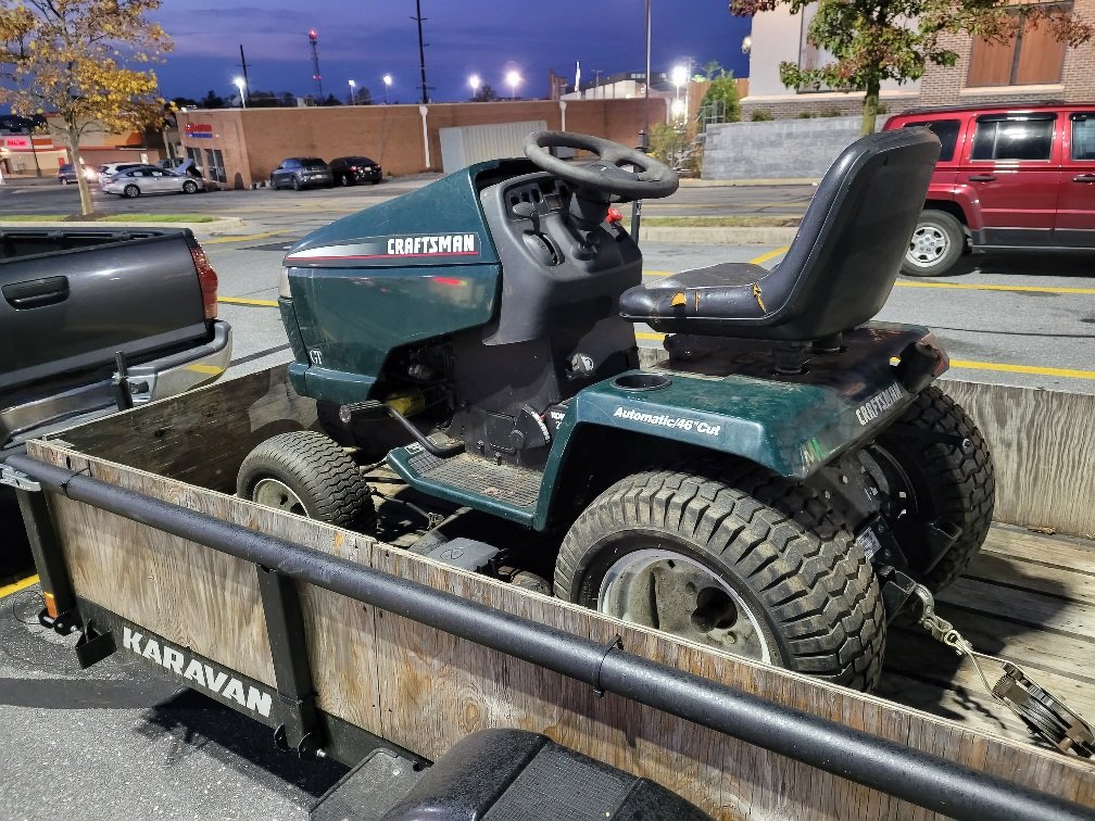

    I picked up a new(er) turd tonight... 1990's Craftsman GT w/ the 46" deck hydrostatic transmission and a 24 horsey, 2 cylinder Kohler engine. $50.. It cranked with jumper cables, dead bat-tree. It supposedly was running great until it didn't. I will put a bit of effort into it tomorrow, it could be a good beater if it's just a dead "nanny" switch somewhere.

    Please post the deets! I bet it takes little fiddling to get it running.
    Poll:
    1)Bad carborator solenoid plunger?
    2)Bad seat shut off kill wire to the coils?
    3)Plugged fuel filter?
    4)Ain't got any gas in it?
    5) Needs new spark plugs?
    (It's never the plugs)
    6) Mice chewed the wire harness?
    7)Mouse nests/vermin have plugged all the cooling fins and it's gonna need head gaskets?
    8) The charging circuit fuse was blown and no 12v+ to the fuel shut off solenoid is present.
    9) if the engine fires, but won't run when dribbling gas into the the throttle throat, there may be a sheared flywheel key.
    Of course I'm having a little fun, but these are all things that plague the Kohler engines.
    It's always the simple shit that shuts down a mower.
    @six5crèéd feel free to quote the list and make a poll.
    Let's see what the squad thinks and hopefully we get a results within a few days.

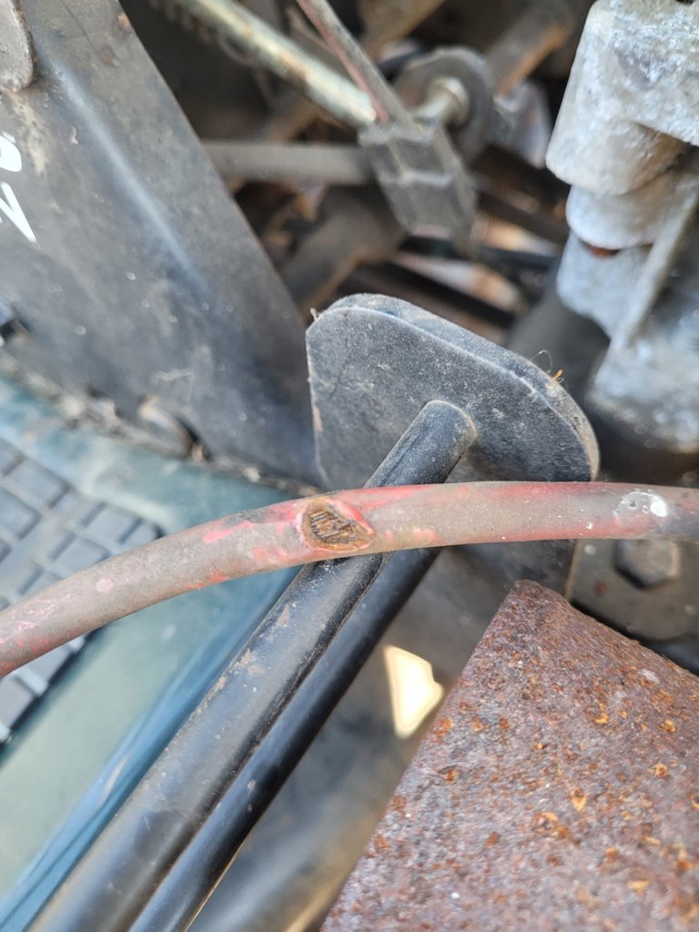

    Damn, a poll... That's kinda weird and funny at the same time! I farted around with it today, I didn't get very far. The battery had 7.5 lightning bolts inside of it. I don't have an automotive battery charger so I took it to Battery Warehouse where they tried to give it some energy, it wasn't taking any. The sticker on the battery said 2017 so I wasn't going to waste anymore time with it. I got a new one for about $55. I had to make a new battery cable after finding this.
    It still wont crank over, BUT I now have an 11.7V signal from the ignition switch to the solenoid. The seat safety switch is good, I tested it and got continuity out of it. I can now also hear a "relay" clicking when I have the key on and I push down on the seat. I can't find/see the relay but I can hear it. I also found a fuse holder with a 30A fuse which was good. I have current on both ends of the fuse. When the key is in the 'run' position, all 3 leads going to the ignition module have battery voltage at the terminals. I don't know if that's good or bad. I need to locate a schematic for this pig and find/test the interlocks as a 1st step.
