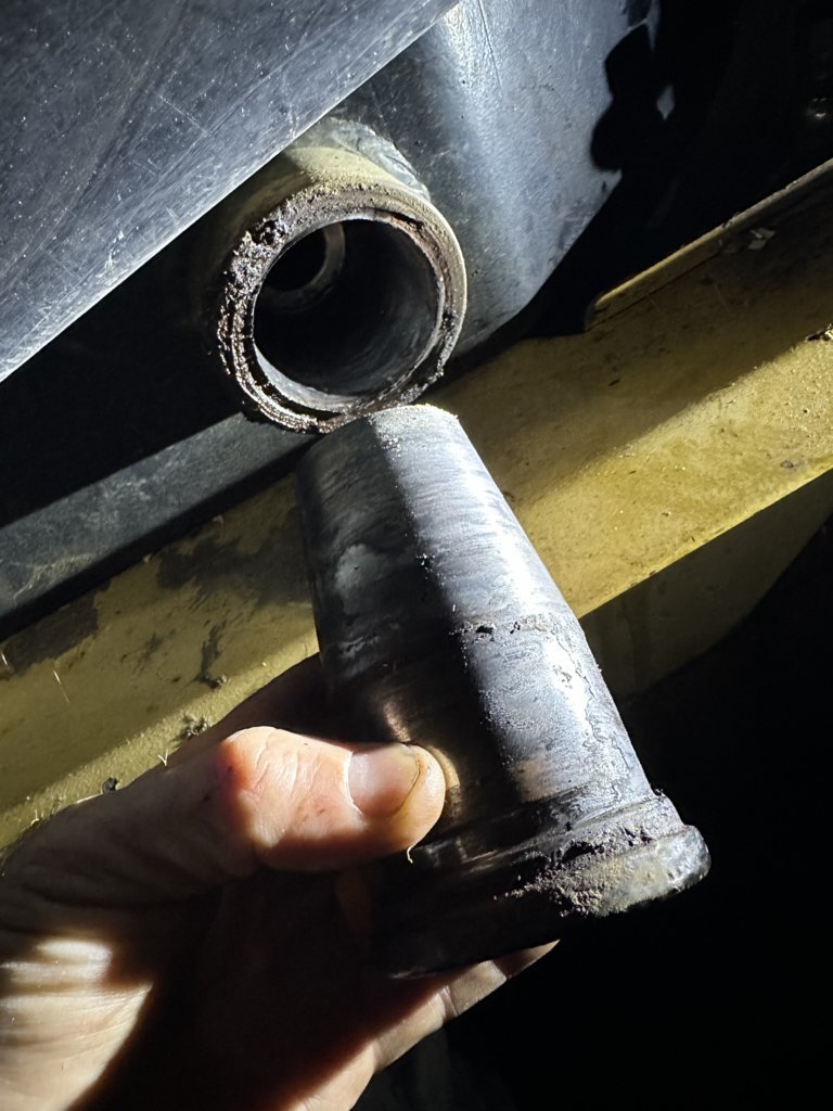

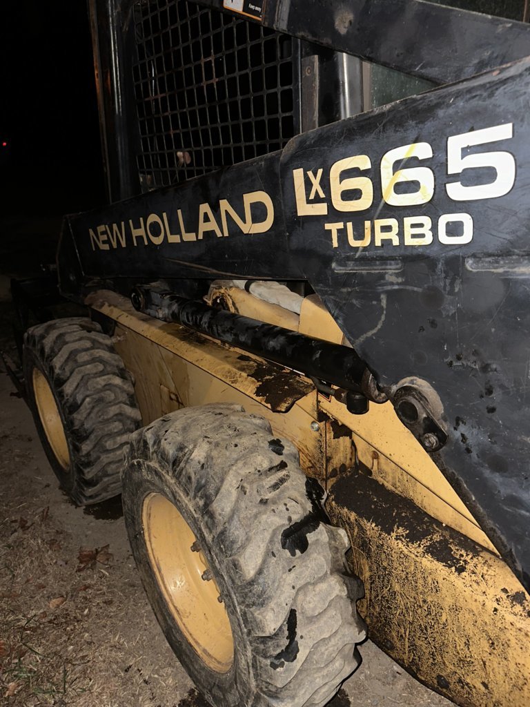

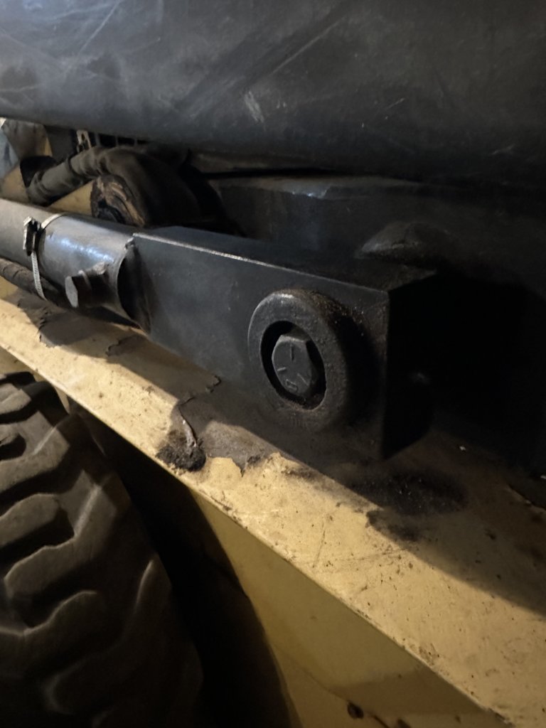

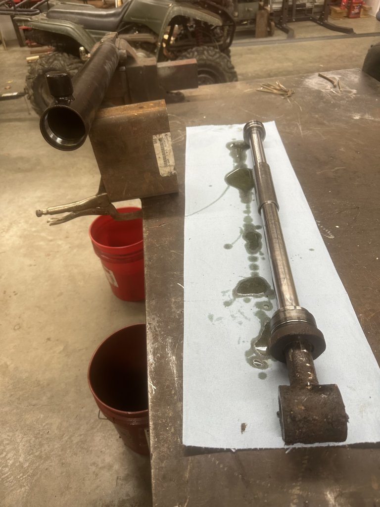

    Went out to the shop after supper and figured I’d get the leaky cylinder off and rebuild it another day.
    Take the bolt out and then you knock the tapered piece out it hinges on from the other side.
    Got it on the bench.
    Figured while I was greasy I may as well take it apart.

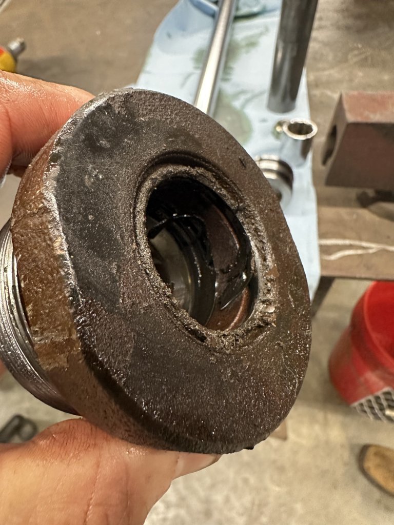

    Found the leaky culprit. Inside pressure seal was split.
    Figured while I had it apart and was already dirty I may as well rebuild it.
    Then, why not go ahead and put it back on since I was already dirty.
    Took me right at an hour from start to finish, and done it in crocs and didn’t get juice all over me.
