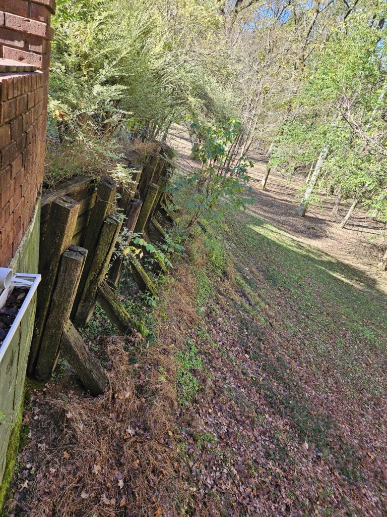

    So here is the crosstie wall that I want to turn back to hillside. Taper it down where it meets the cement block wall i'm standing on to take the pic and where it meets otherslope beyond wall. It ends at that last bush. It's already hillside beyond that bush. Wall itself isn't so tall I guess but feels tall because it is built part way up a hillbelow it. I'm thinking fill over whole thing to reduce slope overall plus get rid of wall.
    That is if I can afford to have that much fill dirt brought in.
    Wall isn't bulging or anything but some of the crossties are rotted almost all the way through letting dirt wash out through it in havy rains.

    The picture makes it look tall.... How long is it by how tall actually?
    This could be a bit of fill dirt or it could be 100's of tons. Just cant tell from your pix.
    Looks to be 8or 9 rail road ties high?

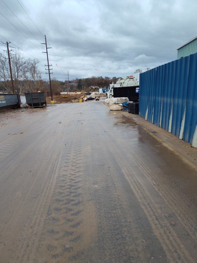

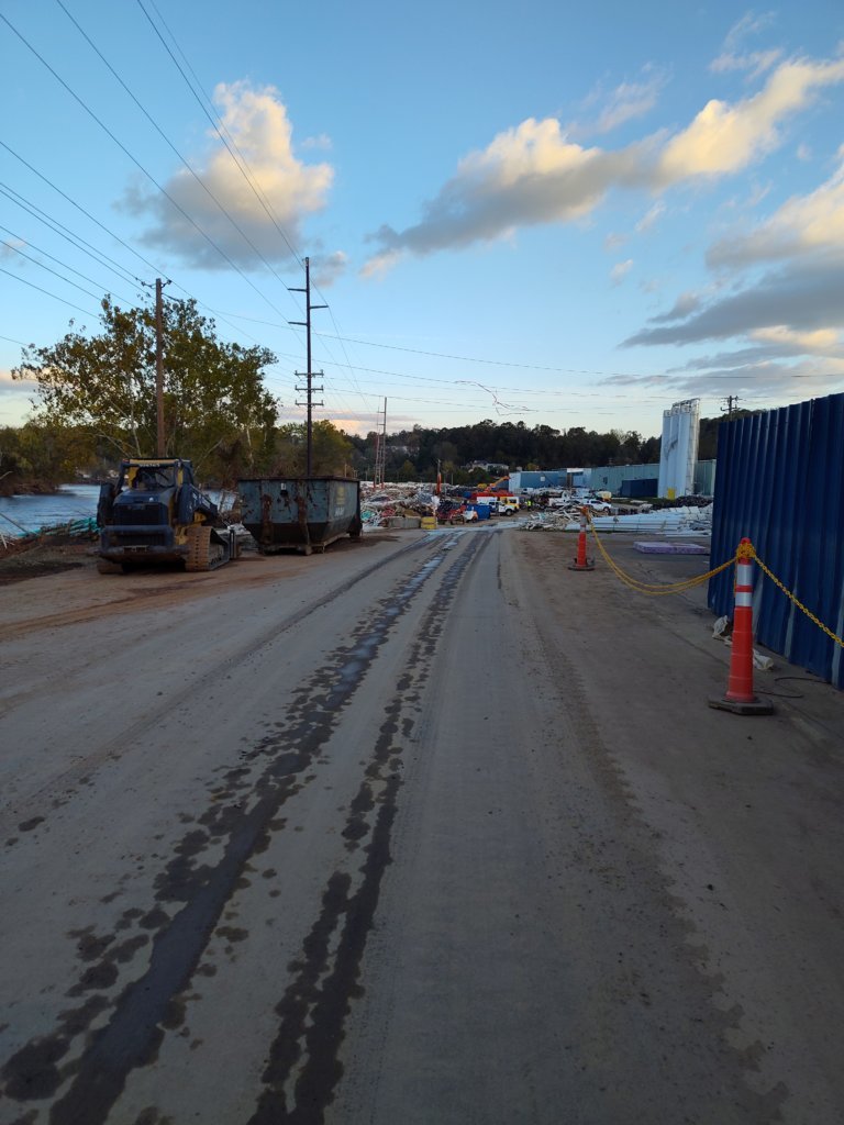

    Here's a look at the progress so far.
    This was taken the first day we were allowed back.
    And today
    It's a work in progress.
    We did 13 pipe bundles today on the pressure washing line.

    9 ties tall at tallest section, down to 4 ties where it tapers to blend into the other hillside. 6 ties long at longest at base.
    Hill below wall is equally tall by eyeballing it so base of wall is in middle of the overall height change. I'm guessing easily at least six dumptruck loads and I'd want a vibratory compactor along the way as hill gets built up.

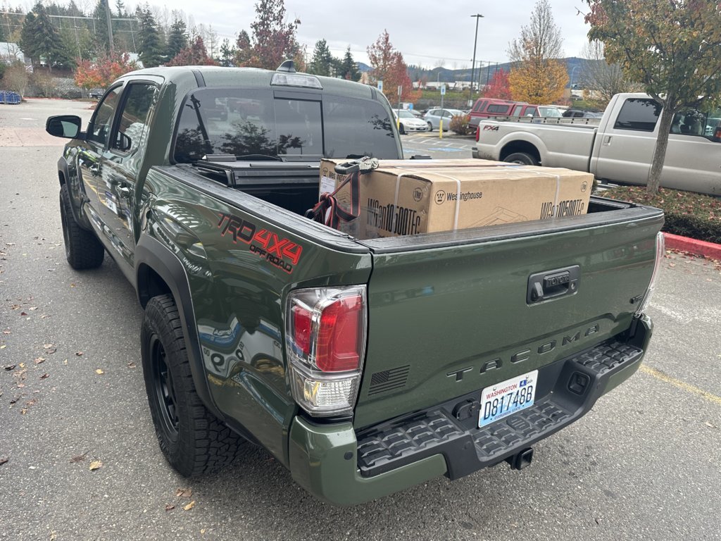

    Got me a new genny
    upload_2024-11-16_17-48-49.jpgupload_2024-11-16_17-49-0.jpgLike the fork stabs on the bottom of the box? Warehouse people are special. Especially if you give them a forklift….I did poke my fingers in there but the plastic wrap wasnt damaged so all was good.

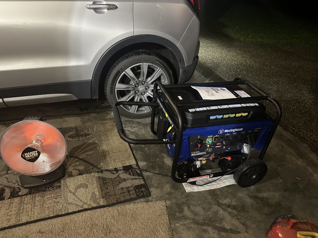

    Testing it for an hr. Started up and ran like a champ. Powered this little heater like it wasn’t even there
    Question for you guys in the know.
    It has a 50A outlet on it so would I be looking for a 50A transfer switch inlet and cable?

    Looks like it was stacked in truck or whse and was poked from the 1 in front of it when stacking or unstacking.
    You should see how all your appliances are done.:rofl:

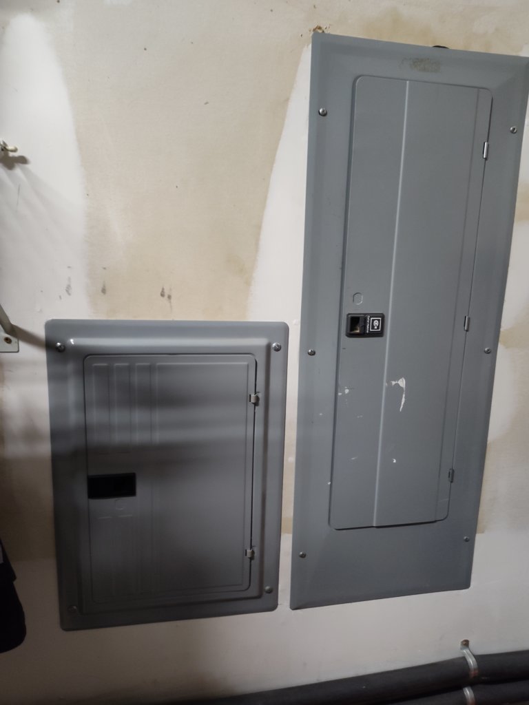

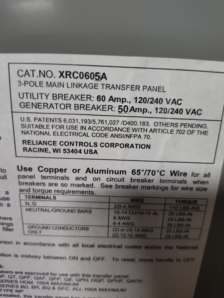

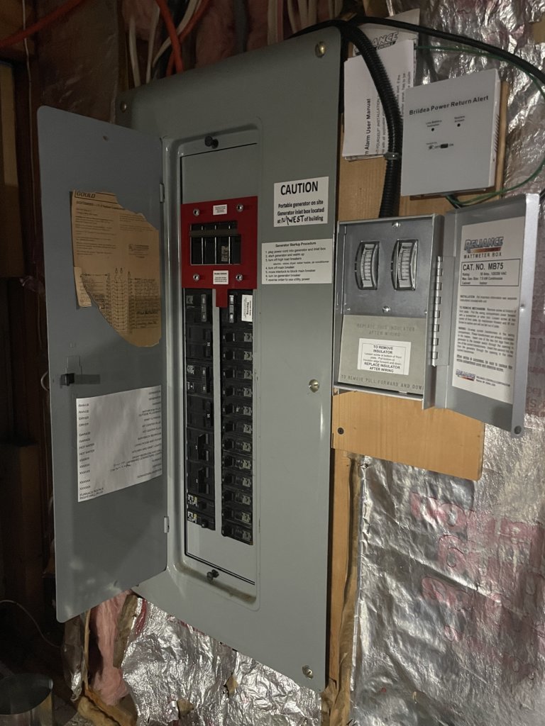

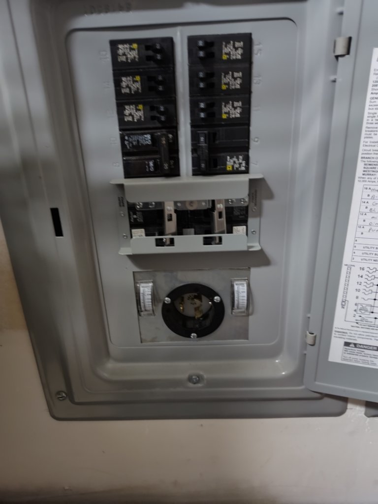

    Are you wanting to run certain things in your house at the same time? This is my setup.
    IMG_20241117_064251248.jpg IMG_20241117_064247109.jpg IMG_20241117_064304321.jpg IMG_20241117_064319762.jpg
    I don't have my oven or HVAC hooked up because of the consumption of fuel.
    Hot water is a rinnai tankless that runs off of 110 the only thing pulling 220 power is the well which is hooked up.

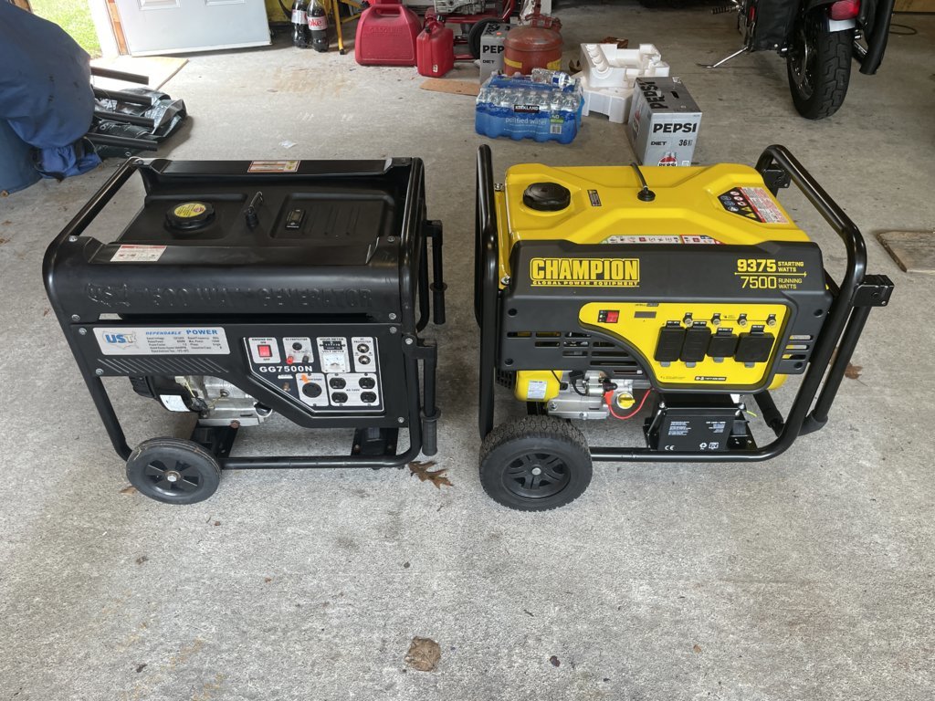

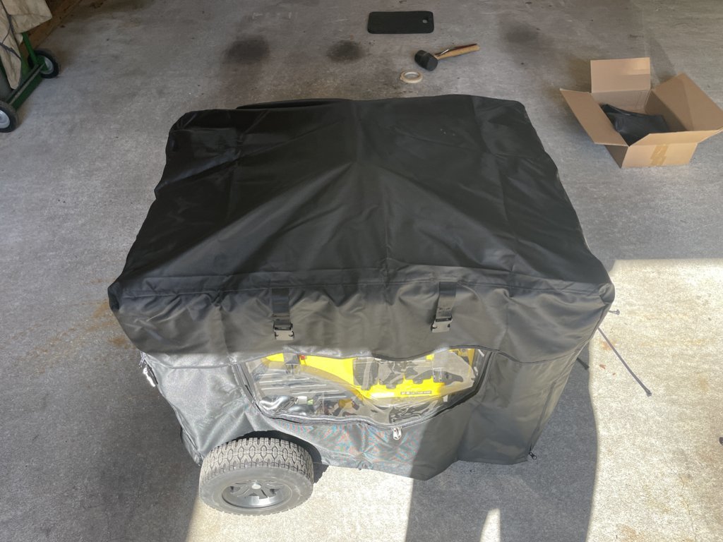

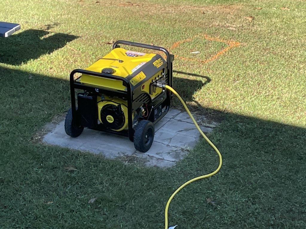

    Nice.
    I just bought a new one myself.
    I have every circuit available at anytime..
  12. Nov 17, 2024 at 8:04 AM
    Tacoma Mike
    Aug 6, 2011
    #61230
    31,464
    Southern Maine
    This Champion came with the ground Bonded.
    Needed to unhook it and turn unto a floating neutral.
    Made a bonding plug to run it standalone.
    Outside of that it was RTG.
    Have 2.5 hours of break in on it.
    Now to wait..lol
    I will run it once a month or so and roll it over with the recoil once a week.
    These style motors have an occasional issue of having the valves stick in the head if they sit for a long time.
