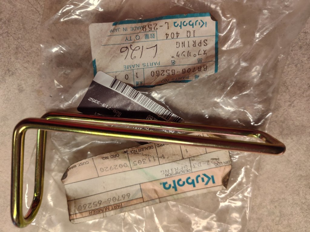

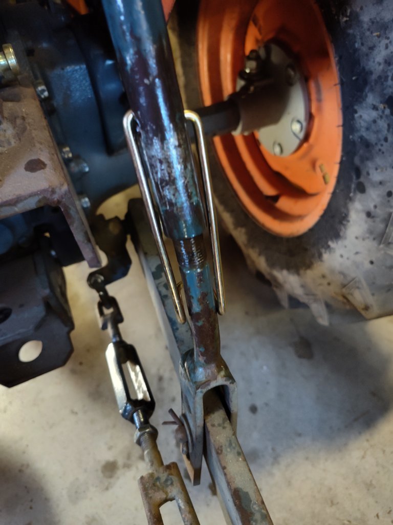

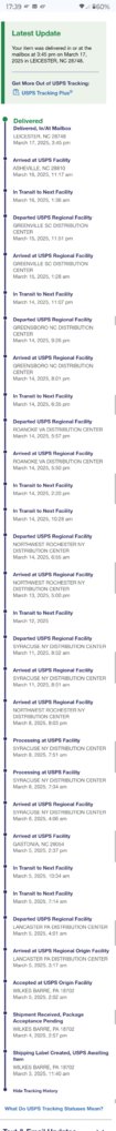

    Screenshot_20250317-173925.png 11 stops 14 days my part finally showed up today.IMG_20250317_170750783_HDR.jpg IMG_20250317_171013562_HDR.jpg IMG_20250317_171947208_HDR.jpg
    Now I can adjust the lift rod more easily. Less than 30 seconds install time.

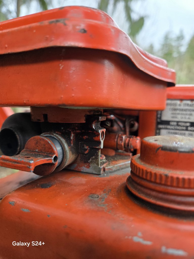

    Pour a tiny bit of gas in carb see if it tries to start
  12. Mar 17, 2025 at 4:30 PM
    wilcam47
    wilcam47 Keep on keeping on!
    Jan 27, 2016
    #176243
    55,259
    Will
    Bourbon state
    Or take off the filter and try to pull crank and seal your hand over the carb intake sometimes that suction force will pull gas through

    tried and no dice.

    tried that too. again, no dice.

    could i possibly have spark yet not enough to run? would be weird for electrical to go wonky in storage i imagine.

    Weak spark. Could pull plug and see if its sparking

    it is shocked me pretty good on a pull.

    Get some actual starting fluid. It has way more bite than gas. Sometimes it needs that initial Hail Mary to get going. If it gave you a good zap pulling it, you should have adequate spark. It's going to spark knock pretty good on the ether, but should be enough to see what it runs like.

    Hit the magneto and flywheel with some sandpaper and make sure all the gaskets are intact. Those older carbs if the intake is loose or any air getting in it’ll run like crap or never want to start. Does it even pop when pulled or no action at all from the motor? Also pull the plug out and see if you can scope the top of the piston.
