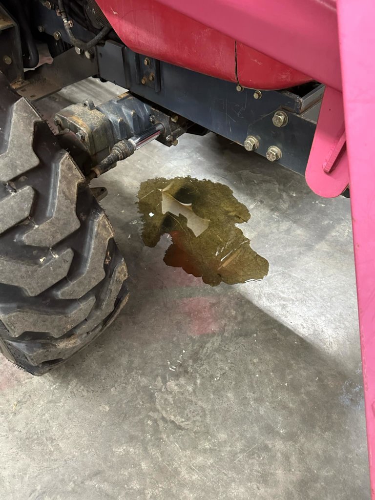

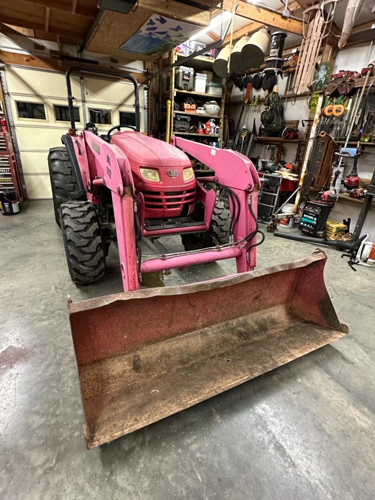

    My next project, guy said it had a leak in the axle housing. He wasn’t lying.

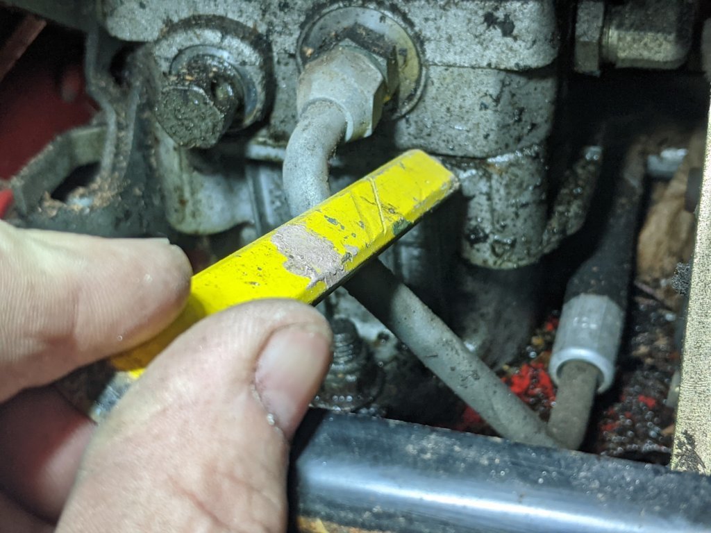

    Reserected from the dead.

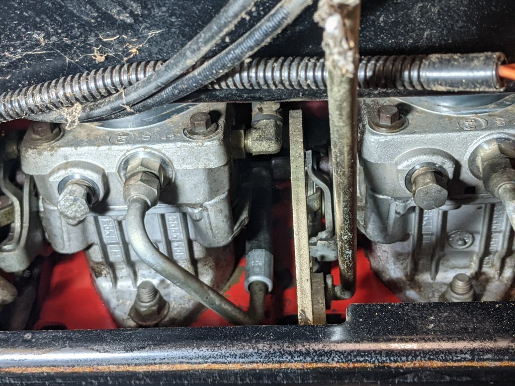

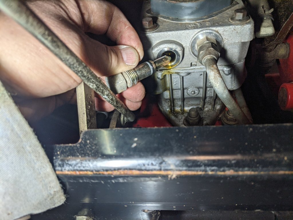

    Hunting down an oil leak on a commercial Exmark stand up zero turn.
    The funny thing about oil leaks, is a little oil goes a long way and makes a hella mess!
    I 1st thought the leak was the head gasket for the pumps.
    After degreasing the pumps and running the machine for 15 minutes on the bench, I was able to find that the bypass valves were leaking by. A little bit of petroleum resistant Teflon tape and the leaks are gone.

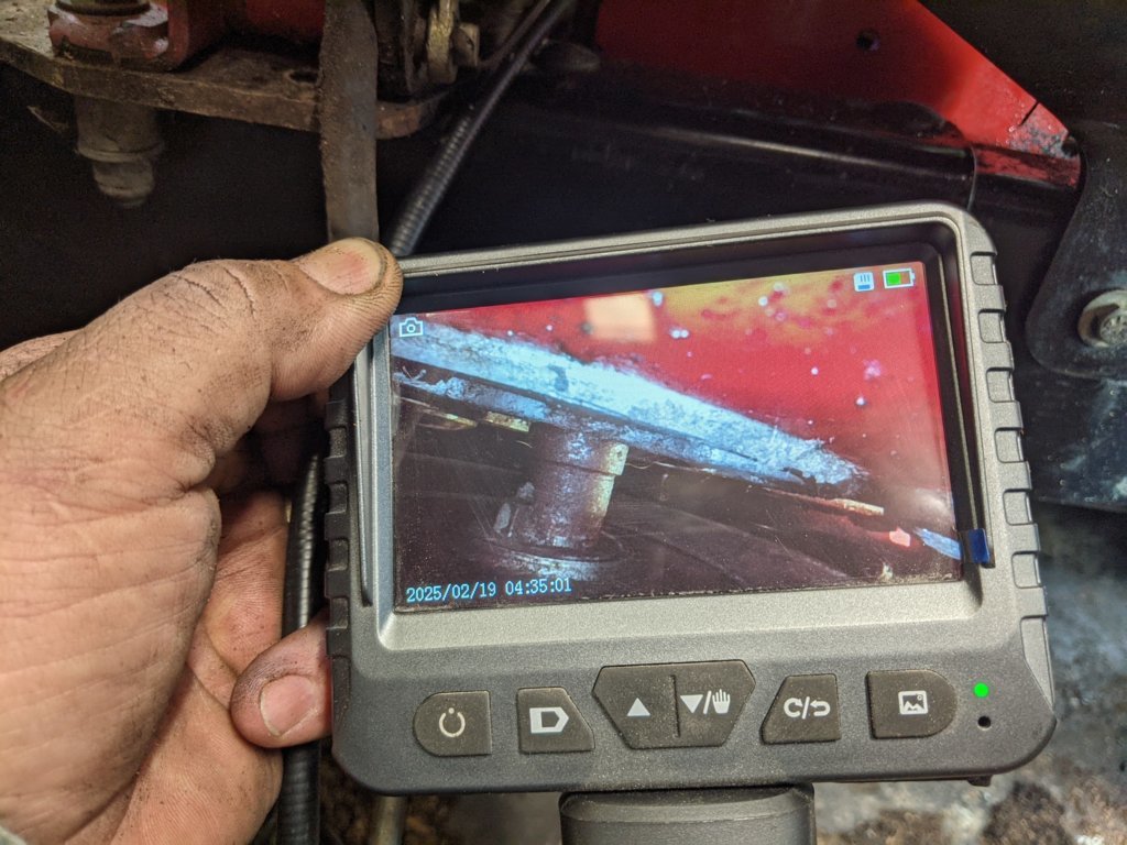

    Since these units are so compact, viewing areas that are prone to leaks is difficult.
    I wanted to check the input shaft seals on the pumps ( under the pump base). My bore scope was able to see that the seals were not leaking and I could cross that off the list.
    It's not difficult to rebuild these pumps, but it is a pain in the ass removing them and it's a hella messy job.

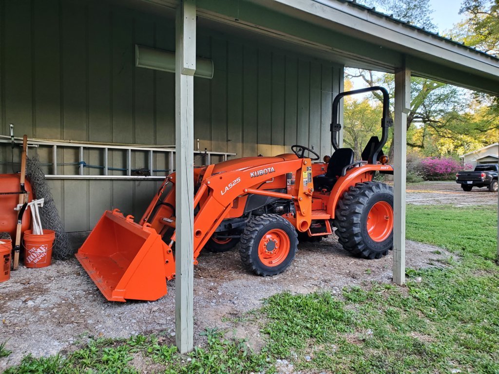

    My L3901 had hooks welded to the bucket when I bought it used in March of last year. I've used them with a chain several times to drag stuff.

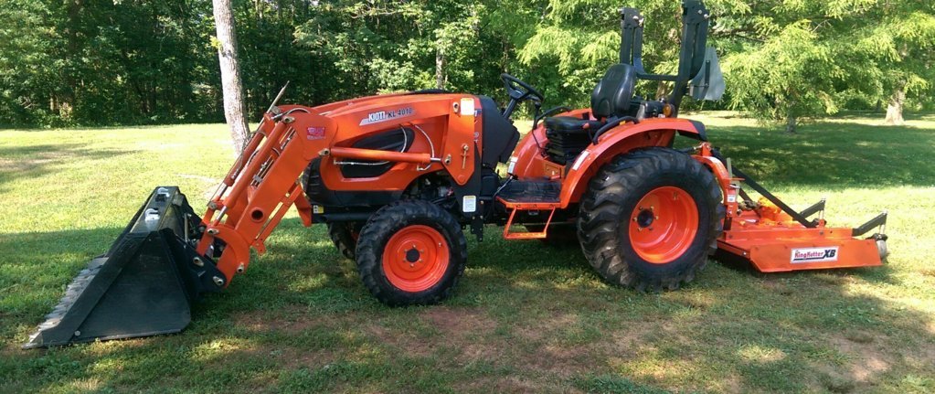

    03 Taco TRD
    Sure is & it's an absolute savage!
    For cleaing brush/trails it's hard to beat. It also makes it a lot easier if your running a bush hog... Haven't had the first briar tangle up.
    If you know the ground? You just set it at dirt level in float mode & don't even have to have a hog.
