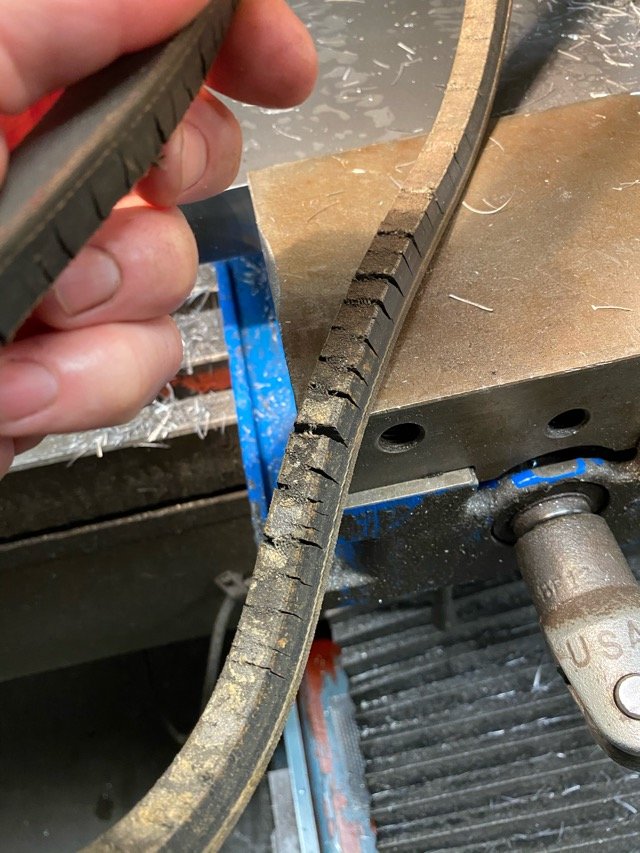

    Ordered a new fan belt. This one has been on a while.

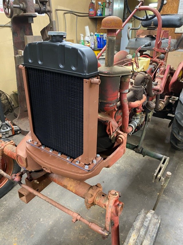

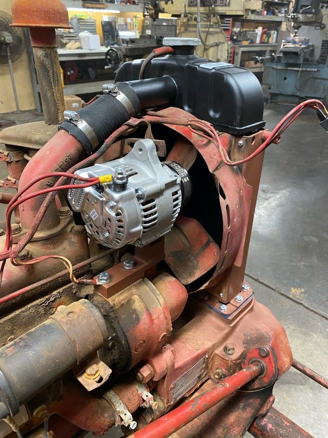

    New radiator came in and is on. Waiting on the belt and alternator now.

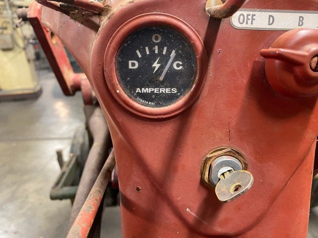

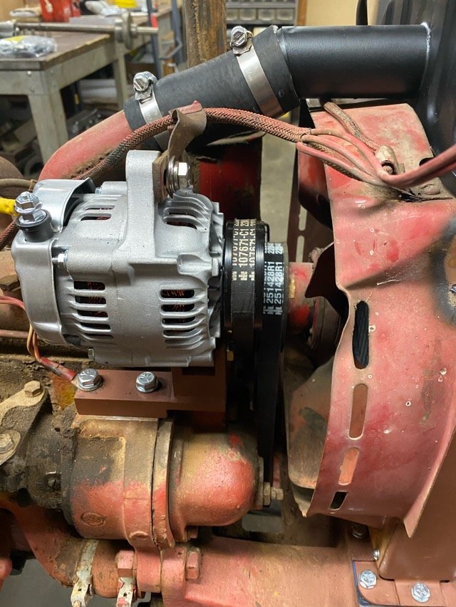

    Belt and alternator came in, it’s charging! These one wire alternators are nice for tractors that don’t have much draw on the electrical system.

    Had it already been converted to 12v, or are you doing one now?

    This one was 12V from the factory with a key start. I'm not sure when the Cub was changed from 6V with the pull rod on the starter to 12V. This Cub is a 1975.
    Both our 140's are 12V with the pull rod from the starter, one is a 1970, the other is a 1972.

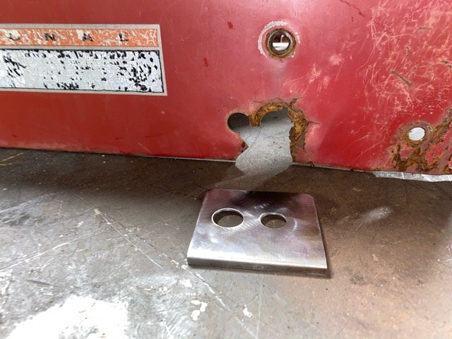

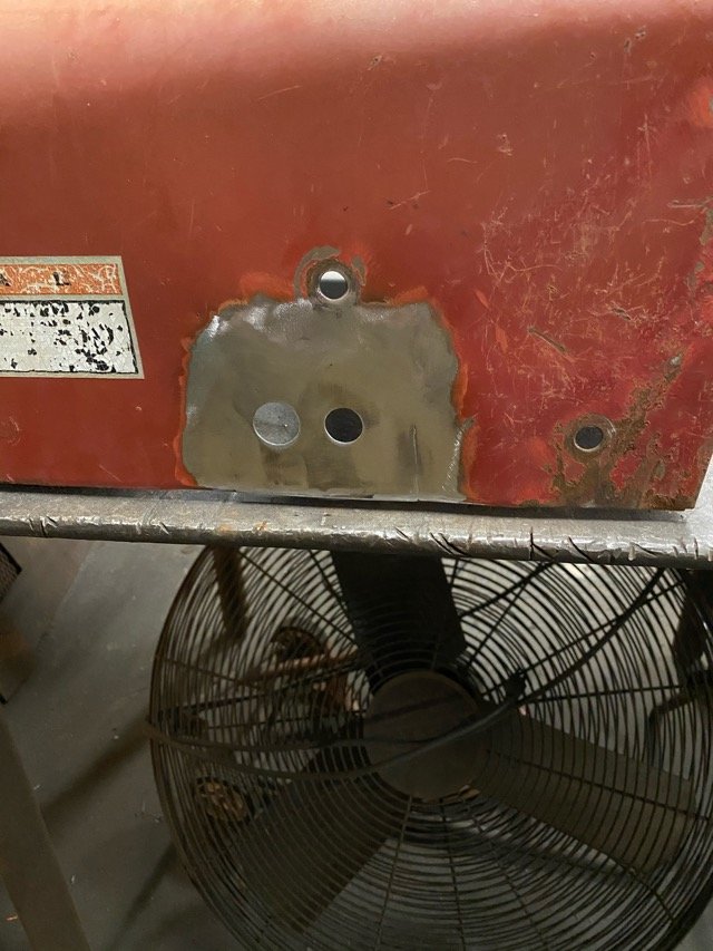

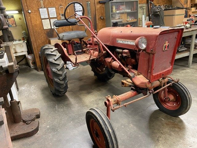

    Did a little sheet metal repair.

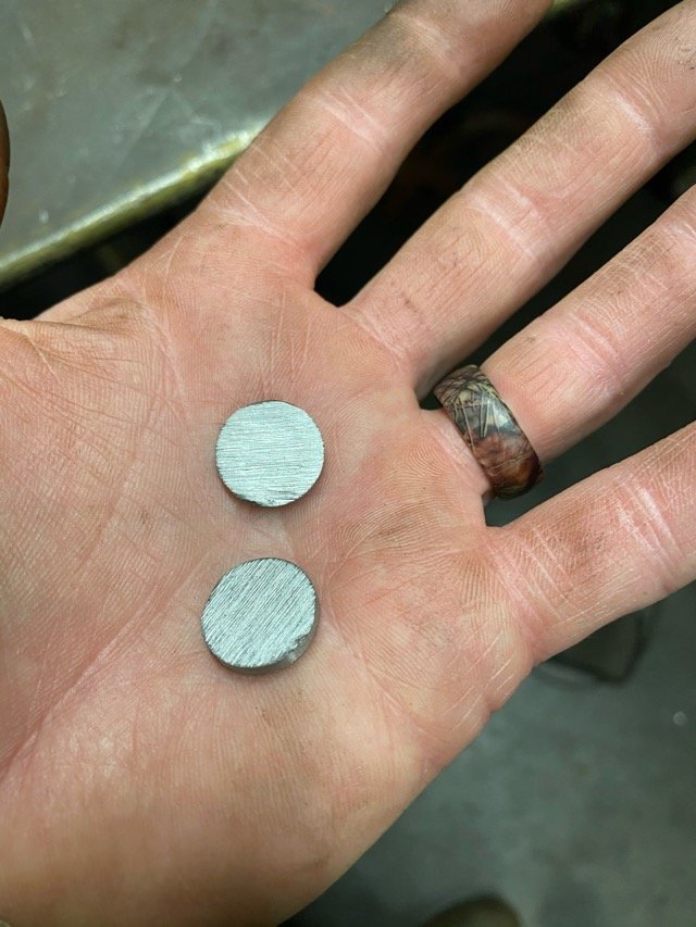

    A Cub has two holes in the hood except for one year (1955 I think). They are for oiling the generator. Since I put an alternator on it no since in having holes for water to get in.

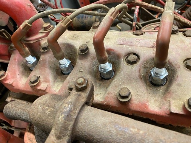

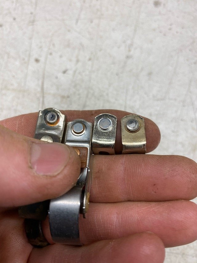

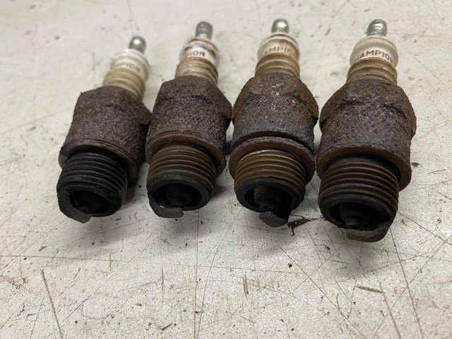

    New plugs and points as well. These plugs have been in for a while.

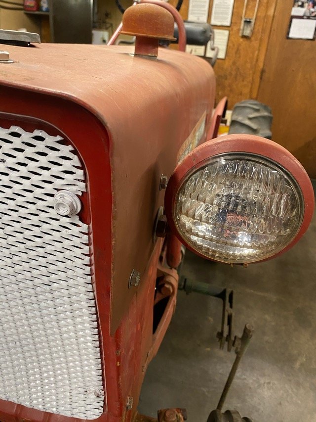

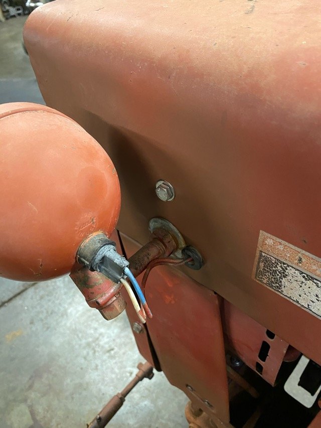

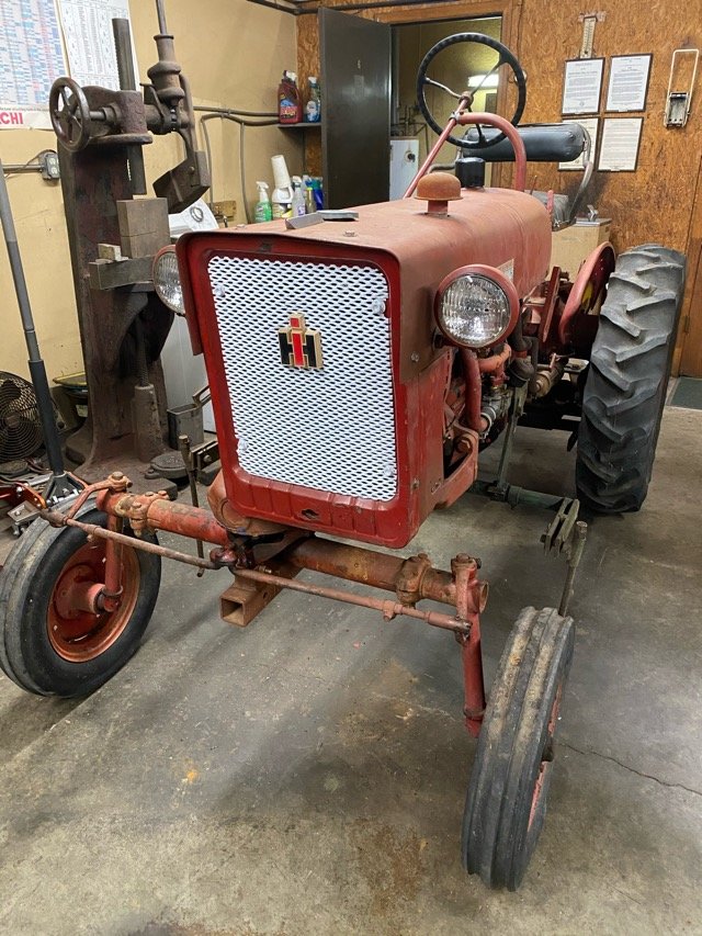

    Got the hood and grill back on. Grill screen looks better white. Headlights are tight now.
