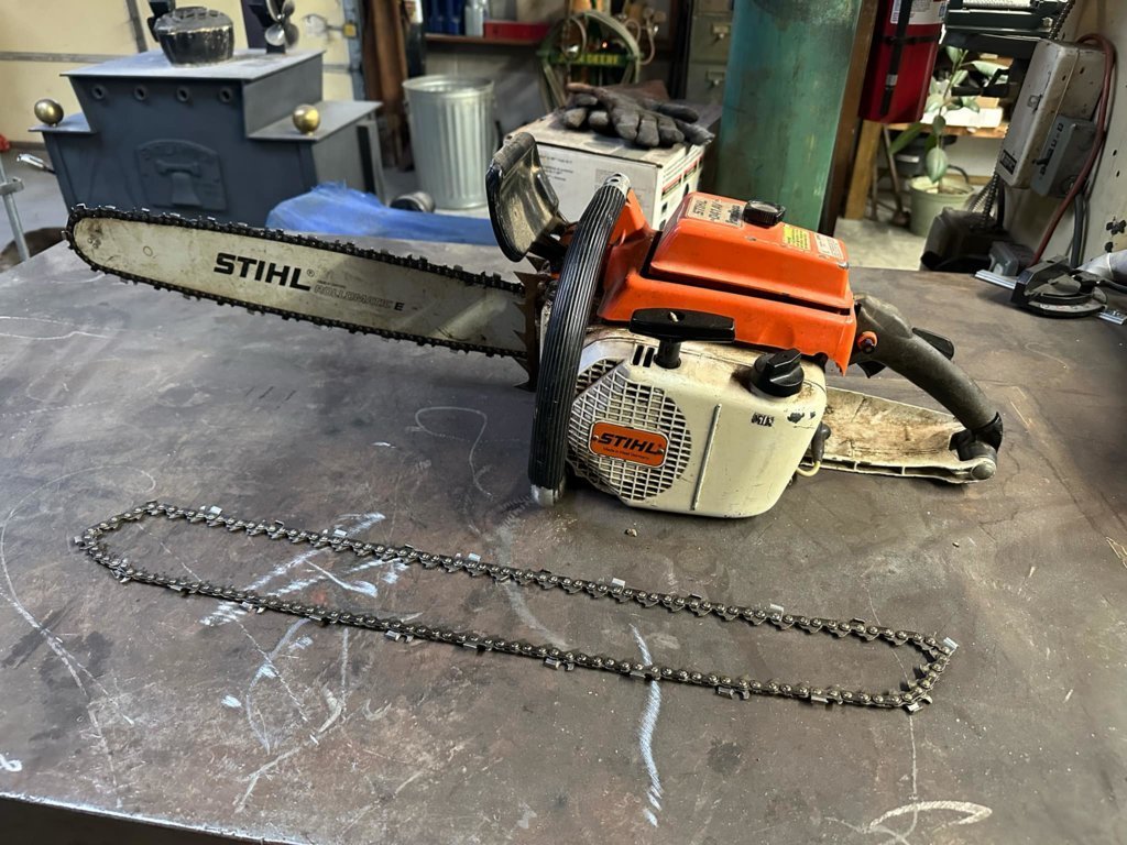

    Speaking of saws, a friend of mine gave me this one a few months ago, since he had a stroke he couldn't crank it. Runs great, so I thought.
    I took it to the woodpile Saturday and it won't rev high enough to cut. May need a simple adjustment or may be a shelf queen. We'll see.
  4. Apr 21, 2025 at 6:56 AM
    Delta09
    Delta09 Requires Supervision
    Apr 29, 2019
    #291677
    13,243
    Adam
    South Central PA
    2024 SR5 DCSB 4WD
    Could be carboned up? Some of those old timers (no offense to anybody here) loved to put extra oil in the gas over what it required.
  5. Apr 21, 2025 at 6:58 AM
    six5crèéd
    six5crèéd [OP] Be the light
    Jul 9, 2019
    #298734
    35,954
    Southern Virginia
    8 lugs no plugs
    May be, I don't want to spend any money on it cause I'm cheap and have more saws than one person needs but I will tinker with it and see if I can get it to run right. First thing will be to check to see if the exhaust screen has been removed.

    nice condition. 1967-1975 they made those. older than me.

    what that saw needs is you to send it to me... a nice loving home where it will be used & lovingly taken care of.
    thats a fine saw & probably needs very little to be back in top shape. but id for sure take that off your hands & save you the head ache.

    I don't think it needs a lot to get it running correctly, runs great just won't go wide open to sling chips like it should.
    I put it down and got the 036, it's the same size as far as CC's go but cuts circles around it.
    sdk1968[QUOTED] and Drainbung like this.

    Yeah that saw actually compares really well with a modern 290..... (Which I use)
    But the 041 should weigh less. They also make a 041 av PRO which has a little more displacement.
    That o36 you got is also a fine saw!

    I had an old chainsaw with the same symptoms. The gas line was cracked.

    That is a possibility, I'll check that as well.

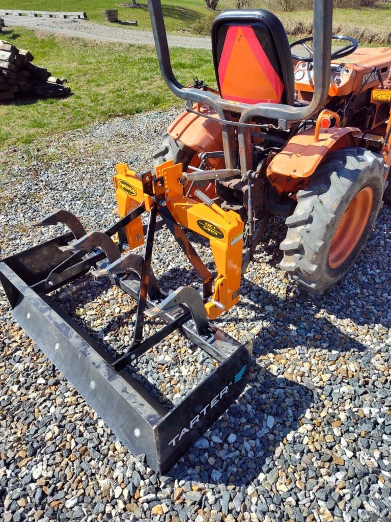

    I have already picked up my prizes in the form of the Speeco QCH and BB.
    IMG_20250322_114224114_HDR.jpg.
    I want to thank everyone for these beautiful prizes.
