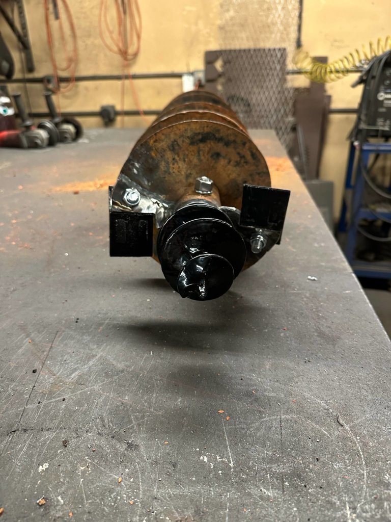

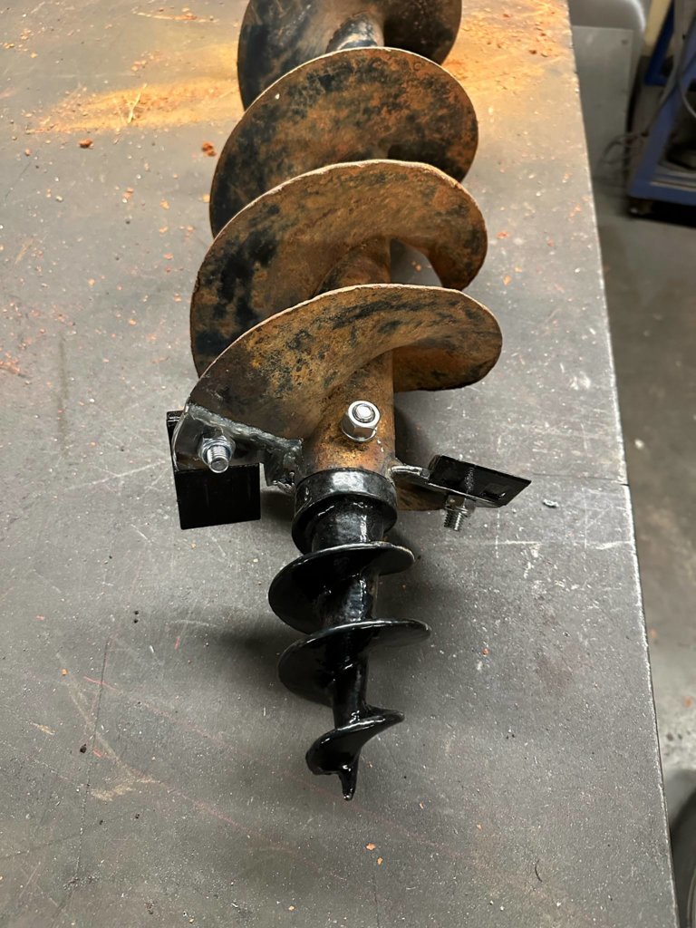

    Did you have to weld some fresh metal on there for the teeth to bolt too?

    Yes, cut the bent part off where the old ones were supposed to be.

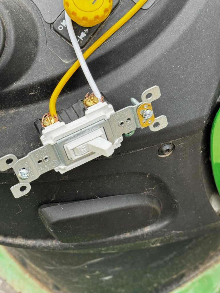

    Buddy of mine was having issues getting his JD rider started. I stopped over and did a quick diagnosis. Was able to start it jumping the post on the starter.
    Didn't have a meter, but guessing bad solenoid or key switch/ fuse.
    Takes 2 people to start it, since 1 person needs to be in the seat with brake pushed in and the other can jump the post on the starter.
    Got a text a couple hours later with a pic.
    " I can start it by myself"
    I did not get a pic of where those wires are landed, but I have a scary belief that this switch is used to jump the 8 gauge wire post on the starter!:eek:

    Just needs a face plate. Send it…

    Prolly cost 2 dollars. Well done sir

    ...as long as the face plate screws are indexed.
    We don't allow half assed repair work in this thread.
    Presentation is paramount!

    Only thing I would do different is put an outdoor box on it to protect it from the elements :rofl:

    If it works...it aint stupido_Oo_O

    12 volts can get scary, I always put the plastic caps on battery terminals when I carry or install one.
    Scary stuff!
    It's not the volts, It's the amps that do all the work/

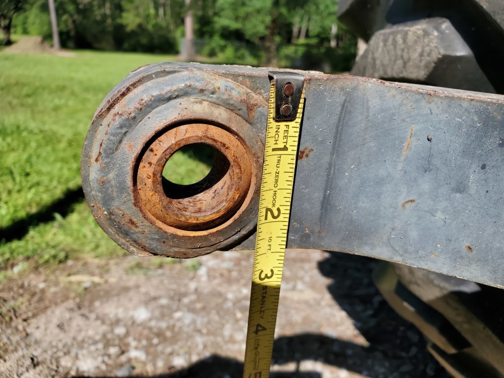

    I was also looking into exactly what I need to do to mount the QH to the tractor. None of the pictures/videos I found state the exact size, but I'm wondering about the pins that attach the lower part of the QH to the 3pt arms. In the pictures I found those pins don't appear to be a very large diameter. But the holes with the round "bushings" on my tractor arms are somewhat close to an inch. Am I missing something? Or will it all become apparent when the QH arrives?

    Yours look like CAT 1 size which is 7/8" pins. I'd guess that's what they are on your grinder as well.
    Here's a whole list of sizes from 0-4 https://www.hobbyfarms.com/from-0-to-4-defining-the-different-three-point-hitch-categories/

    Yes, the Kubota specs for L3901 say it's a Cat1 3pt hitch. The SpeeCo I have coming is for Cat1. I was just concerned that in the pictures I found, NONE looked like those pins that mount the QH to the 3pt were that large a diameter. In any case... UPS just got here as I was typing this response, so I'm about to find out . . . :fingerscrossed: :fingerscrossed: :hattip:
