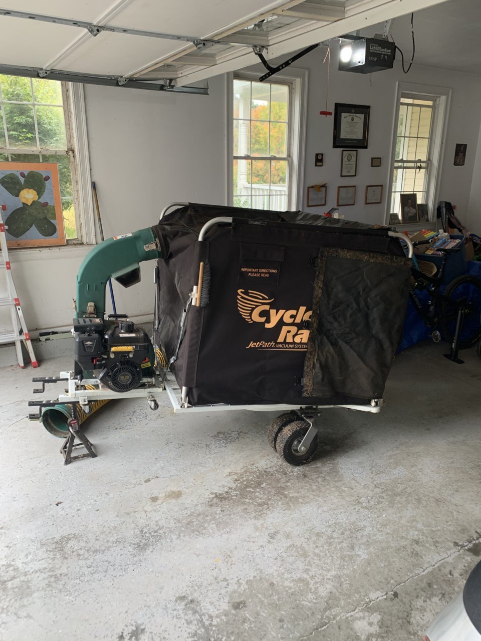

    Changed the oil in the vac. Bring on leaf season

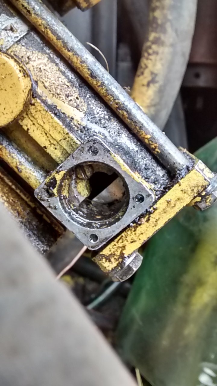

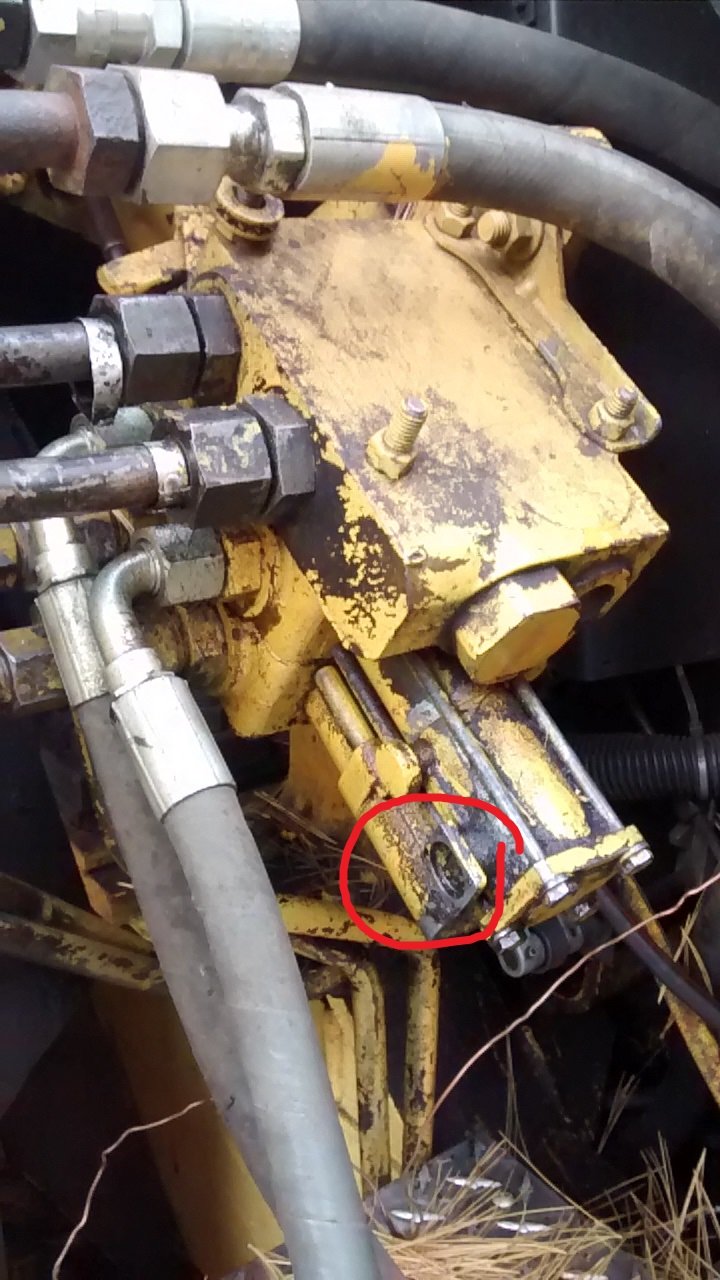

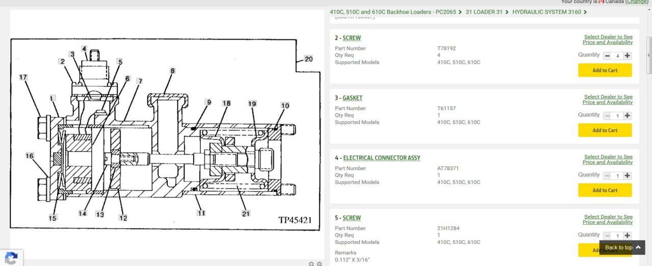

    My backhoe-loader is doing better with the shuddering hydraulics but it still does it.
    Works good at first, but as soon as you let go of the hydraulics and resume after a while, it is when it starts shuddering.
    Someone told me that shaking hydraulics is caused by two things:
    • low on hydraulic fluid (not my case, it is full)
    • air getting in somewhere in the hydraulic system
    Any places or lines in particular I should go check for air leaks?
    Oh and today I noticed that this piece on the loader control valve solenoid is missing.
    According to the parts catalog, this is some kind of electrical connector. Any idea what this connector does? And could it be related to the shaking hydraulics?

    What brand/model machine is this again?

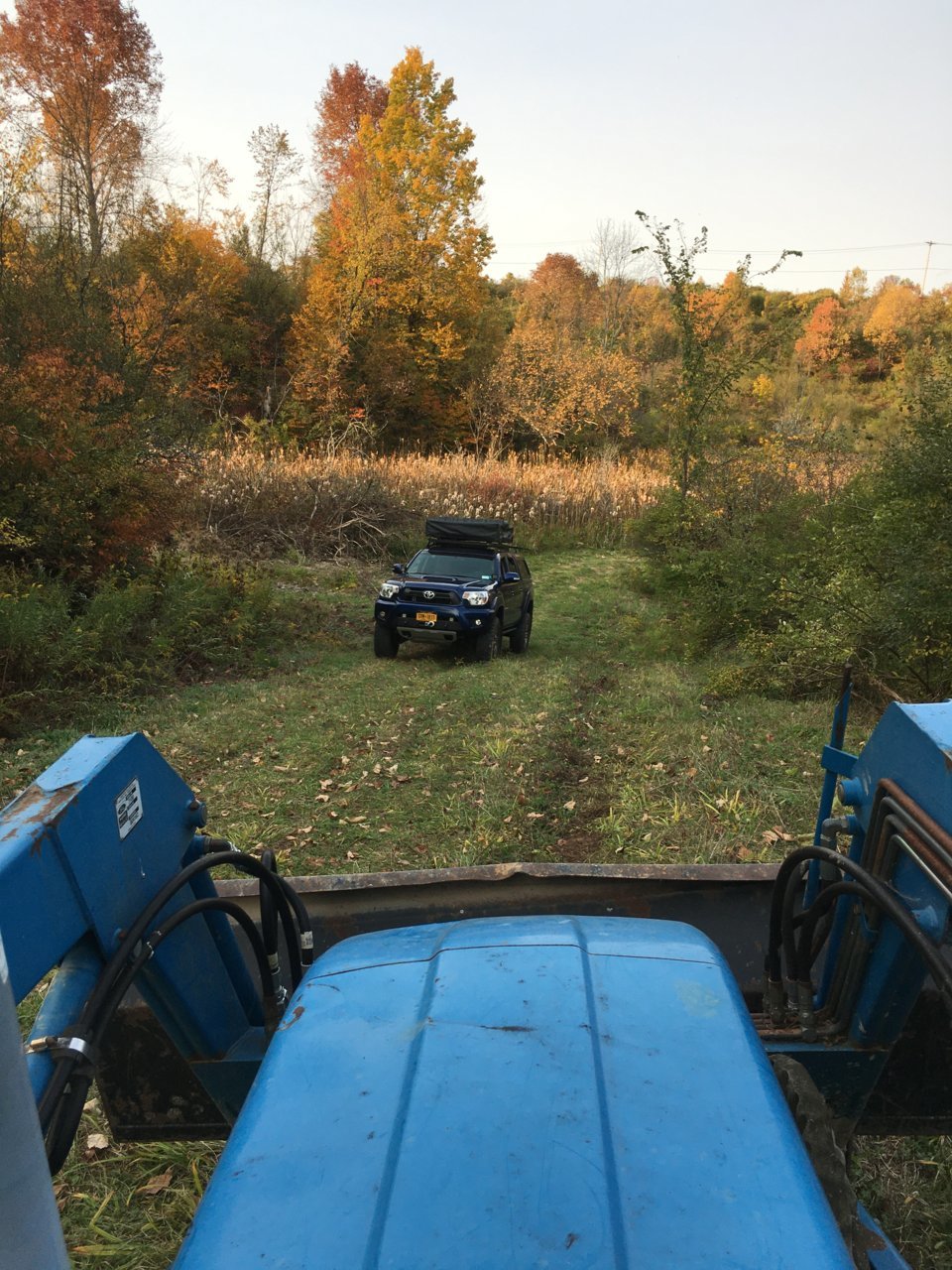

    2015 TRD Sport DCSB MT
    Finally got the freshly painted wheels and new front tires on, now to catch up on the brush hogging.105E39EE-B9AC-493D-80B8-1B8DCA6C0BD7.jpgB8A42A09-78BA-405C-97E8-105E87CEFB4F.jpg

    He said "dumb question but did you check the hydraulic filter?". Have you replaced it if it has one or cleaned it if it's a screen type?

    Yeah, filters are brand new and the priority valve and the transmission mesh filter screens are clean. Could the hydraulic pump have a filter screen as well?

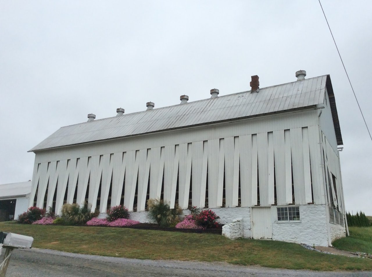

    While doing some research I came across this photo of 'field workers' doing what I did as a 10 YO child for a few summers on a farm in Lancaster Cty., PA (Alis Chalmers tractor post) - hoeing tobacco. This is in Connecticut under the shade, ergo shade grown tobacco which is used primarily for the outer wrapper on cigars. We never had any shade in the tobacky fields of Pennsylvania!
    six5crèéd[OP] likes this.
  18. Sep 29, 2020 at 1:05 PM
    #1638
    MikeyD.25
    MikeyD.25 Well-Known Member
    Jun 16, 2016
    #189776
    1,296
    We would spear the freshly cut tobacco then load them onto trailers.
    Next step would be climbing in the rafters (I was too young/small for that) to hang the tobacco so it could dry out.
    And finally, if you ever drive by a barn that has the sides open like in the photo above they are allowing air to circulate inside
    to dry out the tobacco before it goes to the 'stripping room' (usually beneath the barn) to prepare for transport and sale. I never saw the tobacco stripped - maybe it was X-rated? :notsure:

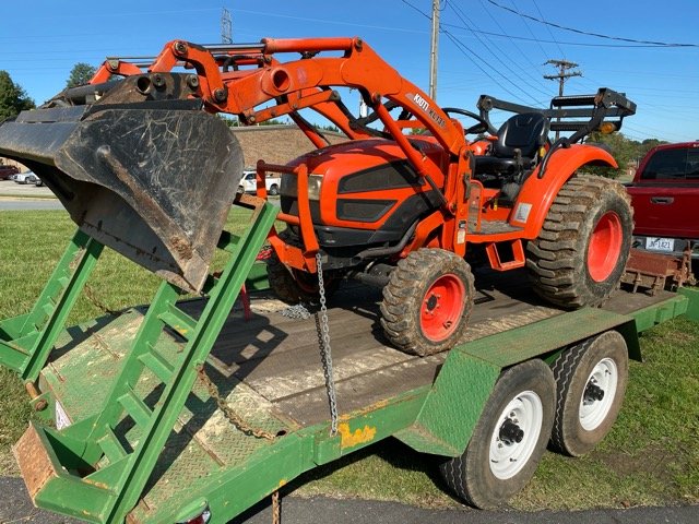

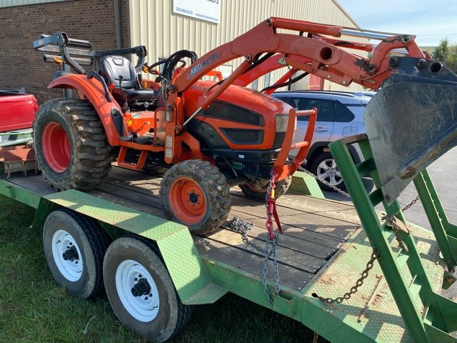

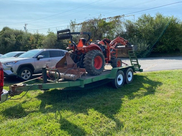

    Last year my buddy was wanting a tractor with a loader. I sent him a link to this one on the local classifieds. It came with a backhoe as well. It was less than 5 miles from his house and he didn’t have a trailer at the time. He decided to drive it home. Halfway there the front end locked up because it was dry. He didn’t know, it cost him close to $2K to fix it after having a rollback pick it up. It’s a nice little tractor though.
