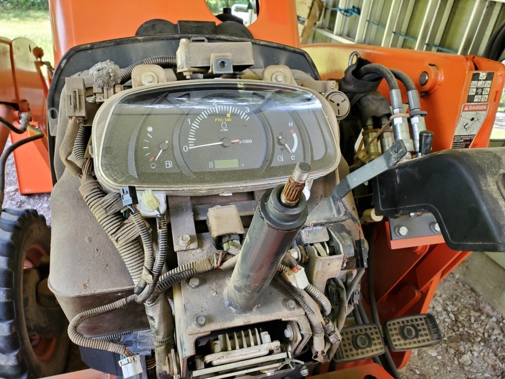

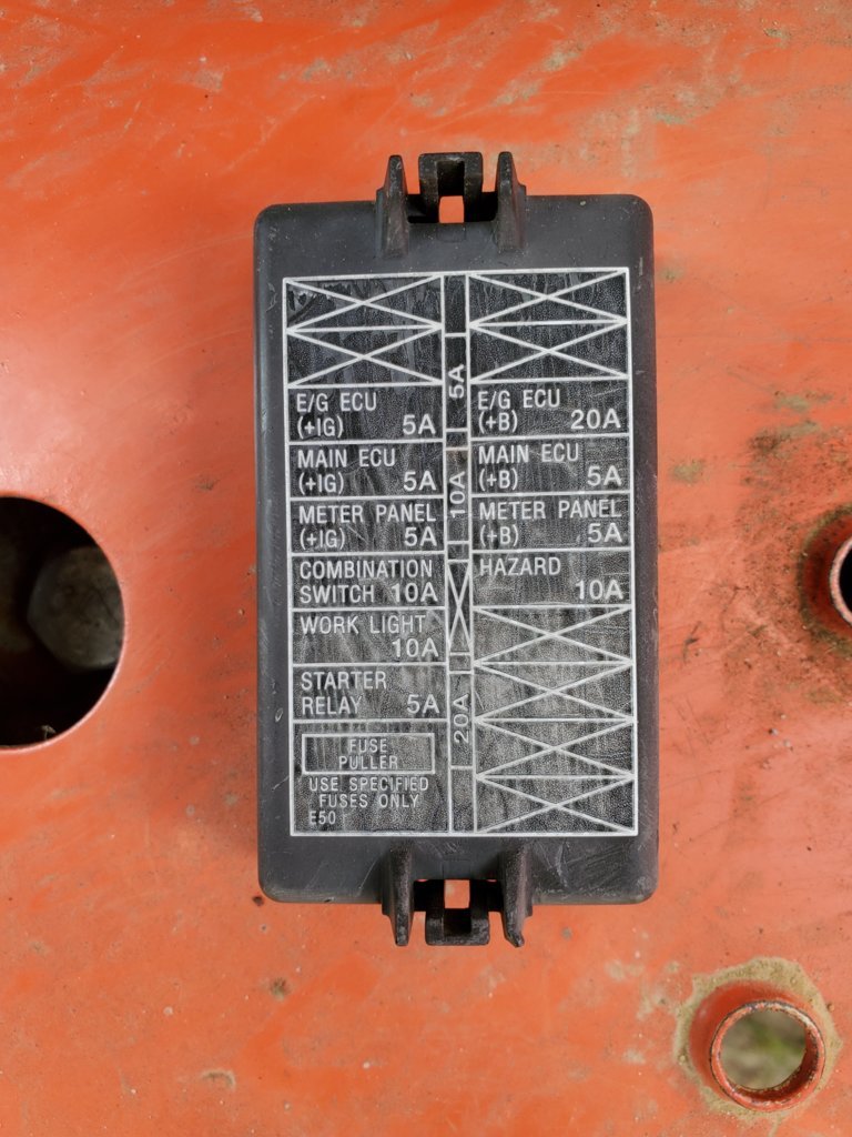

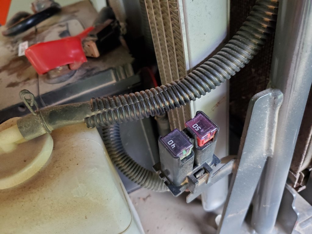

    Tractor died . . .
    So yesterday it was running fine. Moved some 5' logs around in the bucket during the day, used the grinder for about 90 minutes in the early evening on two 6" diameter stumps and a number of smaller "hedges" stumps (wild privet). Also took two passes on the wild cherry stump that I had ground previously, to get it a little below grade. Doing that the grinder did find an 18" piece of what may have been 1/4" rebar (if there is such a thing). All was still fine with the tractor up until I finished for the evening.
    Now this morning when I went out to raise the grinder so I could inspect the teeth... I turn the key and I hear the normal ?fuel pump? sound, the instruments come to life, but the nothing when I turn the key to crank. I figure dead battery, so I grabbed my Noco GB70 and hooked it up.. but still nothing. I cleaned the already clean & shiny battery terminals, and checked the 20 amp "E/G ECU" and the 5 amp "Starter Relay" fuses. I briefly tried to remove the 40 amp and 50 amp fuses located near the battery positive terminal, but I'm not familiar with how those snap into place.. they didn't want to come out easily.
    Everything else electrical seems to work. When I turn everything electrical on and then try the key to start, nothing dims at all.. it's like if I didn't even turn the key.
    Anybody know how those 2 fuses come out? Or have a good idea of what to look for first?

    Got a number of things tested, but haven't found the issue yet. Neutral Safety Switch checks out ok. Found all the secrets to removing the "Rear Bonnet" and was able to then check the Ignition Switch (Ok), and the Starter Relay (Ok). Just to be sure, I swapped the Engine Relay with the Starter Relay (since they are the same part) but no dice. Voltage at the Ignition Switch checks OK. Still need to check voltage at the Starter Relay socket, and check the PTO Safety Switch. If I eliminate those then I think I'm probably down to Bad Starter.
    I have learned some valuable lessons.. Always park the tractor where you would like to work on it before shutting it off. Like in the shop or under the branches of a cool tree with a breeze. Also probably a good idea to always remove the Loader (not just the bucket) so it's not in the way when you're working on it. And don't forget to remove any heavy attachments on the rear.. like a Stump Grinder. Is my frustration showing through yet??
