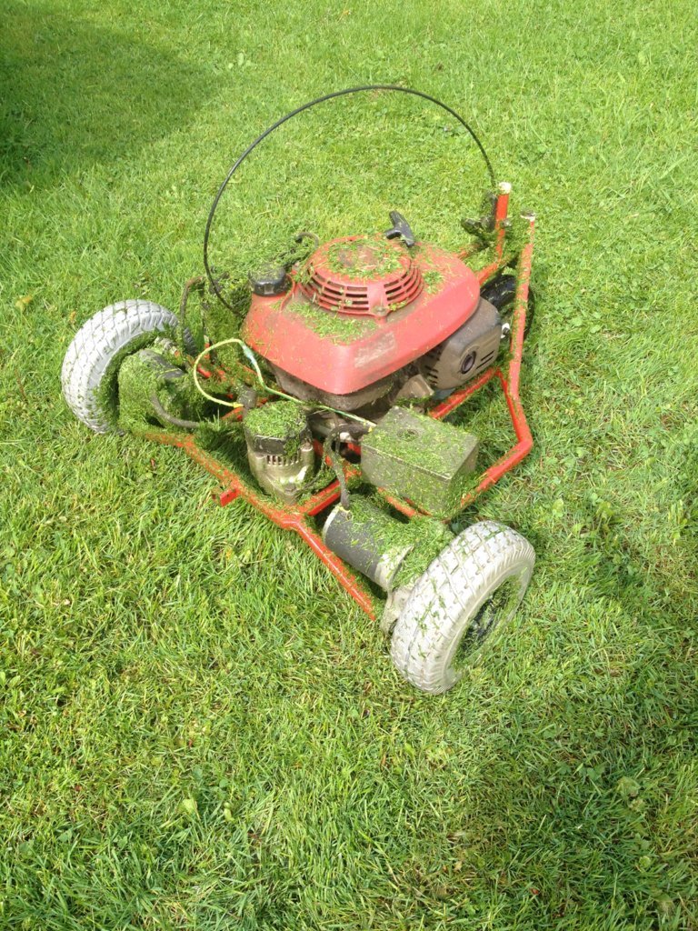

    Here's how I've mowed for the past 10 years.
    Built from a Honda mower. Uses a 1 wire alt to power the mobility scooter motors via battery. Uses a Dimension Engineering Sabertooth controller, setup for tank mode. R/C unit is a Futaba 3ch surface controller.
    Easily climbs 30° inclines.

    Tell us more!

    Not much else to tell.
    Oh...it really doesn't care how tall the weeds are....cause there are no guards.
    Just figured ya'll get a kick out of it.
