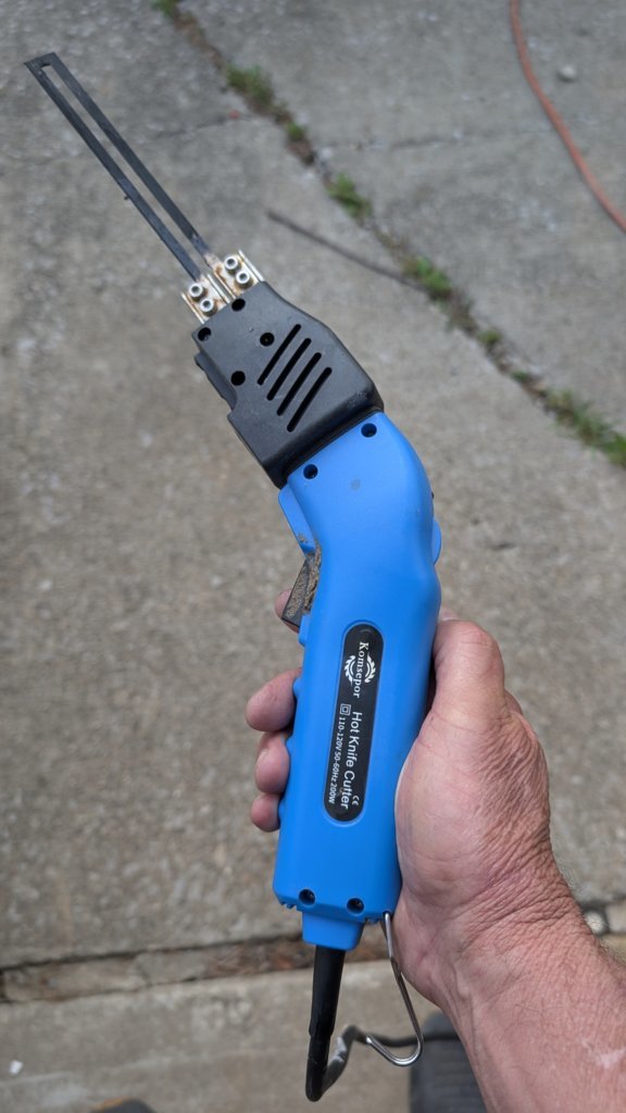

    It doesn't matter what it's going to look like after I cut it because it's going to be covered. I haven't decided by what yet but the internet said use the foam so you limit the amount of the crack repair product you buy by filling in deep wide cracks. In some places I knew I had pulled the trigger too hard and that was too much foam, but my thinking for most of the job was this isn't enough and I'm going to have to reapply some, LOL.

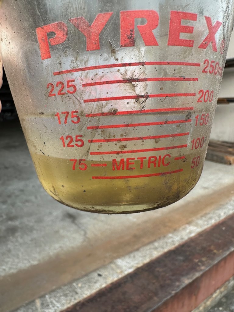

    Boss man ask me about his g/f's mower last week, said it would only run with the choke on. I said carb problem maybe. He ordered one and put it on this weekend and said it won't even start now so he brought it to the shop.
    I brought my compression tester, has 125 lbs. on both cylinders and I told him to get 2 new plugs since I had them out. I was going to switch the original carb back so I drained a little gas out into a glass jug. I ask him if this mower sits outside, he said yes. I said good, found your problem. The water has a little bit of gas in it :laugh:
    Drained about 2 gallons out of it, put the original carb back on, new plugs, runs great now.
    Hard to tell but the liquid is up to the 175 mark :facepalm:

    This tool to the rescue again. Some of the best tool money I've ever spent.
