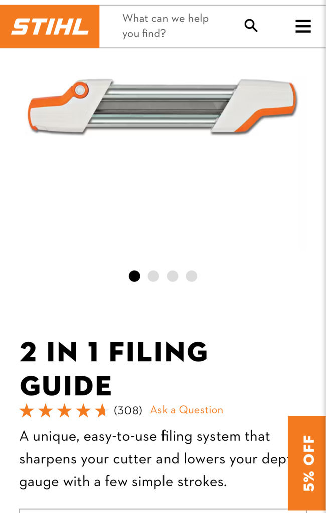

    Get a 2 in 1

    I endorse this file guide. Makes sharpening so simple.
    The rake file makes for an aggressive cut!

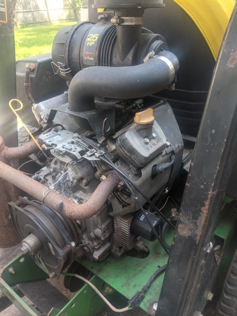

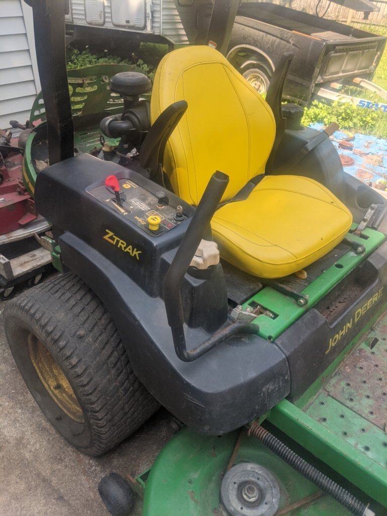

    Picked up this non running unit for cheap. Engine parts were in a basket.
    Found a bad valve guide that was pushed up. Straightened the push rods, pushed the valve guide to its correct position and reassembled.
    Spent $50 to find out that I better swap out engines. 4000 hors on a Kawasaki 721 is a lot of hours!
    I was able to run the thing enough to verify the hydrose are solid. The chassis feels very solid for that many hours. This unit has the digital hour meter, so it was nice to know someone didn't swap meters.
    After some thinking, I'm gonna do an engine swap.

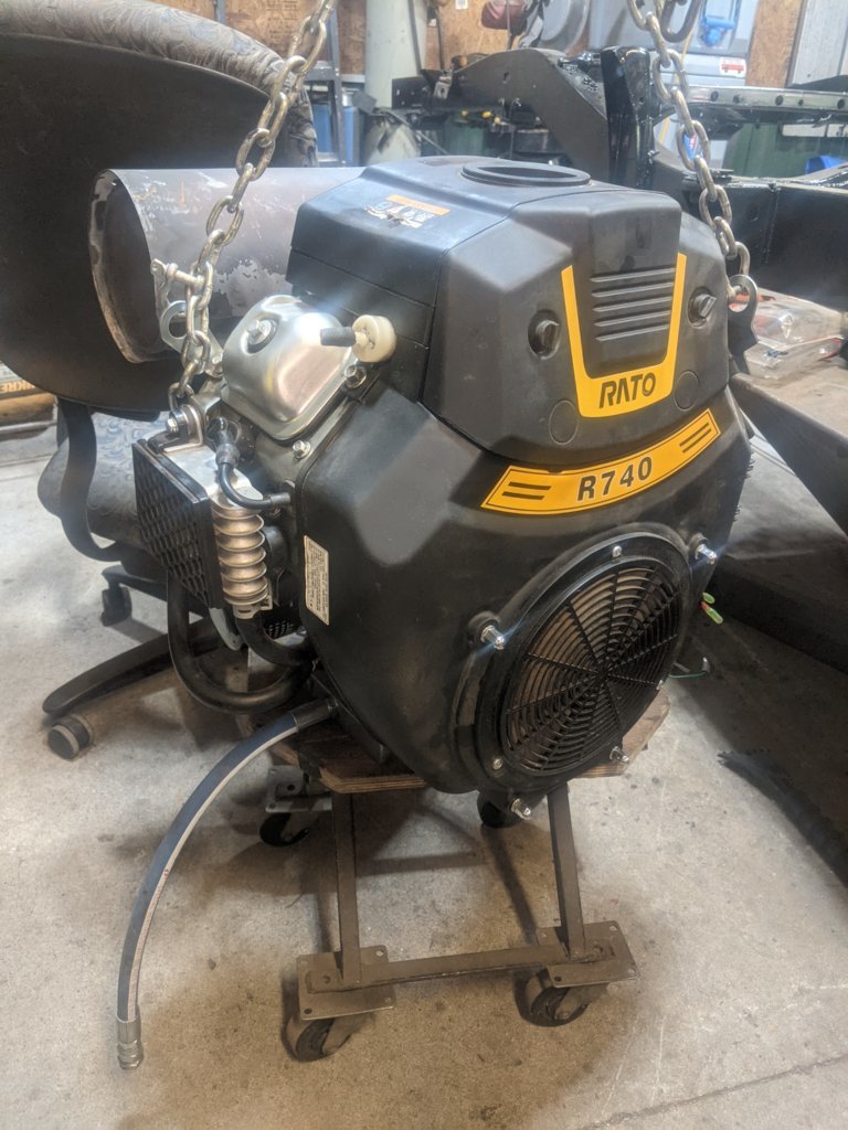

    Running the engine I was having issues with the RPMs ramping up even tho the engine was at idle speed. I'm assuming the ball bearing retainer ring for the governor has deteriorated. The unit starts amazingly, so it will be a great rebuilder for someone else. I can't sell this unit with a questionable engine. Out it comes and in goes a low hour RATO.
    This mower came with a vacuum/bagger system. I opted for a little more HP. The vacuum does pull quite a bit of parasitic draw.
