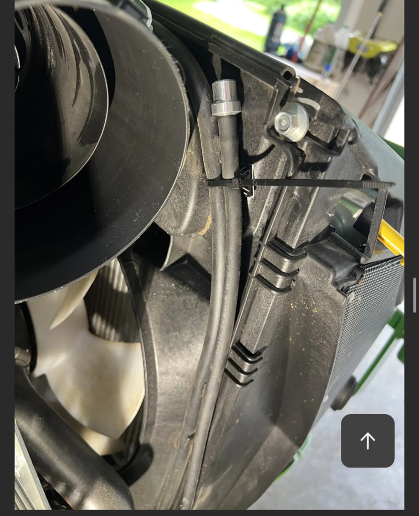

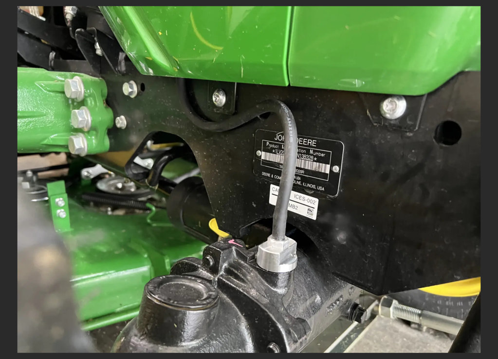

    I thought about putting mine up higher but I never cross any streams or get that axle in deep mud. It could easily be extended if desired. Longer hose.

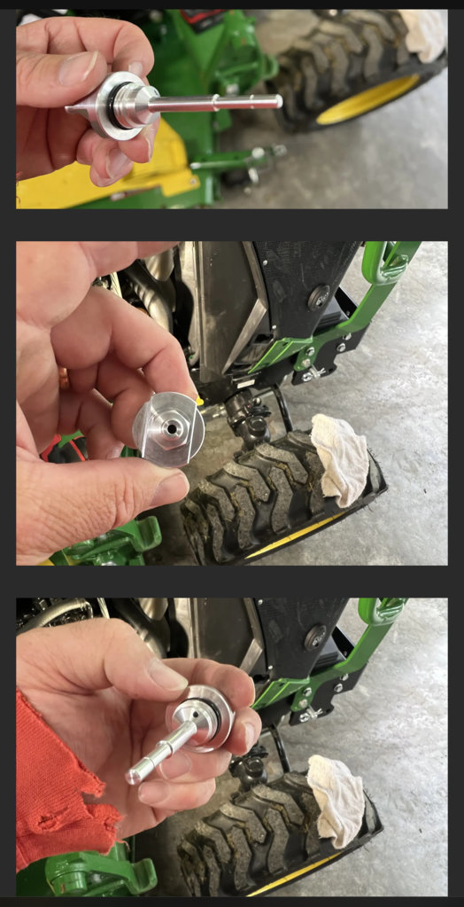

    I should add a lot of the guys that installed that Otis do snow removal and commented it keeps the slush and whatnot off the vent. Some made their own and complained they would get plugged by splash up or whatever so Jake made the kit with a longer hose. I do like yours and have seen some real good cheap ones and clever DIYs since mine and almost facepalmed for spending a hundo on it but it’s for support for a friend so I don’t mind.

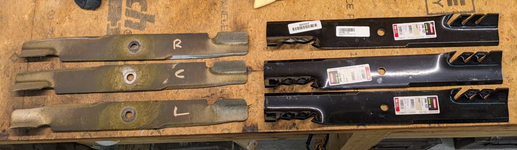

    BLADES on the other hand are a bit different. Here we go== (remember i have a very rough farm yard. NOT a flat or subdivision yard)
    set from facgtory was decent. got right at 100hrs out of them before they really started to leave shabby cuts. figured id just get another set of those & go another 100hrs.
    called my dealer, he said sure will send em to you. shipped em for about $15. they showed up this winter & i traded em out before cutting this spring. look identical, part number the same.
    uh & thats where it went to sh*t. the pic below is right at 15hrs on these blades!! Thats literally 5 mows for me into the season. YIKES!!!
    as you can see these blades are just ate to pieces.
    Yes i hit stuff all the time.
    Yes i mow too fast.
    Yes i mow wet.
    Yes its really that rough here.
    Yes they are marked L, R, C so you can see the wear difference from leading side to discharge.
    messaged KODitten about some Gators & he gave me some good info. Since power & blade speed are not a problem for this machine? went with the G6 heavier blades. will come back after i mow next time with "cut input".
    but just for reminders:
    factory blades= 2.5"w x 21"l x .200 thick "hardened w/carbide"
    the G6s'= 3"w x 21"l x .250 thick regular issue..
    gotta say that when you look at the pic its very easy to see the difference in these blades. These are actually a LOT closer to what i ran on the Hustler Hyper Drive for years.
    enough talk/type heres the pic.

    That sounds like my property. There were many horses here for (at least) decades, maybe for a hundred years. Ground is hard, has ruts from horse traffic, as well as roots and stumps. I changed the blades on my 61" Scag in April, at about 120 hours I think. The mower is 2 years old this month. I replaced with OEM blades the same as the mower came with. I'm interested to see how the Oregon hold up for you.
    The Scag OEM blades are 2-1/2" wide, 21" long, .203" thick

    I used to finish mow 5 acres of rough field at my property. My blades looked the same. I decided that I didn't love mowing that much and backed off to just 2 acres of finish mowing.
    The rest and more are now cut with the Swisher tow rotary cutter and I only mow the rough stuff with it every 4-8 weeks depending on growth. Saves time and no more beat up finish mower blades.

    This is the exact same blade for your Scag if you want the G6 vs teh G5..... You are correct mine were .203 thick as well.... my mistake.

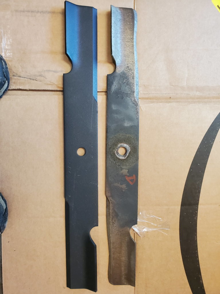

    This is the old LH blade that I took off the mower, alongside one of the new blades. The do look pretty much identical to your OEM blades. I hope the ones I put on in April last longer than 20 hours... I'm past 20 hours with them already.

    If you have dry sandy soil, blade wear is gonna be an issue. Hi-lift blades are the worst.

    Yep but $100 for the kit vs $16 DIY for the same result

    I was referring to the OE battery not front axle solution. I’ve got no dog in that fight. If someone wants to spend $100 for a pressure release valve then that’s their choice.
