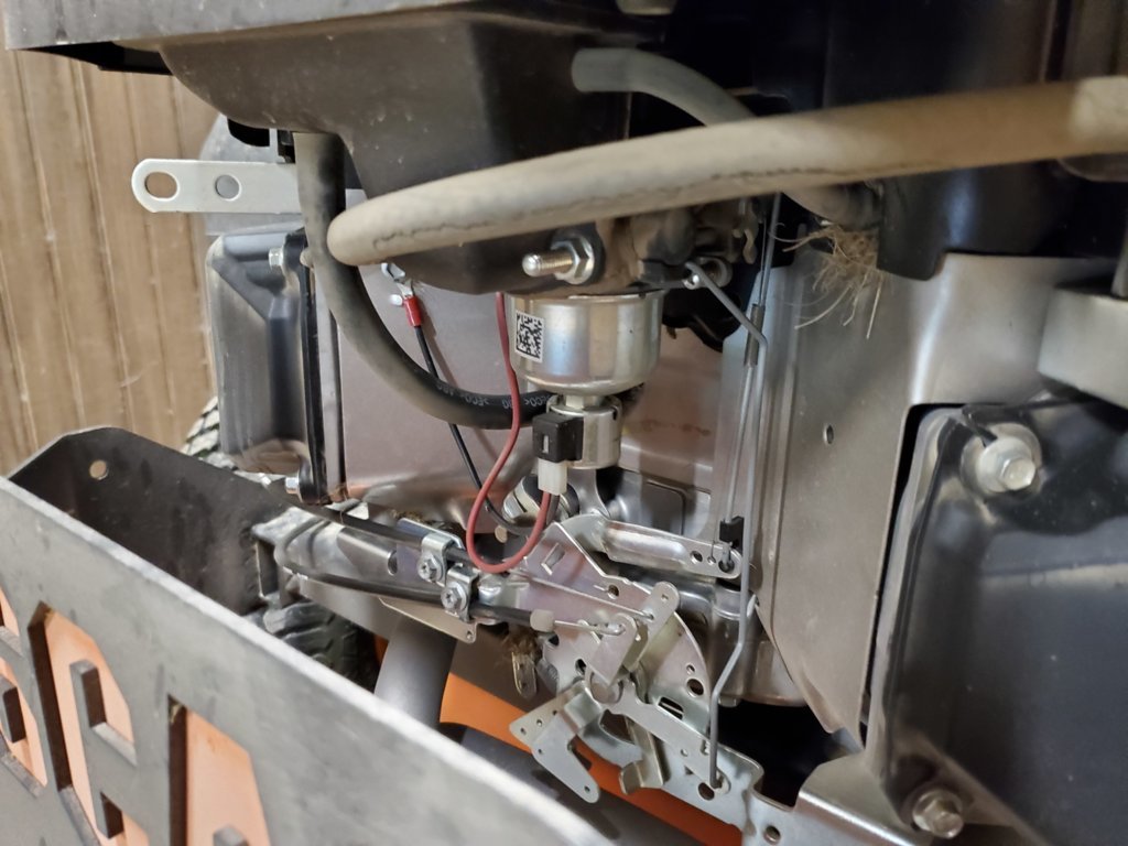

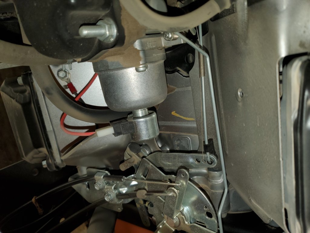

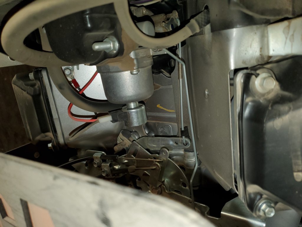

    Scag Liberty-Z 36" with a Kohler KT-715 engine. This mower is a bit over 3 years old, and has been having a "dieseling" issue on shutdown (when HOT) almost since it was new. The issue is getting progressively worse. My Scag Liberty-Z 61" has a near identical engine, but almost never does this. Searching the internet it seems that this is a rather common issue with the Kohler engines. People suggest shutting it off at full throttle (this seems to actually work sometimes) or to let it idle for a minute before shutting it off (I haven't tried that one). Many people say to replace the Fuel Shutoff Solenoid located at the carburetor.
    The replacement videos and instructions I've found all talk about removing the carburetor to accomplish the replacement. What am I missing here? It seems the solenoid screws in to the bottom of the bowl, where on many old carbs there was a drain plug. I am attaching 2 pics of my (troublesome) 36", and 1 pic of my 61" for further reference. Any reason that the solenoid shouldn't simply unscrew from the bottom of the bowl with the carb in place?? There seems to be plenty of vertical clearance for the solenoid to be removed from under the carb and the new one to be installed. Anyone have first-hand experience?

    There is no reason why you can't unscrew that fuel shut off solenoid. You will spill some fuel, so make sure the engine is cool and you finished your smoke. Lol.
    I'm sure the reason is liability issues. No one wants a lawsuit because you caught yourself on fire swapping out a solinoid.

    Also Kohler recommends shutting off their newer engines at half to full-throttle to prevent dieseling/aka afterfire. I do it on all of mine(3) and they do not diesel. It was hard to accept that this is the correct way but it I found this in Kohler's FAQs on their website awhile back. I just shut them off at FT and don't worry about it.

    When I get the new solenoid in my hands I guess I could shut off the fuel valve that's near the tank, then drive the mower over to the shop, from the stable where I keep it. Then I could let it run dry and give it time to cool off before swapping the part.
    Now I just need to try to find the part number.for the proper solenoid that fits..

    Here's the wording about it from Kohler:
    "How the Kohler carb works at shutdown. the fuel solenoid on the Kohler shuts off the main jet of the carb but not the low speed idle circuit. when at idle the engine can pull fuel from the low speed jet when shut off causing the afterfire. At the high speed position the governor opens the throttle when shut off because the engine is slowing down and tries to get fuel through the high speed jet which is blocked by the solenoid therefore no fuel can get through to the muffler to cause the afterfire."

    Yeah, I found similar info. The funny thing is my two Scags have almost identical engines, but the 36" wants to keep running whereas the 61" shuts down like a normal engine. o_O

    Those solinoids are pretty universal. Punch in your engine model number and engine code on an Amazon search bar and many will pop up.
    Both your machines use the same solinoids. Have you considered switching them to see if the issue fallows the part?

    The orientation of the connector is different, but they may well be the same part number. I did think of maybe swapping them (if I didn't have to remove the carbs), but the non-OEM part seems to be cheap enough, so I don't really want to risk anything with my perfectly running 61" mower... :fingerscrossed:
