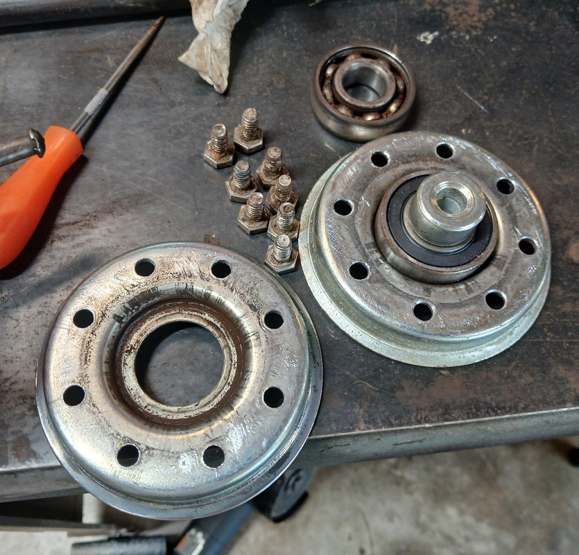

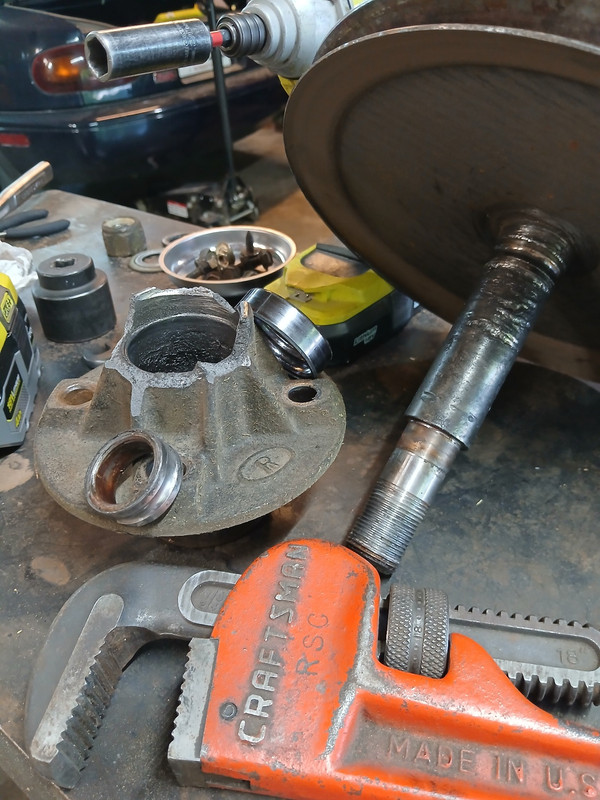

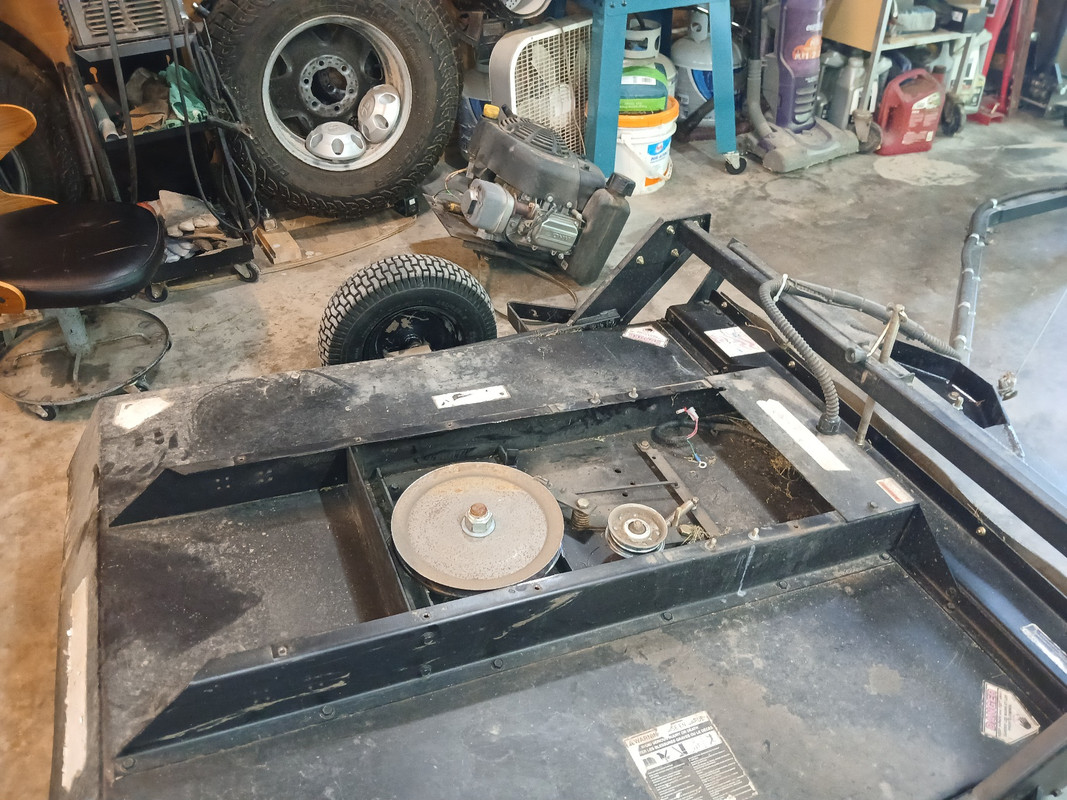

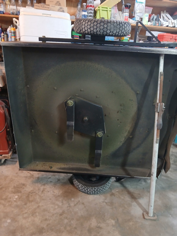

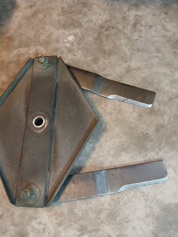

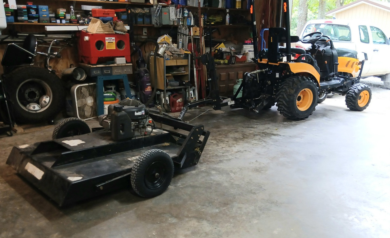

    I started tearing into the Swisher today. Pulled the engine off with engine plate and belt cover, flipped it on it's side for ease of access.
    Pulled the stump jumper. 1 7/16" nuts on each side. I had (1) 1 7/16" socket and used a 1 1/2" on the other side. Who the heck has (2) 1 7/16" sockets laying around?

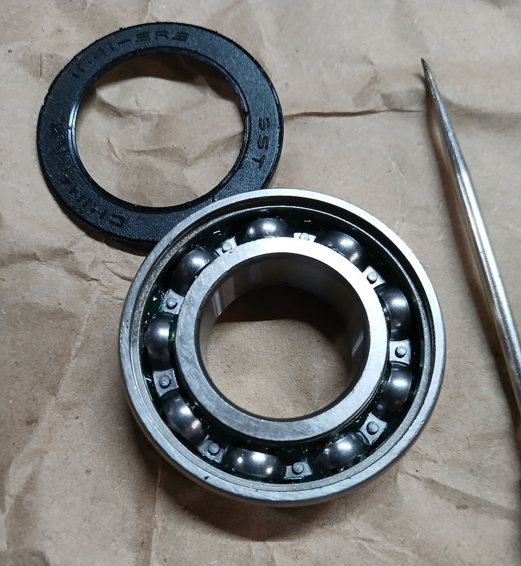

    Pulley and shaft came out of the spindle and the bearing races were just loose--no ball bearings anywhere.
    The blade pulley had some rough spots on it from where the bearing shelled and it probably tilted down. I sanded it smooth.

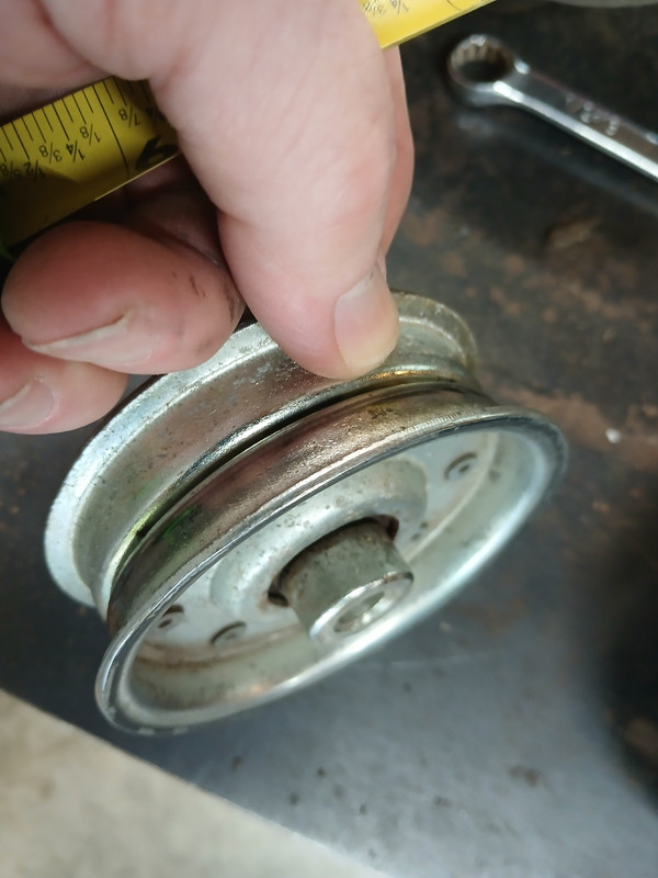

    I did find that the idler pulley bearings were shot and ordered another from amaz0n. If I could get these rivets I would have pulled it apart and changed the bearing but I have no access to steel spread rivets. I guess bolts and lock nuts would work. I may play around with it.
    Blades are shockingly decent for having exploded grapefruit sized rocks frequently and not being sharpened in 2 years.
    I've got parts coming and will drill the spindle for a zerk and pull the inside bearing seals. I will have to run a 12" pipe or grease gun hose from the grease hole to the pulley guard to access it from the top easily.
    This thing is super simple.
    Kbar, Drainbung, RustyGreen and 2 others like this.

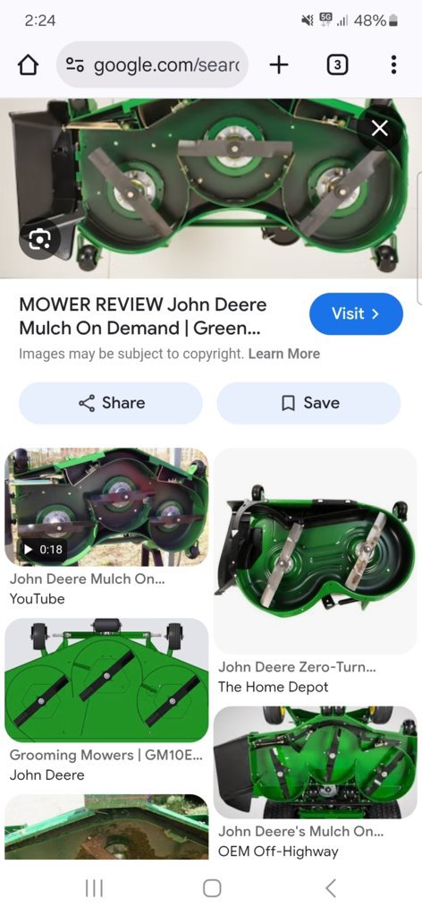

    On a mower deck with 3 blades, how do you guys typically align the blades?
    I usually match them all same direction but started wondering if it matters.

    Not really sure it matters. There's bound to be some kind of startup slip that will probably very quickly throw that out of alignment. Unless it's a timed belt, it's gonna get all outta whack.

    Unless a mower has a cogged belt and pulleys the blade position is irrelevant. They will move slightly with use.

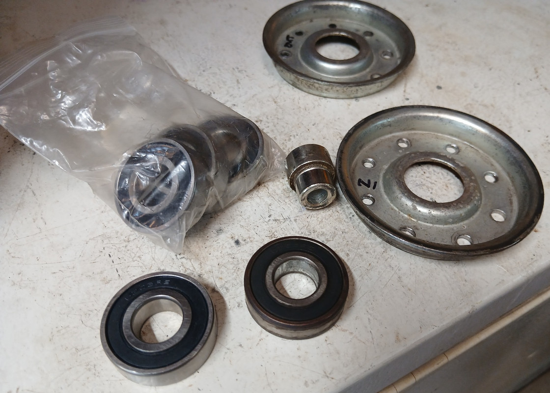

    I drilled the rivets out of my pulley, knocked the bushing out of the bearing and found the bearing number. Somehow the stars aligned and I had a bag of 4 bearings with the same number on the shelf that I had bought at a bin store for $1. I also had 8 SS bolts in the perfect size, just need 8 locknuts. I put the bushing in the freezer and it knocked into the bearing fairly easy. I will buy the crimped style locknuts and red loctite them for good measure. Is this called providence?
    Delta09, Kbar, DES2009 and 2 others like this.

    I put mine on perpendicular to eachother. 2 outside vertical and the middle horizontal. That way the turbulence evens out under the deck and you get max air flow for discharge. It does matter. When the tips of the blades encounter close proximity during a spin, they create turbulence so pointing them anywhere near eachother weakens the properties of the flow because they tumble the air being 2 opposing forces. Perpendicular keeps them in the farthest distance too to tip so they can do their job directing the clippings better
