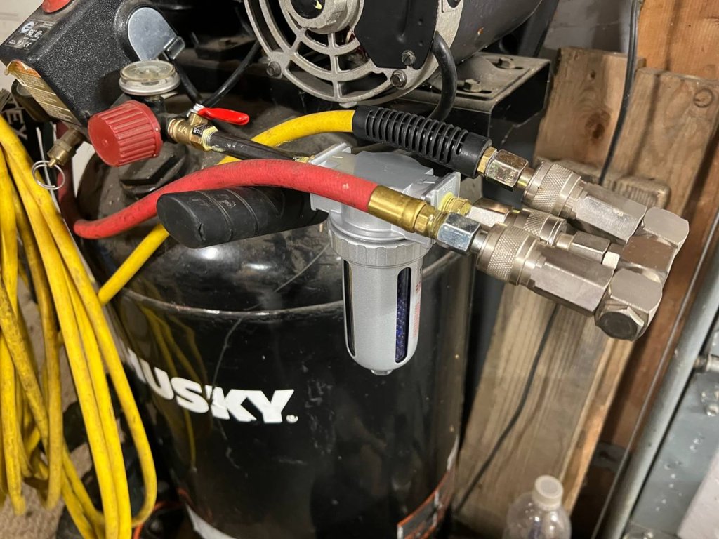

    Putting a 1/4 turn ball valve on my line has helped a lot to decrease how often the compressor has to run to keep it full.

    Do you have a valve to shut off the hoses? I know my lines leak a little bit and I think it's the QD connections causing most of the leakage. Before I installed the valve mine would cycle on every 3-4 hours. Now I only hear it once or twice a day, and it only takes a couple seconds to refill the lines when I want to use it.:thumbsup:

    This spring coming out of the regulator I installed the 1/4 turn valve and then the air drier.

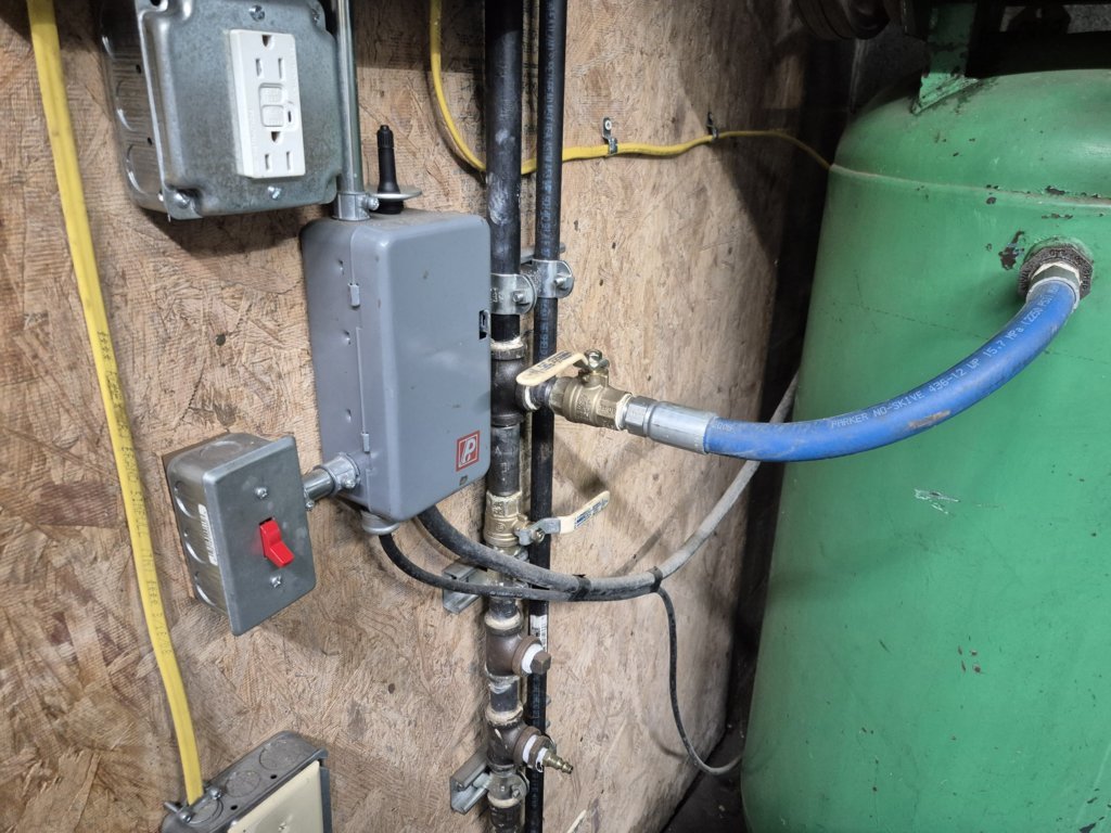

    I always turn the power off (red switch) and shut the main valve when leaving, the compressor will hold air for weeks.
    I replaced the check valve a year or two ago, the original 1960 one got tired.
