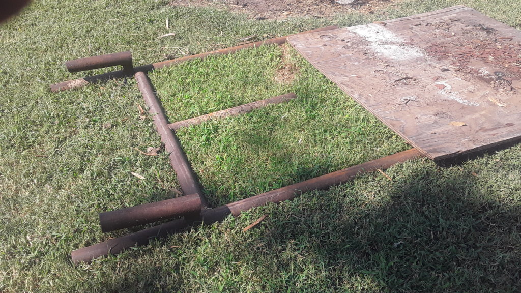

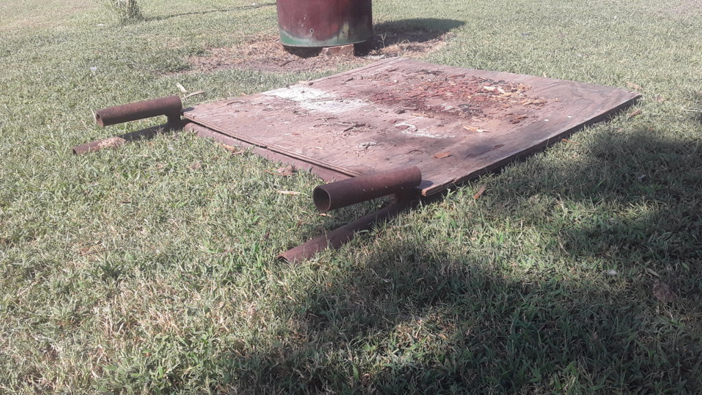

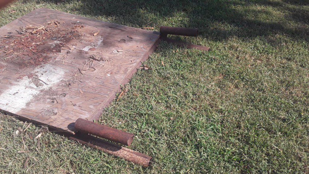

    Okiedokie59
    Okiedokie59 Well-Known Member
    Jun 7, 2025
    #472426
    105
    My most used item. Built out of need.
    2 3/8 drill stem with a 4x4 x3/4 plywood.
    Plywood is not fastened .
    Drive in and out with no lock. 4x4 hauling or working area . It's done a lot, been bent and broken, you see 1 leg is opened up some.
    Handy it is for sure.

  4. Aug 15, 2025 at 3:18 PM

    What is it used for and how do you pick it up?
    sdk1968 and DES2009 like this.
  9. Aug 15, 2025 at 5:10 PM
    Okiedokie59
    Jun 7, 2025
    #472426
    105
    The uses are endless, I had a generator and Lincoln cracker box on it for a portable welder, plus all the other needed goods. Yesterday it hauled 2 stacks of past prime pallets to the burn barrel. I can't count the things its it's done. As far as picking it up, the tractor bucket drives in it. Once acquainted with it, its fast and easy.

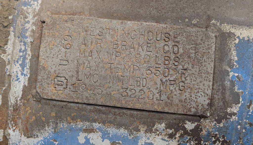

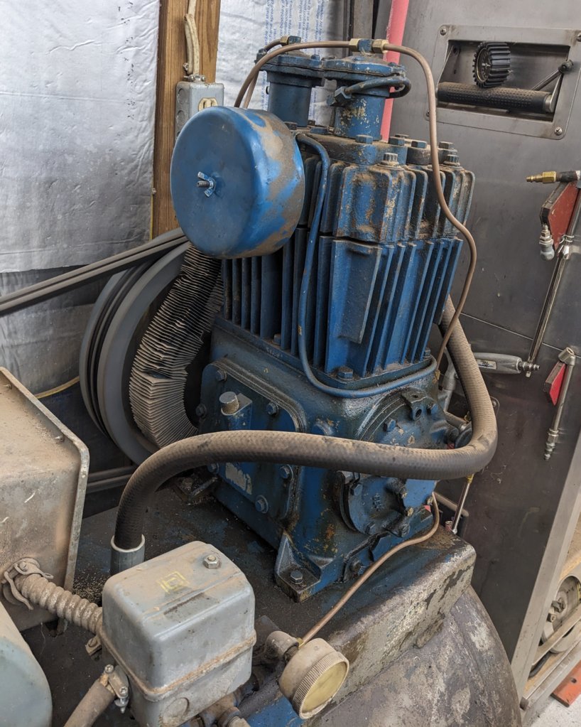

    Gonna change gears on you guys....
    Had a problem pop up & its not anything I know about.
    Any old style compressor experts here?
    Got a really old 2cyl compressor. Positive oil pressure style.. like 1949 is the year on it...
    For some reason today it started having air come out of a hole that hadn't before.
    THEN all to the sudden it now blows & sucks air thru the air cleaner!
    So this makes me think something is stuck letting 1 cyl suck air in & the other pushing it out.
    Needless to say its not useable like this.
    Input?

  15. Aug 15, 2025 at 5:55 PM
    RustyGreen
    Aug 12, 2020
    #337468
    14,739
    sleeping in a chair
    2017 AC 4x4 Sport 6M Inferno
    Pavement Princess
    Can you give us a picture or two of the compressor or at least a make and model?

  18. Aug 15, 2025 at 6:05 PM
    sdk1968
    sdk1968 Well-Known Member
    Apr 15, 2023
    #422563
    300
    03 Taco TRD
    Ok I was wrong it's a 1945 model... Here's some pix..
    It Def sounds weird now. Lol

  19. Aug 15, 2025 at 6:08 PM
    RustyGreen
    Aug 12, 2020
    #337468
    14,739
    sleeping in a chair
    Pavement Princess
    That is a Quincy QR series compressor, a genuine Rolls Royce class unit, one of the finest compressors ever made and still made to this day. :thumbsup:
    It is pressure lubricated and has air operated disc valves - not whimpy reed valves.
    sdk1968[QUOTED] and koditten like this.
  20. Aug 15, 2025 at 6:12 PM
    koditten
    koditten Well-Known Member
    Sep 8, 2013
    #112077
    19,848
    Kirk
    Central Michigan
    04 trd x-cab 4 x 4 3.4l
    Reserected from the dead.
    That a beauty. Older Quincy. These are top tier compressors. Do not toss this in the scrap pile.
    Parts are still available. May just need a cleaning.
    Take it apart. It's easy because it doesn't have a lot of parts. Take pics as you go.
    You got this.
