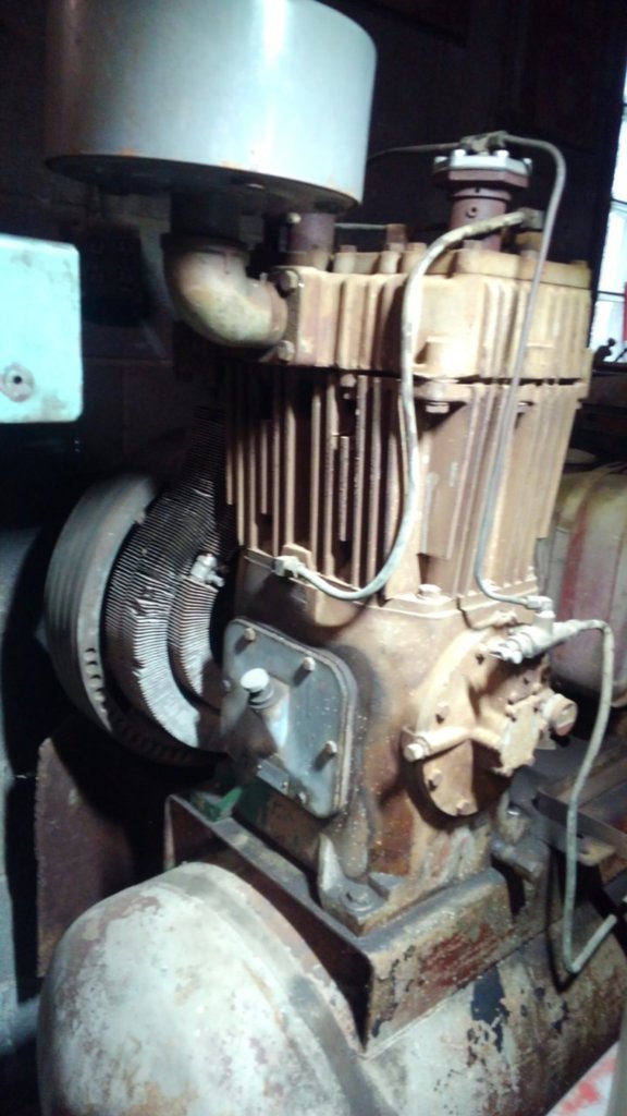

    The tank is from 1945, the pump may be newer. I believe there should be set of numbers stamped into the lower flange of the pump down where the mounting bolts are.
    Using that you can identify the size, year and revision number.
    Then you can start searching for a diagram here: https://quincyliterature.myrevbase.com/

  3. Aug 15, 2025 at 6:24 PM
    RustyGreen
    Aug 12, 2020
    #337468
    14,740
    sleeping in a chair
    2017 AC 4x4 Sport 6M Inferno
    Pavement Princess
    Numbers aren't on the flange - they are on that tag on the crankcase cover.
    I have a QR also, powered by a 2 cylinder Wisconsin engine, the unit weighs just under 1200 pounds.

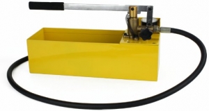

  4. Aug 15, 2025 at 6:34 PM
    RustyGreen
    Aug 12, 2020
    #337468
    14,740
    sleeping in a chair
    Pavement Princess
    Very true, I tested my 1960 tank before putting it in service, easy to do and the pump wasn't expensive for the piece of mind provided.
    More info:
    https://letsfab.in/hydro-static-pressure-calculation/
    Important:
    You want to pressurize to 1.3 times the maximum working pressure listed on the ASME data plate welded to the tank. Do not use the more is better logic, use the proper test pressure and no more.
    Working pressure of 200 psi X 1.3 = 260 psi test pressure
    Working pressure of 150 psi X 1.3 = 195 psi test pressure
    At test pressure I worked the tank seams over with a rubber mallet.
    This is the pump I used:
    $143 Steel Dragon Tools 50557 Model 1450 Pressure Test Pump Hydro Static 860 PSI & 3/4" Connector
    https://www.amazon.com/Steel-Dragon-Tools-Pressure-Connector/dp/B00460UDK2
    sdk1968 likes this.

  6. Aug 15, 2025 at 6:39 PM
    RustyGreen
    Aug 12, 2020
    #337468
    14,740
    sleeping in a chair
    Pavement Princess
    And hopefully change the oil occasionally too, use 20 grade non-detergent oil.

  9. Aug 15, 2025 at 6:49 PM
    sdk1968
    sdk1968 Well-Known Member
    Apr 15, 2023
    #422563
    300
    03 Taco TRD
    exactly!! thats one of the reasons i bought this one. when went to dudes house & he fired it up... i went oh yeah i'll take this one. very comfortable in the shop with no hear gear.
    although right now it sounds completely DIFFERENT. not loud. just different.
    oh & that plate isnt on there... no numbers on that thing anywhere. it looks like it had a plate at 1 time... but it hasnt since ive had it.
    so where do i start?
    Kbar likes this.

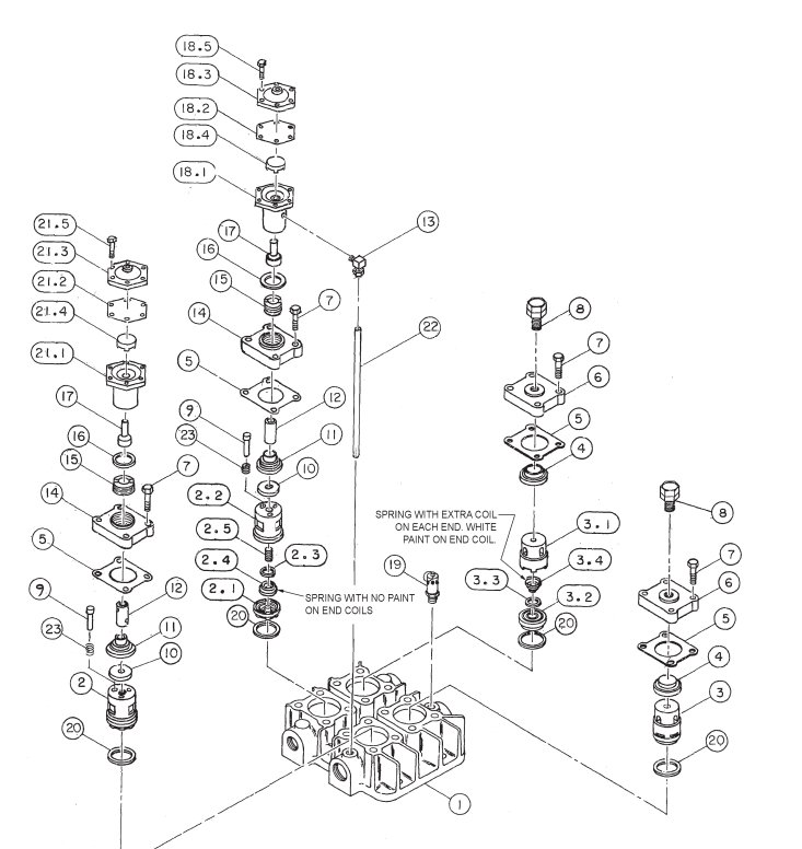

  11. Aug 15, 2025 at 7:39 PM
    RustyGreen
    Aug 12, 2020
    #337468
    14,740
    sleeping in a chair
    Pavement Princess
    Well, crap...
    How many hopsepower is the electric motor? That will help narrow down the size.
    Look here: https://www.engineservicesupply.com/contentonly.aspx?file=pdf/325L PARTS BOOK.pdf
    Look at page 3 where it discusses the control version and compare to your unit, then in pages 10 - 20 you should find a diagram of the valve assemblies similar to yours.
    Notice you do not need to remove the head to service the valve on these units, everything comes out from the top.
  12. Aug 15, 2025 at 7:45 PM
    RustyGreen
    Aug 12, 2020
    #337468
    14,740
    sleeping in a chair
    Pavement Princess
    For the folks following along this is approximately what we should find.
    What happens is that the moving parts get sludge and hard carbon build up usually from:
    1) lack of maintenance
    2) using the incorrect oil (multi-grade detergent automotive oil)
    3) compromised air filtration
    The danger is that carbon can break off, end up in the cylinder and score it.

    Okay I can see how that'd work now, thanks :thumbsup:
