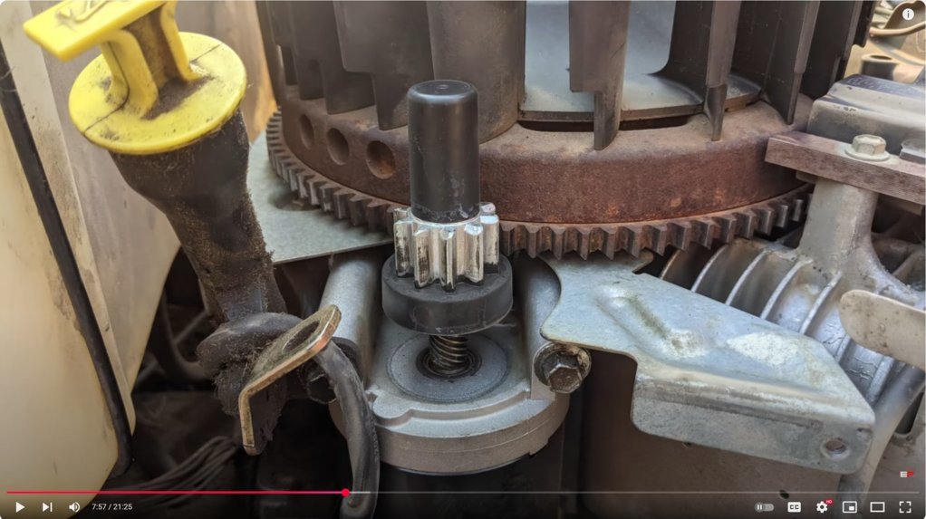

    @koditten (or anyone who knows)....
    I've learned more than I ever wanted to know about the three generations of Kohler starters by watching this video. Well, except for one thing... The Bendix gear on my 61" seems to be sticking sometimes when I turn the key. My starter is a 3rd Gen like the one shown in this picture. The video also shows the starter with the black plastic cap that covers the spring and the retaining nut removed. But he never says HOW to remove the plastic cap. Mine appears to be stuck pretty good, and I'm trying not to break it while trying to get it off to spray some WD40 Dry Lube on it. I don't know if it is supposed to pull off, or if it's threaded.. RH or LH thread?

    Reserected from the dead.
    That must be a Kohler Courage engine? They pretty much only a 6-700 hour engine.
    I don't spend much time beyond diagnosing and sadly telling the customer the engine is EOL, quite often.
    If the lower end is still snug, then yes, put some effort into the starter. I'm not positive, but that cap is not there for much more than covering the threads. It's not doing much. I'd just pull it straight up. It's got to be a snap or friction fit. If it breaks, you aren't out anything. You can still use the starter and it will function just fine without the plastic cap.
    Regardless, those starters are very reasonable. I think I spent $22 with the southern jungle to replace.

    looks like a press on. Skip to 22:45 he puts it on

    It's a Command Pro KT745. The picture in my post is from the video, but my starter has the same plastic cap. I read elsewhere that the cap is supposed to help keep it clean underneath, to minimize the possibility of sticking (like mine he's doing now). But your info and the video that @wilcam47 posted should help me to get it off without breaking it. :fingerscrossed:

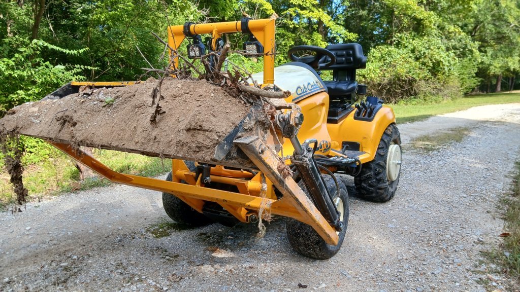

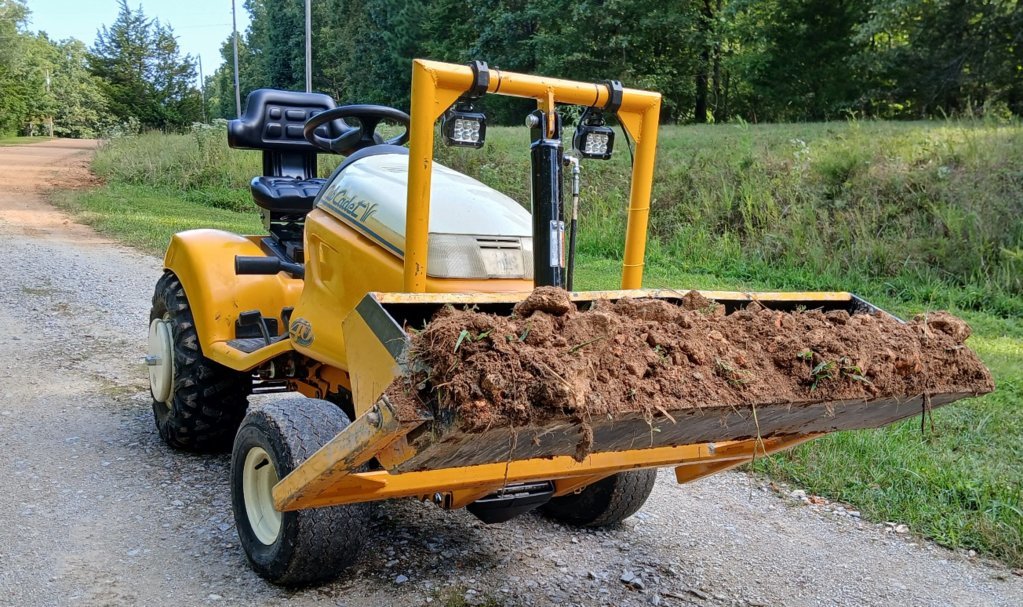

    Cleaning out my road drainage after the county graded and filled it in as usual. When I fabbed my loader I set my loader bucket up to go several inches sub-level. I was able to angle down and dig the edge of the road down 12" deep.

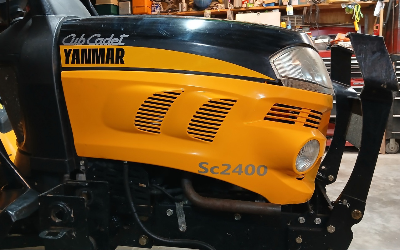

    Also installed the last decals on the Yanmar, the "Sc2400" Tough angle to get thes on right. I set them level. I've seen them at several angles on different tractors but level seems to look most correct.
