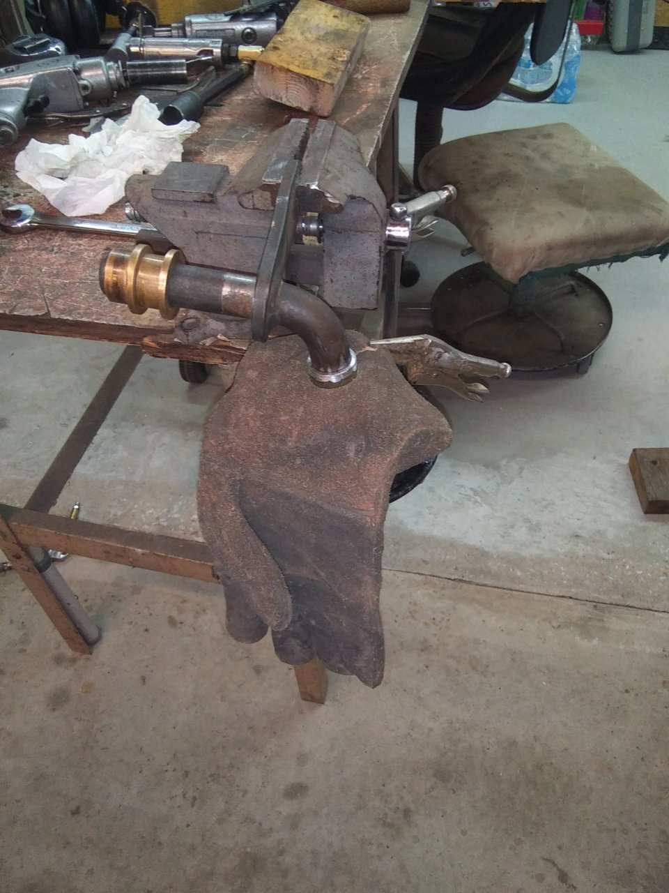

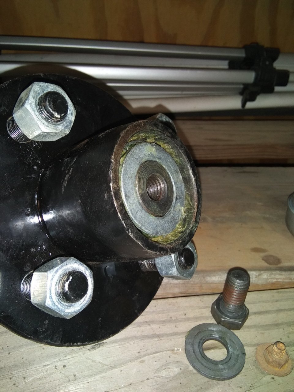

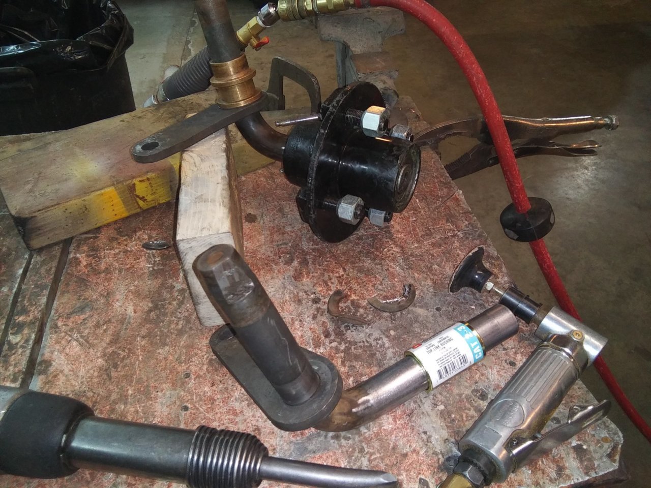

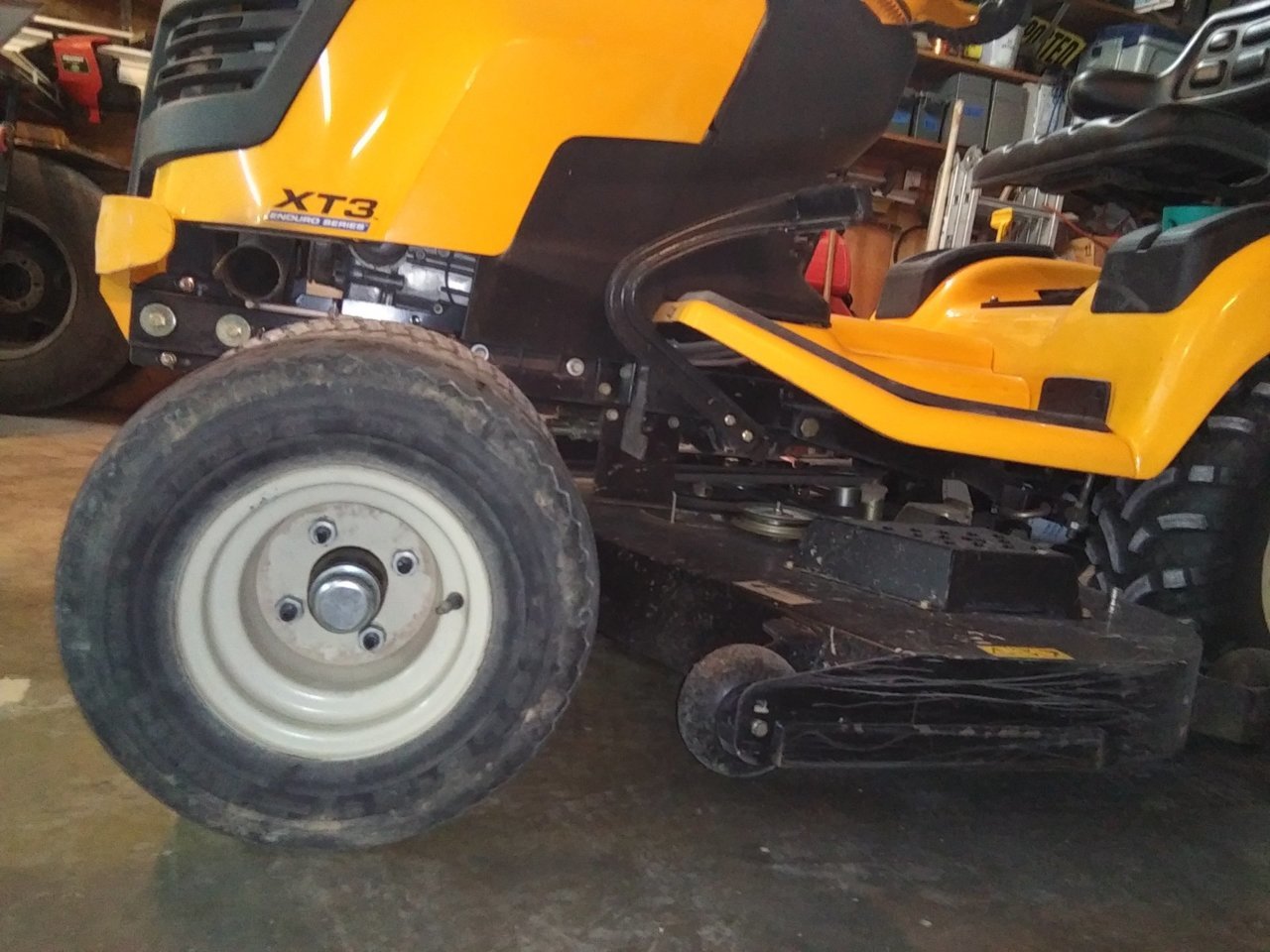

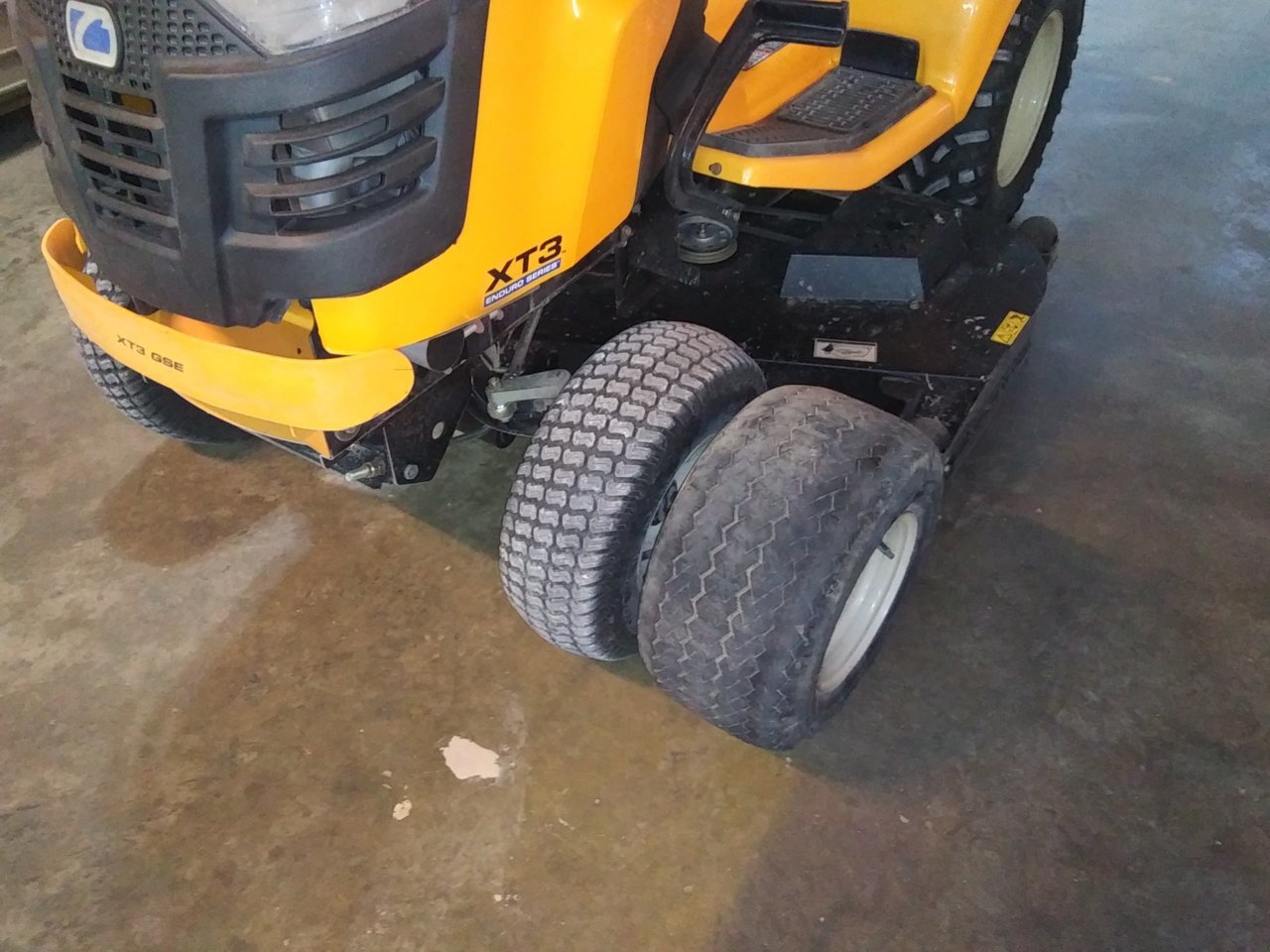

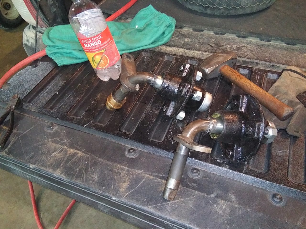

    My 3240 has typical garden tractor front wheel flange wheel bearings on 1" spindles. Boat trailers have 1" spindles as well. I converted my spindles to 4 lug trailer hubs today to accept golf cart wheels. I can get free take-off wheels and tires from my local cart shop and have a stack of them here. Also I figured I'd be better off with these as I'm loading them with 750lbs more than they normally have on them using my loader.
    I cut the spindle backing washers into quarters then used a rivet cutter chisel to slice the welds off. Sanded to size with my angle die grinder. Bought a 1" to 1.25" top link bushing for the seals to ride on and bearing to butt against. Just had to cut the bushing in half and weld it on at the right spot to let me snug up the bearings against it.
    I figured something out when trying to figure out how I wanted to preload the bearings. Put it all together with 1 big washer against the outer bearing and the factory 1/2" end bolt and washer against it.
    Turned it hub down and let the weight of the assembly push on the bearings while I welded the bearing backing sleeve. Bearings should be preloaded perfect with the stock end bolt. I clamped a glove around it when welding to keep the bearing from getting slagged. I can always use shims if I don't like the preload I got.
    If you are thinking of doing this you need about 4.25" of straight spindle to work with. The bearings sitting in the hubs are 3.75" apart.

    Nice Job! any rubbing so far?

    Just on the outside of the other tire lol> Pic was just for demo. These will go on my 3240 loader GT and I will also convert my 3205. My co-worker still has both of those at his house doing dirtwork.
    I bought these spindles from ebay just so I could convert and swap out. I may try the XT3 in the pic last as it has a different type of 1" spindle.

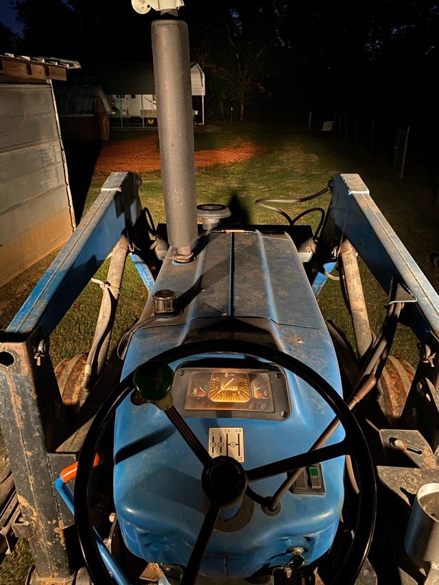

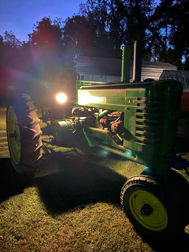

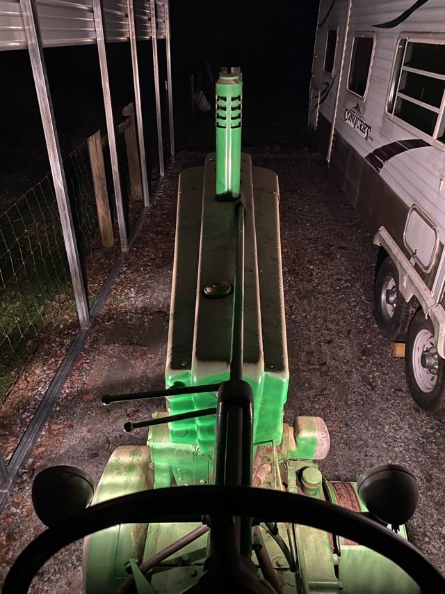

    Moved some dirt this evening and it got dark on me. Moved a couple tractors after dark.

    Love the collection! I’m sure we haven’t see all of them yet ;-) ... I looked for the tag on the rear of the “LA” at brother joes place.... yep, missing. Can see where it should be mounted ...

    We’ve only got 4, the John Deere A, the Ford 4630, and two IH 140’s. I like them all but my Ford is my baby.
