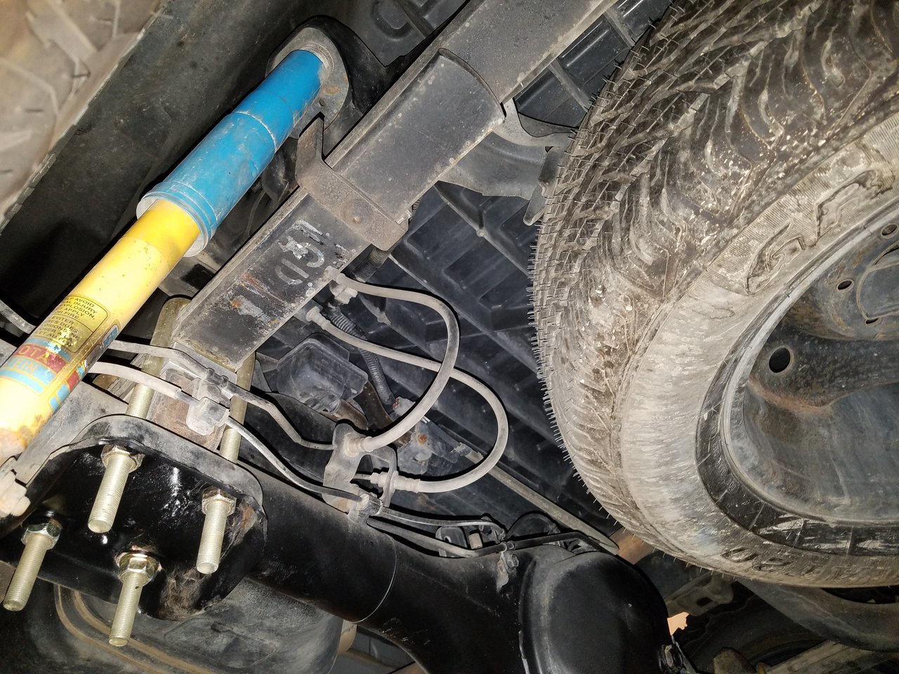

    Thanks all. Quick question and confirmation. I think i have a body lift in the back and coil spacers in front. Can someone please confirm? Also just learned the 5100s can be used with stock coils and set to .75 (?) and this appears to be my first desire and at only 400 bucks (hoping i can install). Would i need to AAL to match for the back to get rid of body lift? Just looking cheapest route to get modest lift and level achieved. Pics attached for current setup. Thanks for the help

    Also pretty sure im already rocking the cheapest lift option so i guess the 5100s are the next step up. Its the leaf packs and getting the 5100s to work with stock coils and achieving level im pondering. im a total noob at leaf packs, the TSB for them and such. No indication previous owner had them changed so i hope all is good. Appears to be a 2 + 1

    Definitely just lift blocks in the back which is good since it would be expensive to remove a body lift. You might be surprised at how affordable 5100s with some good OME coils are. @HeadStrong Off-Road

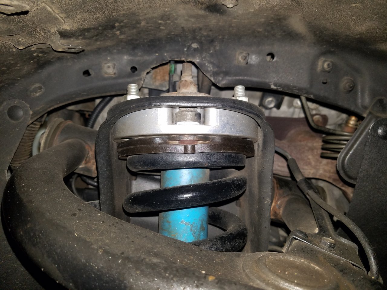

    Thank you boogie. I am definitely going the 5100 route. Am I completely stock up front or is that silver top piece another spacer? I am not thrilled with the spacer/block lift and kinda worried I am causing harm to other areas of the truck. I do not take it off-road, yet, so do you think I will be okay until I can get the funds together to get the 5100s bought and installed? Was thinking I could maybe just do the front first and remove that spacer (if that's what it is).

    that silver piece is a spacer
