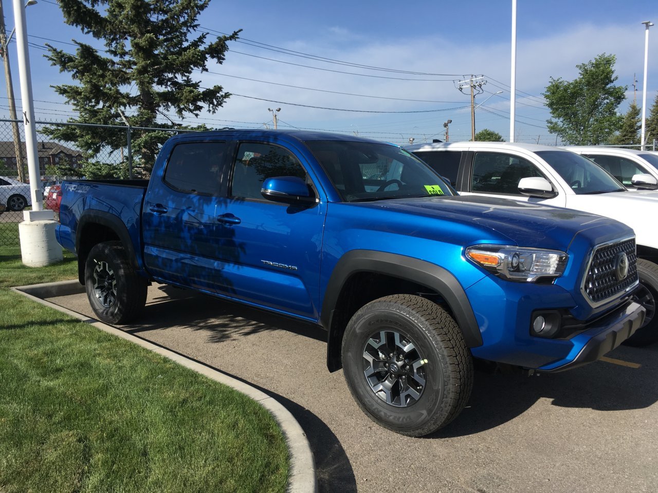

    The kids have grown up to appreciate camping and we have started to say no to way too many fun summer things to do. So while I loved how useful my minivan was, things changed and the Sienna could be more useful with a different family. Decided on a Tacoma - This is my very first pick up BTW. Here is my Taco at the dealer.

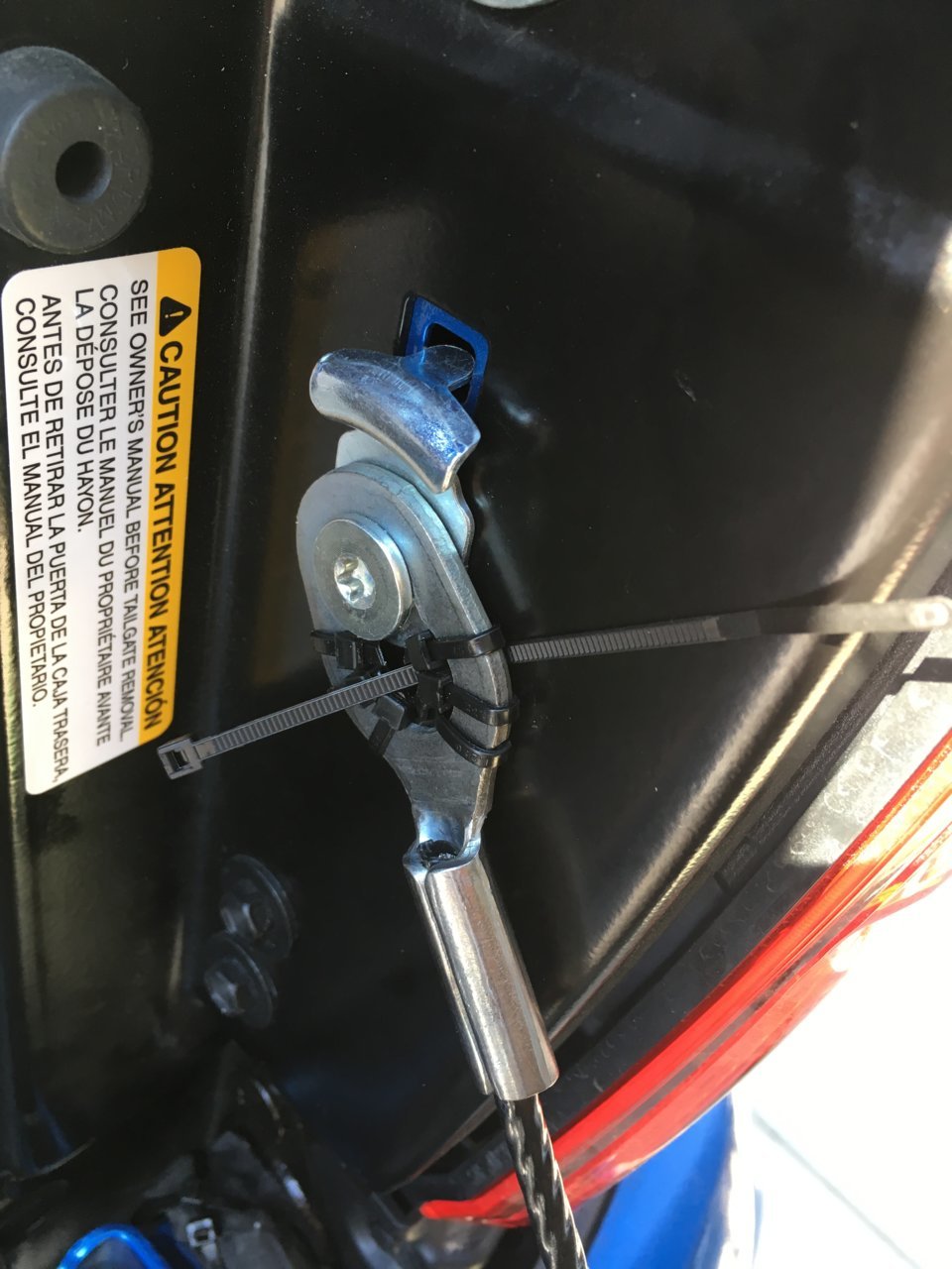

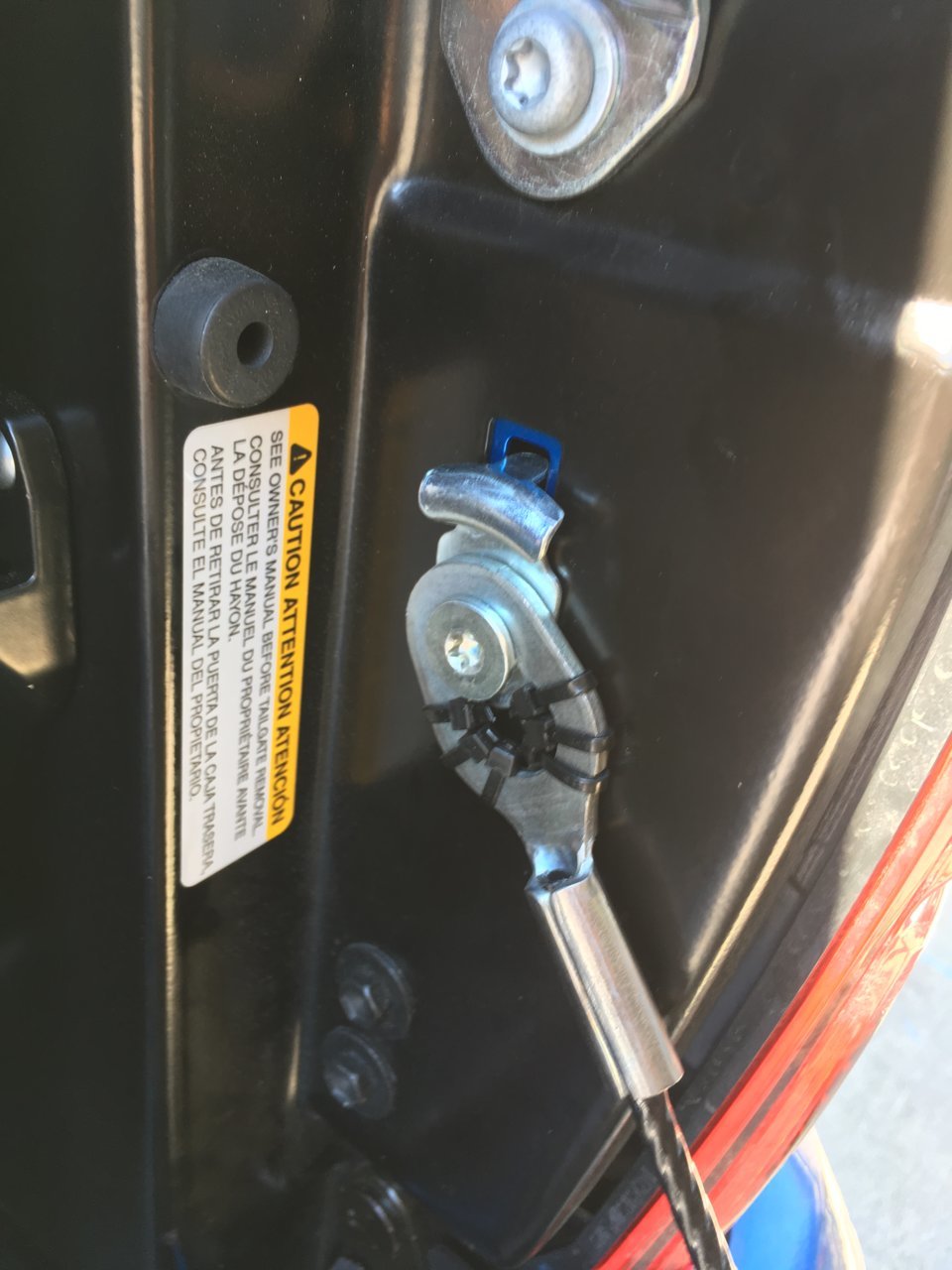

    and for Tailgate Security
    - Pop and lock (actually more for convenience
    - Hockey Tape covered Hose clamp
    - and my take on the washer security mod because I couldn't find the right small washer...
    ... I did this to both sides. Prevents the bolt from getting through the bigger opening to disconnect. While defeatable, is should cause enough of a delay for the potential thief to move on to an easier target.
    Etching a serial number on the tailgate is probably another deterrent too.

    Welcome to Tacoma World, love the security ingenuity:hattip:
