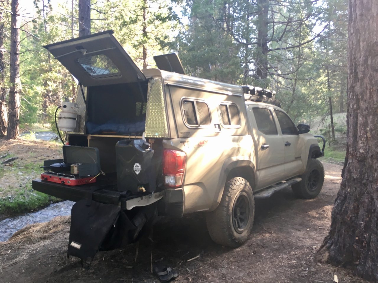

    IMO the second skin, insulation and carpet are a big plus. Even when it’s been snowing outside I’ve slept warm and cozy. I always keep a side window and vent open or at least cracked. That and with the carpet I’ve never had condensation drip.
    40CBF984-36EA-4B55-B5E2-D1601C736E8C.jpg D1049D92-380B-41D5-A1D8-360CD1A8FC38.jpg

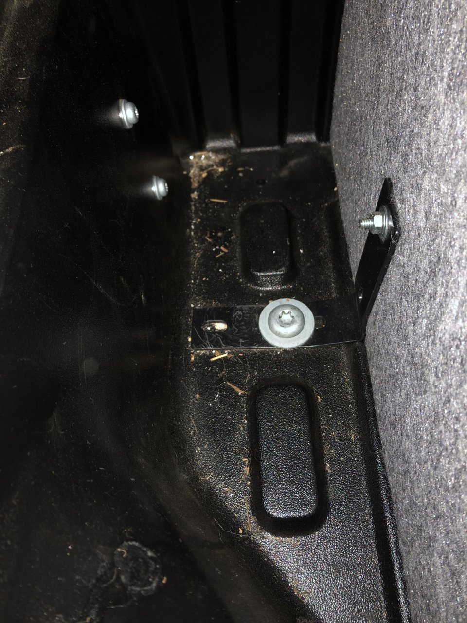

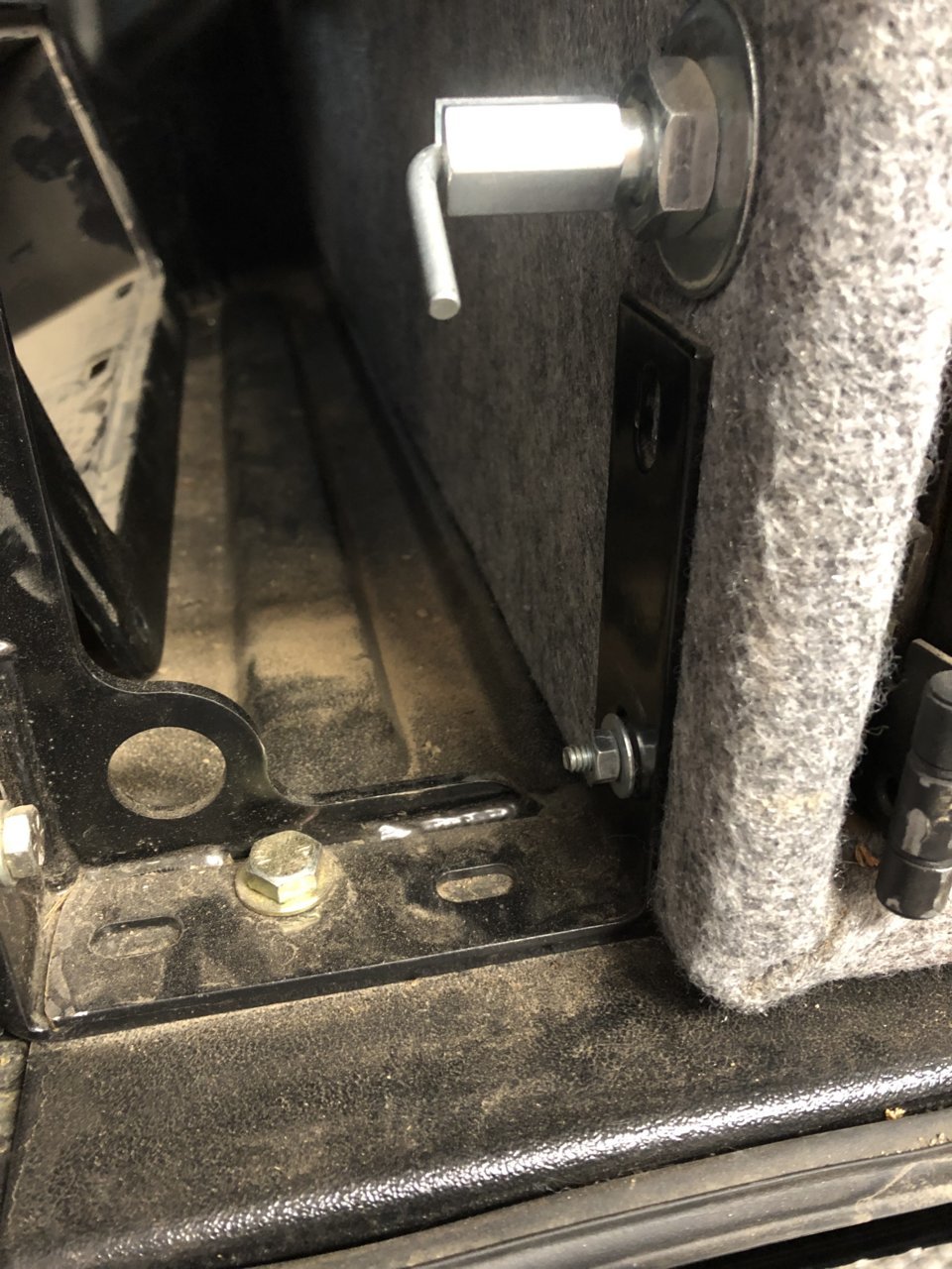

    I bolted mine down using the bed bolts and some angle brackets. I thought I had some pictures of it but can't seem to find them. Basically I used brackets like these and modified them to put the bed bolts through a hole at the front and back of the bed then torqued the shit out of them. I bolted them to the platform using a couple of carriage bolts from the inside-out. I'll get some pics of it later this week. I wrapped the carpet underneath the bottom of the platform. No bouncing around but it also helps that the platform weighs a couple hundred pounds. :eek:

    Finally took some pics! 807B0987-1AAB-4DC9-B44F-4A1A6EB43688.jpg187342E3-11CE-4058-B12F-6972BF7F4AD2.jpg

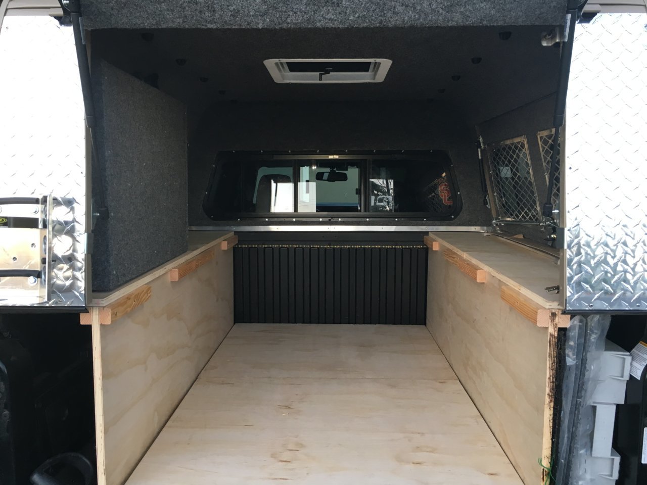

    Here are some pics of my Tradesman that I had installed about two weeks ago. One key difference with mine is that I went with the 24” height. I did this because of a 7’ parking garage that I have to use. My first trip into the garage was a bit of a pucker fest with all of the exposed lights and pipes that seemed lower than 7’. But I’ve got about 4” to work with. 58CCB2E9-3286-40B8-9D00-9E725C0DDAC0.jpg81BE8DD1-3C8C-489D-A4DE-E730FF930D5A.jpg D503B58D-3BBC-4220-A8B1-947925B1F9D0.jpg

    Looks killer and love that bike!
