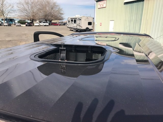

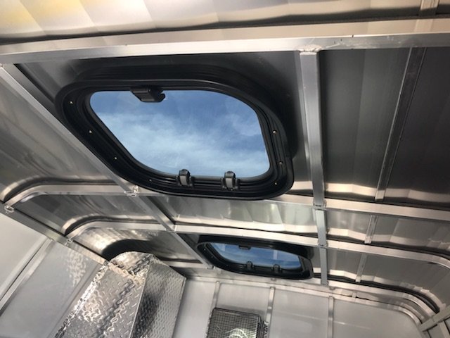

    They are very customizable. I almost ordered some skylights...

    Yeah I thought about skylights as well but in the end glad I didn’t because I now have solar panels up top

    Exactly. I new I'd be putting things on top. View would be obstructed anyway and I also didn't want to risk having a leak.

    @ETAV8R do you know who makes those? Those are pretty slick -- and much more low profile! Looks like it would be a better bet for non-interference with a roof rack.

    i would imagine Maria would be able to source them

    Yes she can. That is who supplied the photos to me.

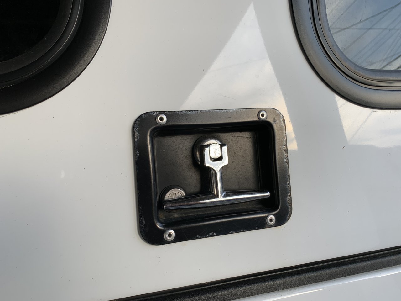

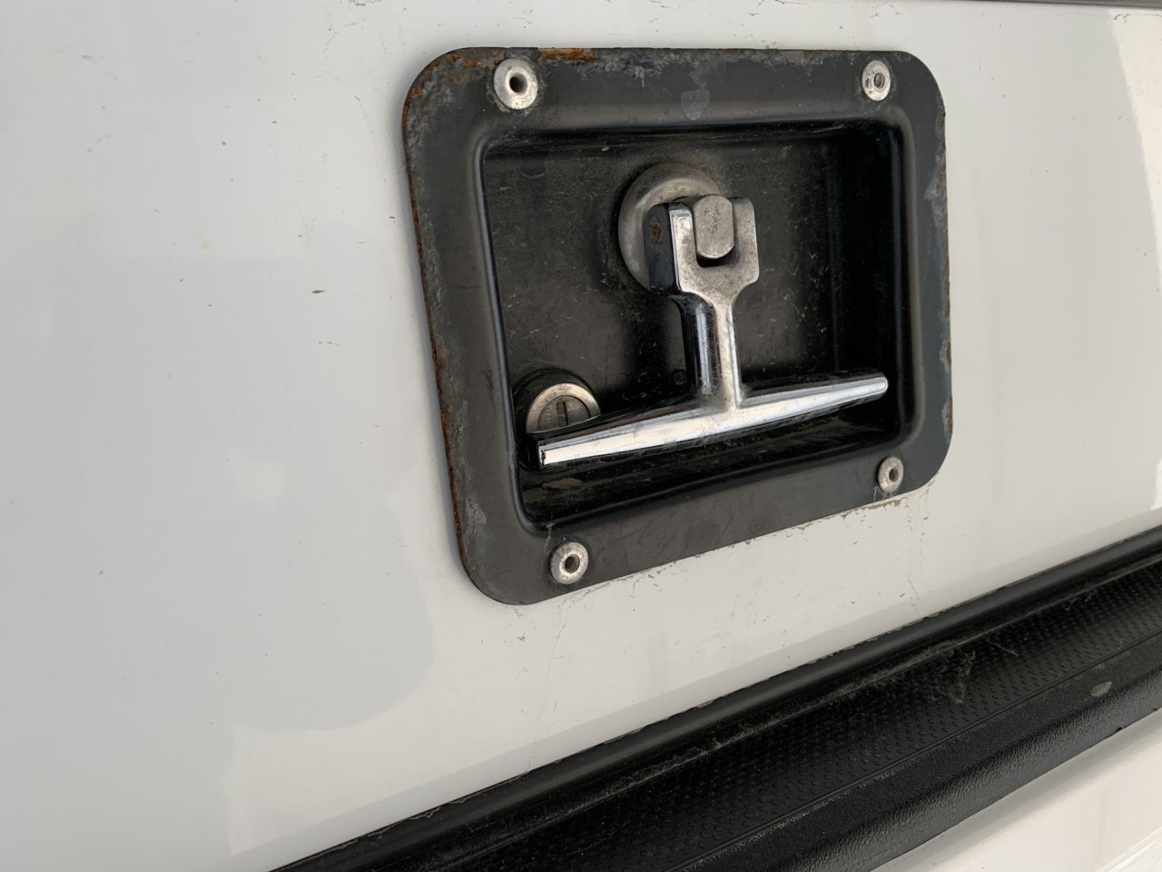

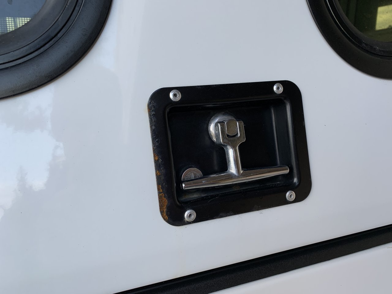

    Posting a follow up just about a year into owning a Trademan top.
    CONS:
    • Rusting hardware on the handles, all 3, poor quality since not driving on salty roads nor beating these up from use.
    • Leaking seals on windows since day one with sheered screws from install. (emailed them with photos a couple times and no reply)
    • Slider window doesnt drop down (maybe another option available now) but pain for clearing ice, snow and obviously to clean
    PROS:
    • Solid structural build
    • Custom setup ability from the factory
    • Good quality on the framing and struts etc... havent had any issues on these items and feel solid
    • Decent install at factory with quality bed seals
    • Super friendly staff when ordering and install, kind of surprised there was no reply when contacting them about the leaking issues first week or owning... but then again I guess everyones cool before you pay the bill.
    Overall, works for my personal and business needs and would recommend it for someone who doesn't just need the totally basic shell, otherwise if you just want a basic shell there's plenty of solid options to compete with this one.

    Yikes. Sorry to see those issues. Glad we don't have real weather here! I'm two years in and no signs of rust on mine, no leaks anywhere except when I park facing downhill in a big storm, I'll get water running between the hatch seal and along a bedrail. Parking uphill resolves it.
    The drop down window slider is an add-on option, non standard, which I do have and recommend to everyone just for cleaning.
    For the handles, it might be worth drilling out those rivets and replacing those handles with some stainless ones if you can find them. Or take them off, sand off the rust, and bed-liner them. Unfortunately powder coating really doesn't do well on the edges of thin gauge material. My Mobtown tailgate panel has the same issues. The powder coating is flaking off the edges after only a year or so. You just can't get enough coating on them.
