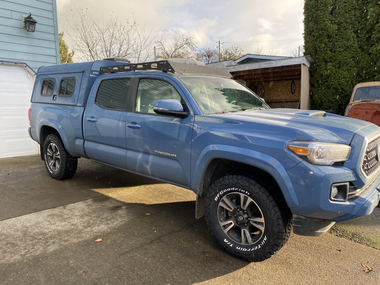

    A28B1986-2FAC-4352-86FA-B9870C7F5B61.jpg EB576CD5-E93C-4EDE-91C6-4F6947D051F0.jpg After lots of memories made, I have decided to go a different direction with adventure rigs and am buying an e450 school bus. just thought I’d post here if anybody is getting ready to pull the trigger on a Tradesman canopy, and wants it now and slightly discounted. ;)
    26” Canopy for a 2019 Double-cab Tacoma (6’ bed)
    Cavalry Blue paint match
    Extra Reinforcing (for driving off road)
    Rear half door lift up
    Rear tinted radius window
    2 60” side lift-up doors
    4 pet sliding windows (2 per side)
    Front drop down sliding window
    Security mesh
    Interior skins
    Insulation
    Carpet
    LED Interior lights with switch
    LED third brake light
    Upgrade d-gasket seal
    Fin gasket
    Standard roof vent placed 6” from front(cab)
    4 folding T-handles
    It is in the Portland, OR area.

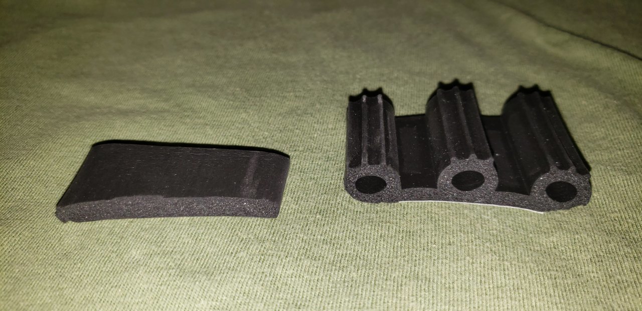

    Sure thing...
    I've already received this but after getting it I decided to order the other layer for the bed rail.
    https://www.amazon.com/dp/B00NCCNUJQ?ref=ppx_yo2_dt_b_product_details
    https://www.amazon.com/gp/product/B00IPQR63A?ie=UTF8
    I think after I install these I'll add locktite to the bolts.

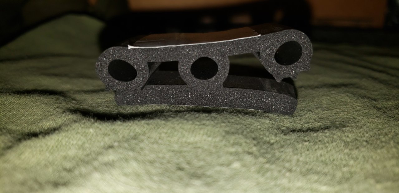

    Please share thoughts about which should go on the rails and which should go under the shell.
    Originally I thought the triple bulb should go under the shell but now I'm thinking it would be better on top of the rails.

    My shell is an ARE MX so not a direct comparison. The original flat weatherstripping under my topper is also shifting out. In my case it’s moving to the outside of the bed. I plan on replacing it with the triple bulb seal. Everything I’ve read on it says to apply it to the bottom of the topper, which is my plan. I’m not sure if you would get any benefit of using the flat seal also and it may increase the slippage chance.

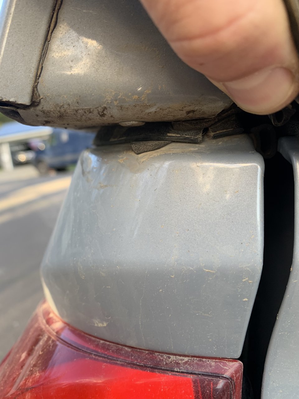

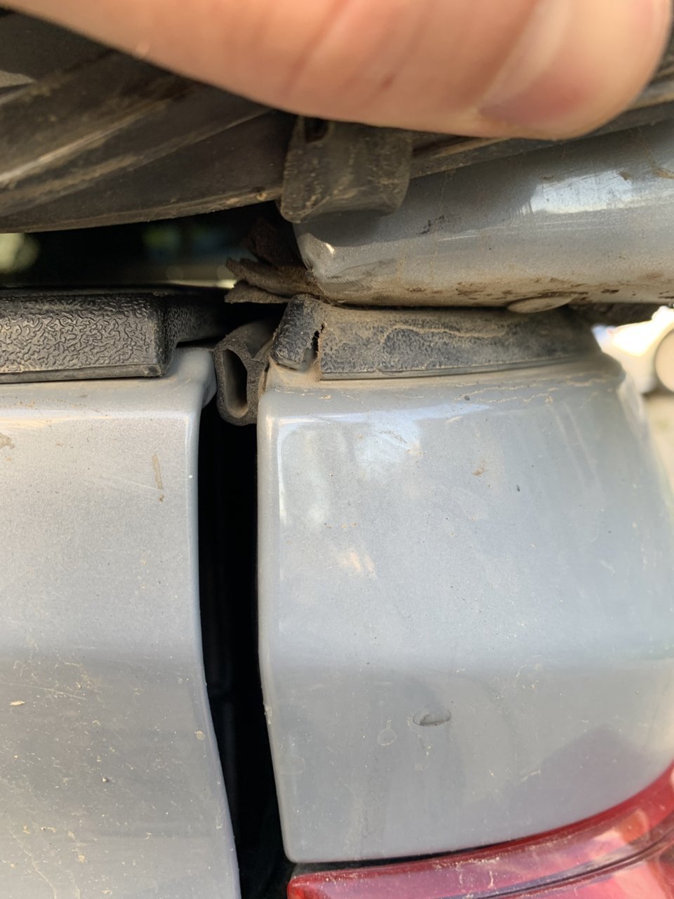

    Really? Mine is 6’ also but the half cabinet not the full length. The cracks on my bed rail caps are at the very back end, but doesn’t seem to extend further up the bed. KBvoodoo makes metal caps for 2nd gens but nothing for 3rd gens from what I’ve seen.

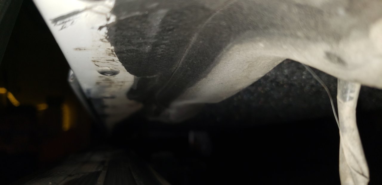

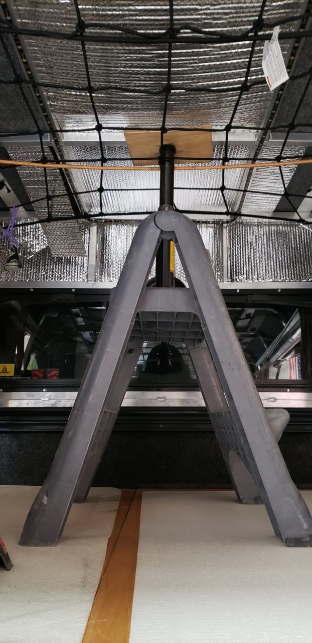

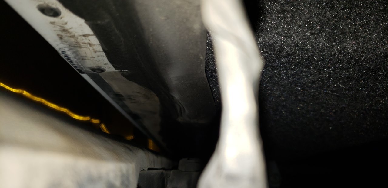

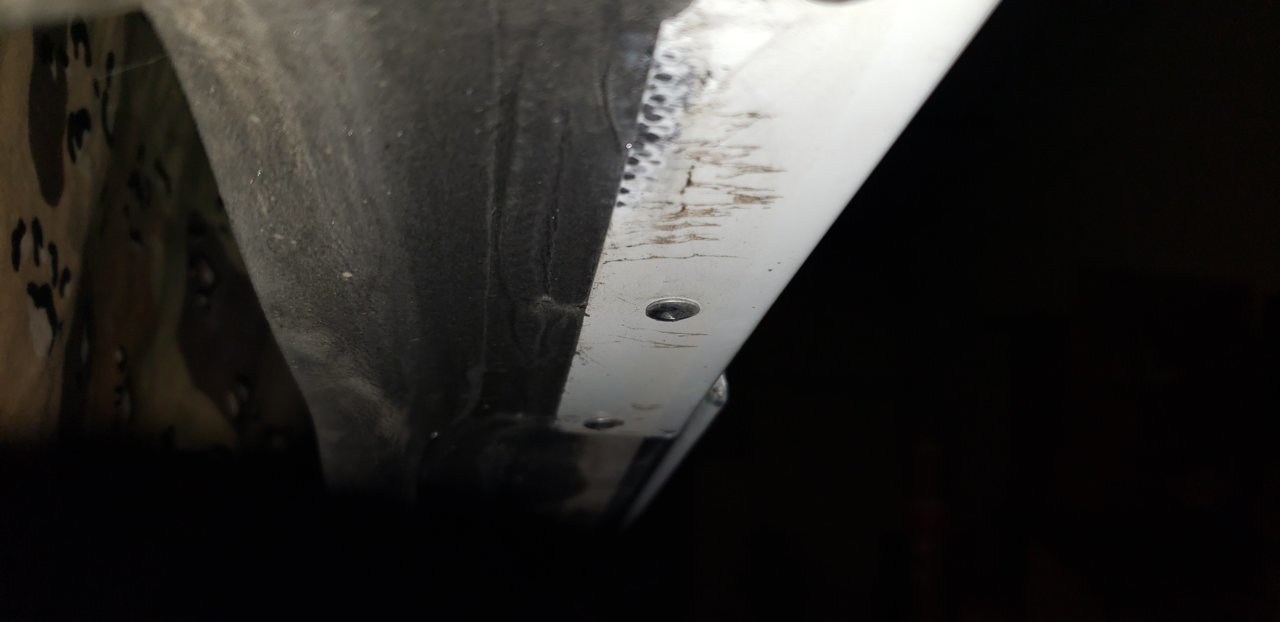

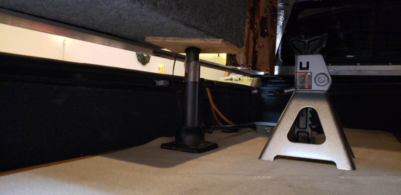

    Started the bulb seal replacement. Tradesman uses two 1.5" strips under the shell. Somewhat disappointing but glad I'm replacing it. And bottle jack for the win!

    I thought I finished the installation today. I used both seals I bought but in hindsight I'd recommend only one. The shell was a bit higher than before so there was a gap on the cabside. I filled the gap with extra triple bulb seal I had. Then got it centered laterally and clamped it down.
    Well I didn't check the rear door seal prior and I have a gap now. So I'll have to unclamp it and move it cab forward a bit.
    Oh and I figured out how to make it a one man job too.
    p.s.
    I ended up taking off the single layer from the bed rails. So for future replacement only one layer is needed.

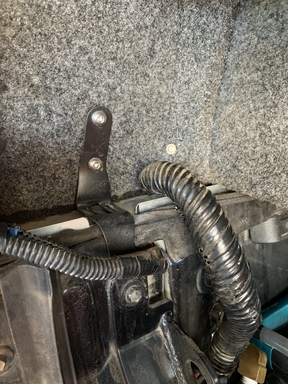

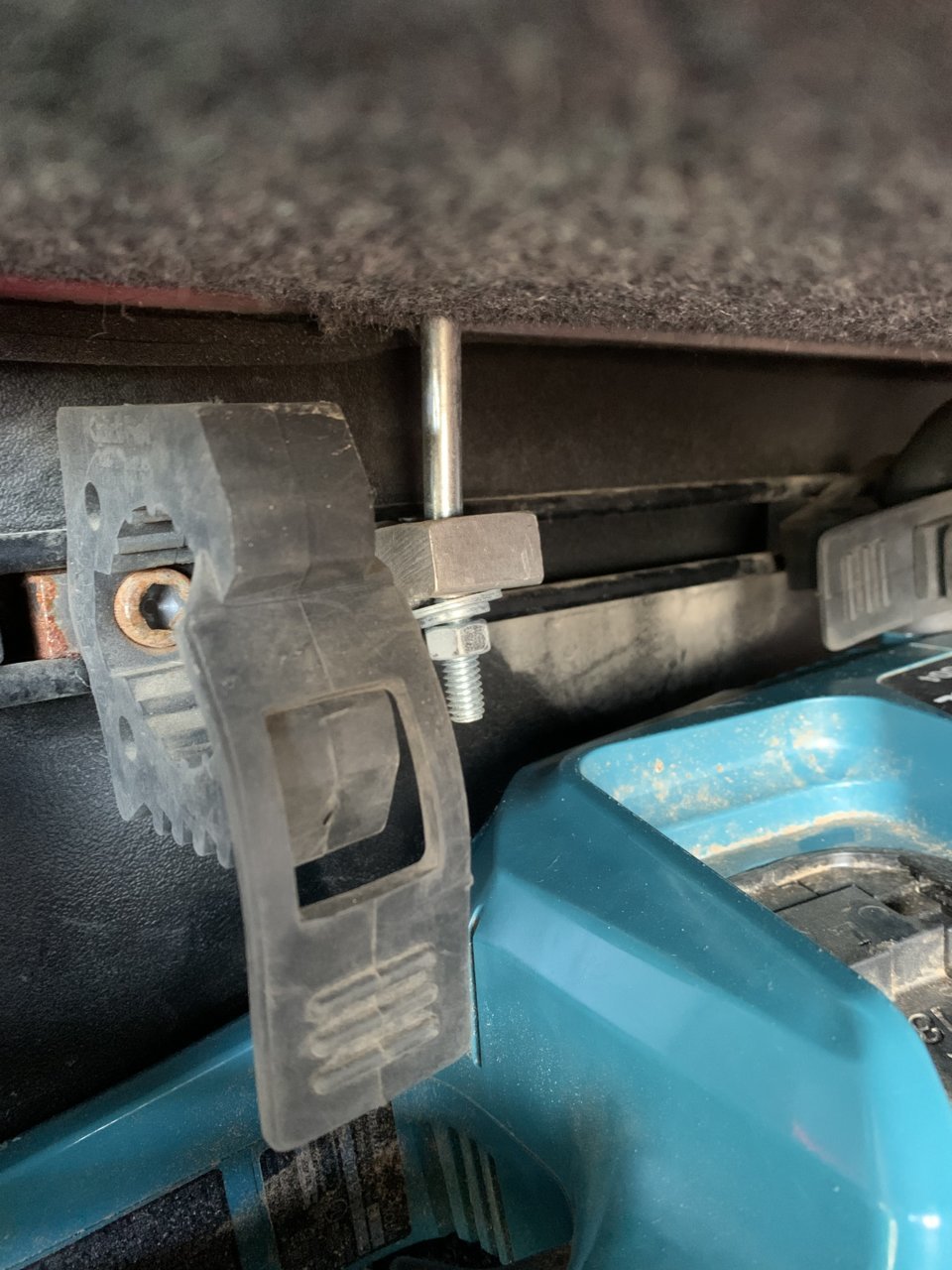

    For reference, here is a pic of my cracked rail caps and my bracket and cabinet bolt to keep the driver side from splaying out. I riv-nutted two nuts into the inner skin and bolted it to that. It’s not robust, but it doesn’t seem to need much to hold it in. I’ve done some pretty good off roading since installing that, fully loaded and it seems to be staying put. Annoyingly, the seal is still coming out part way.

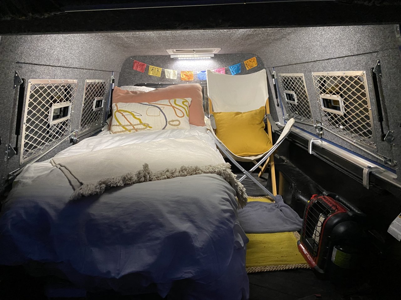

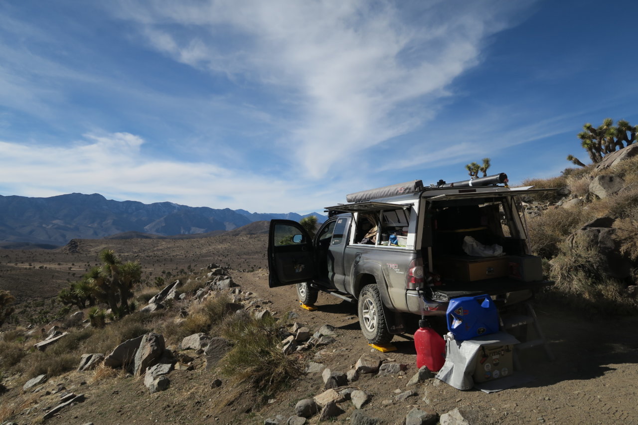

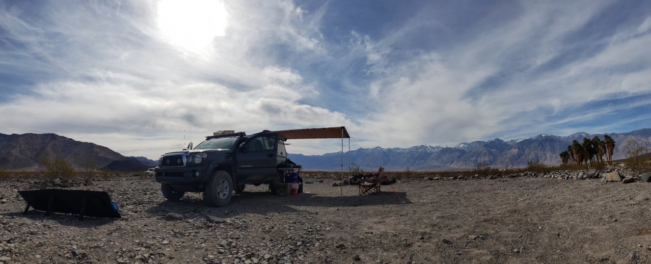

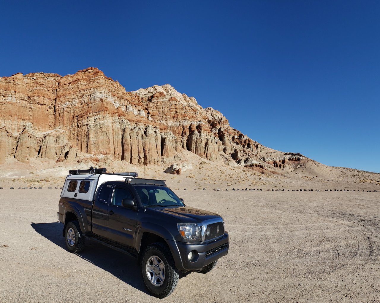

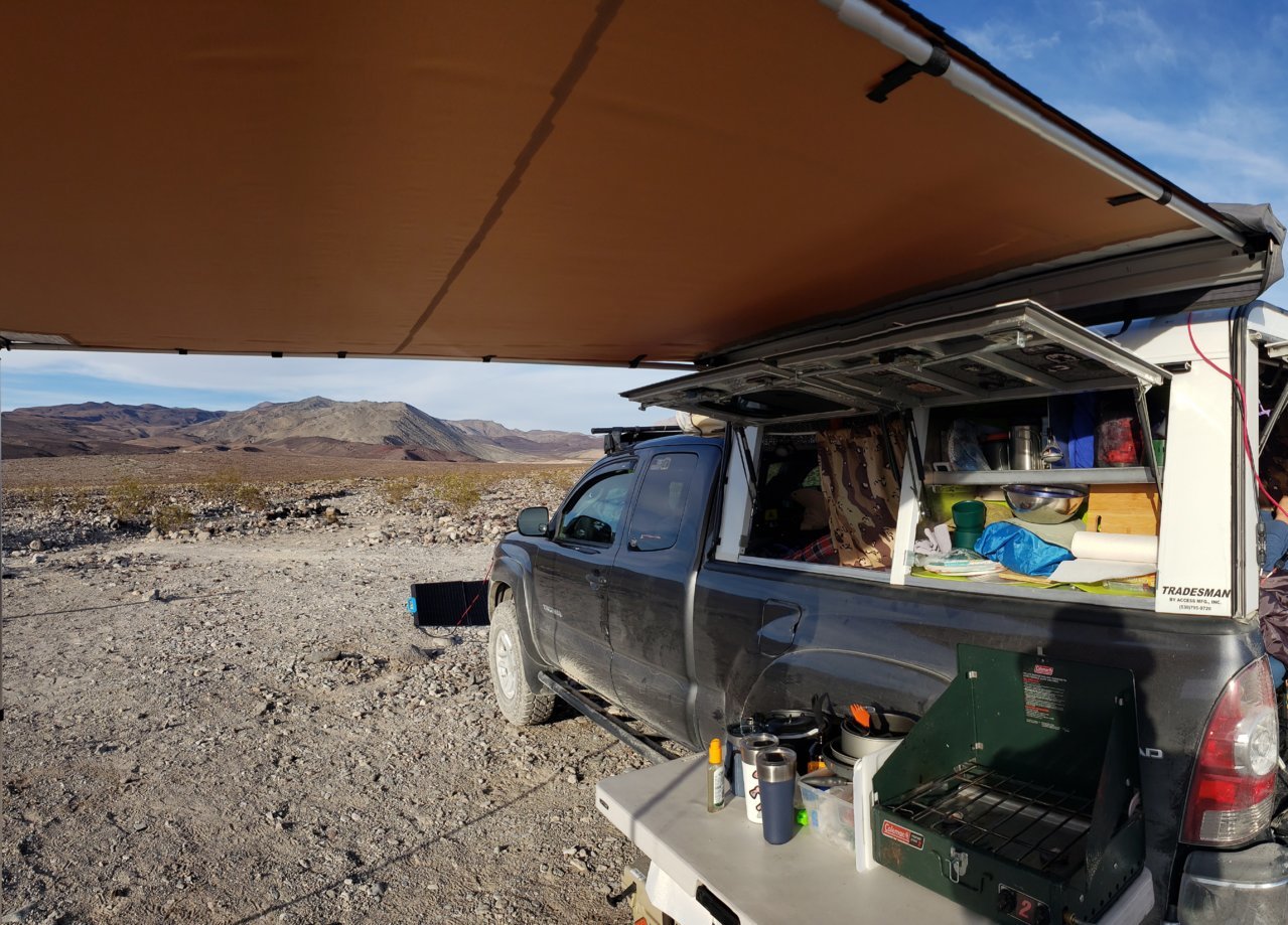

    From a recent camping trip...
