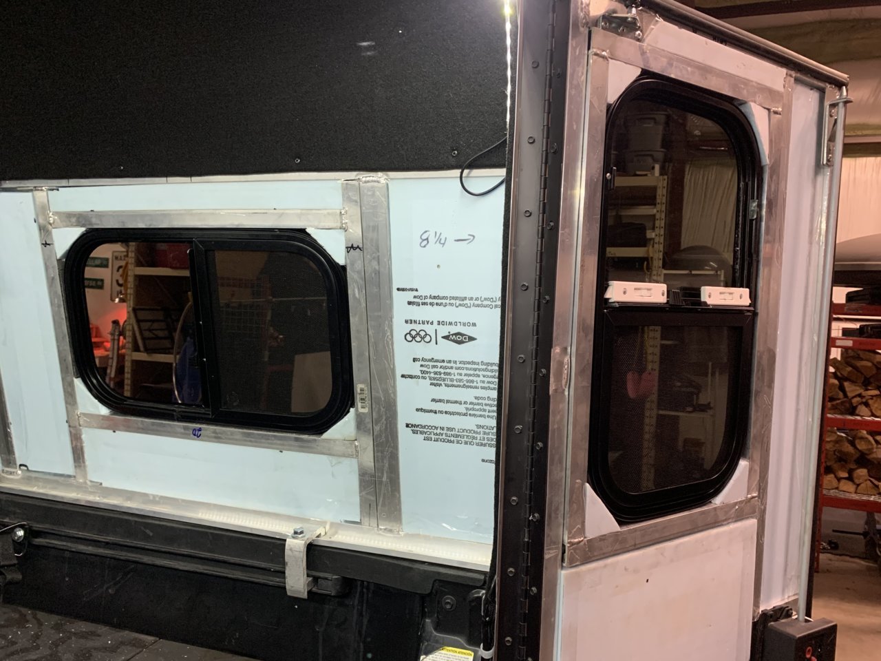

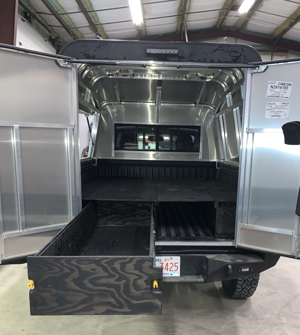

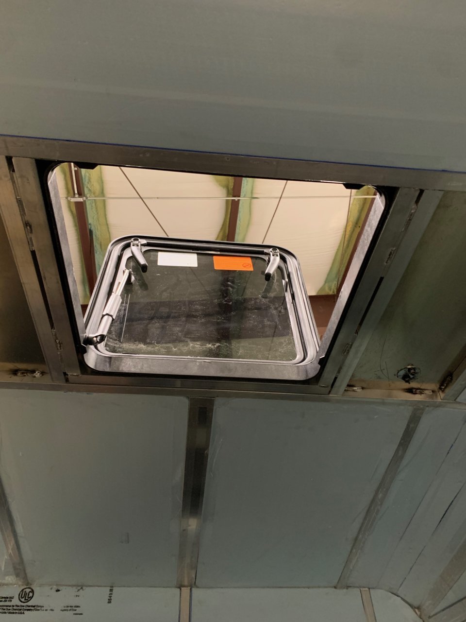

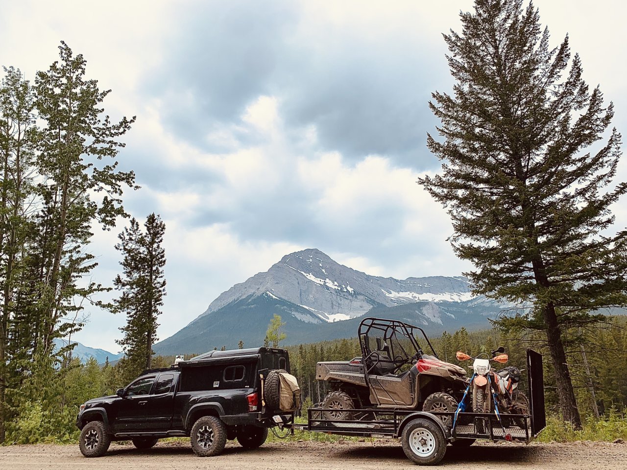

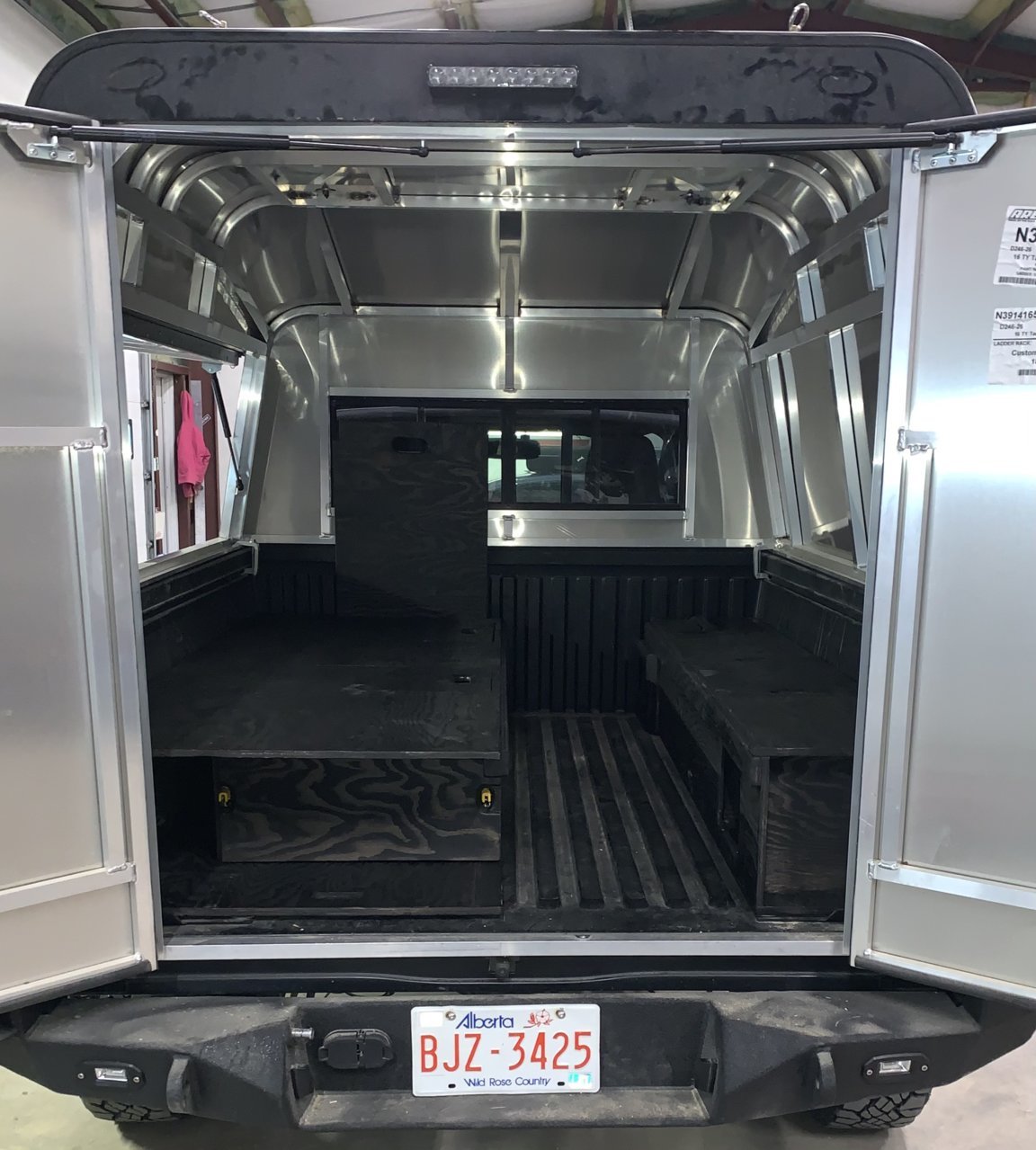

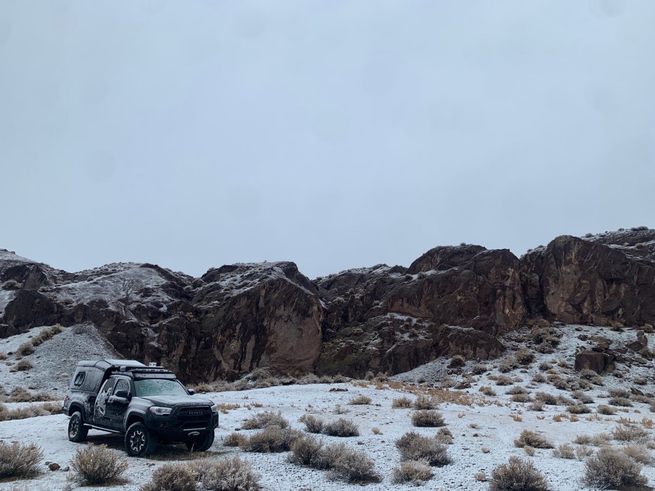

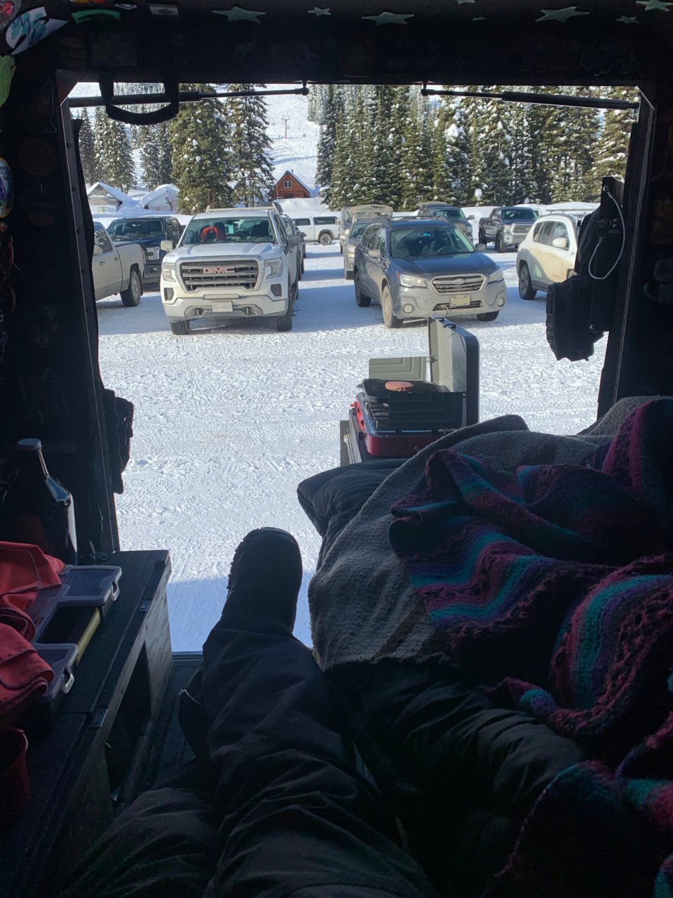

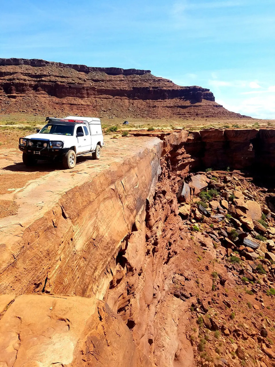

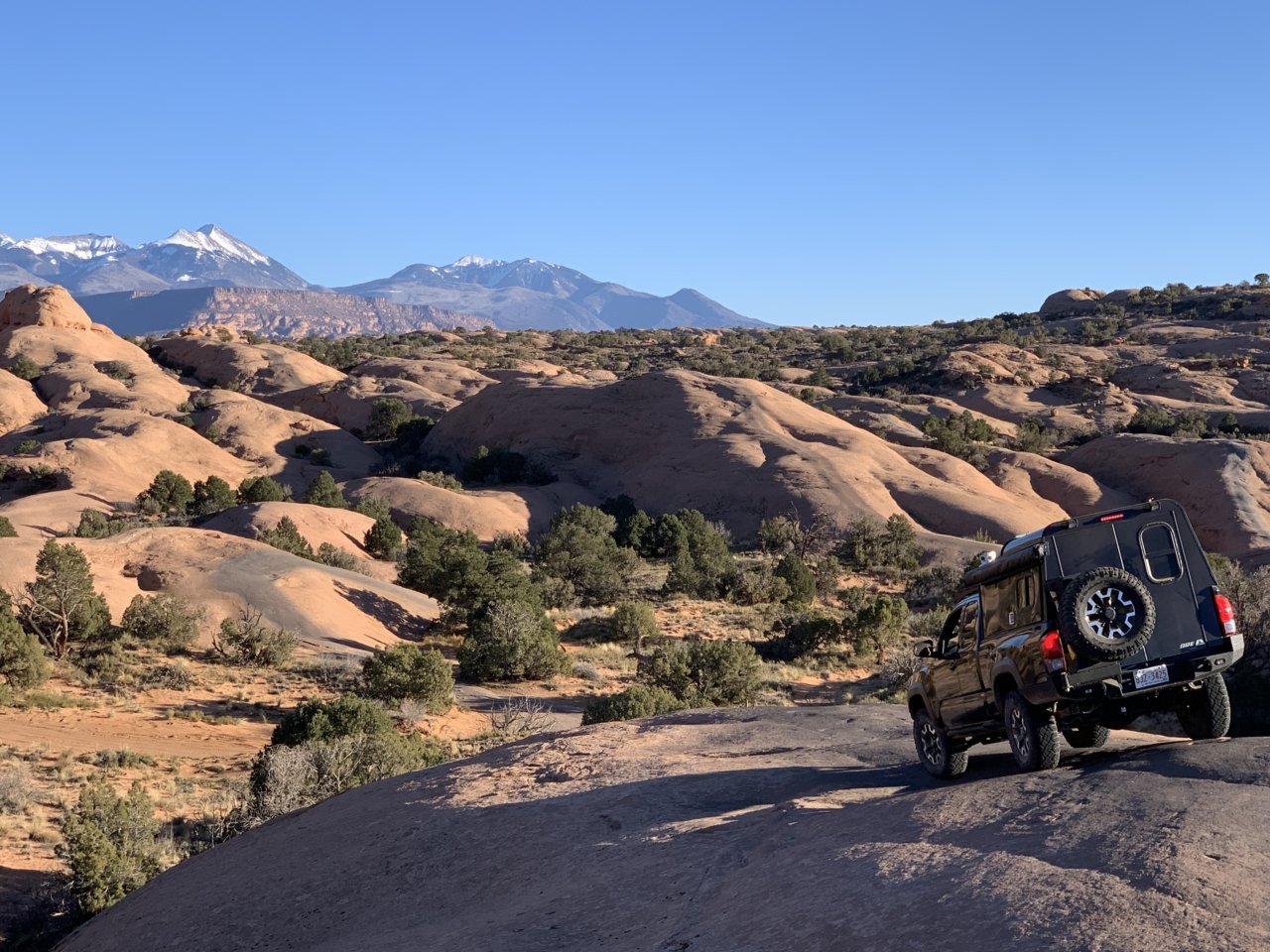

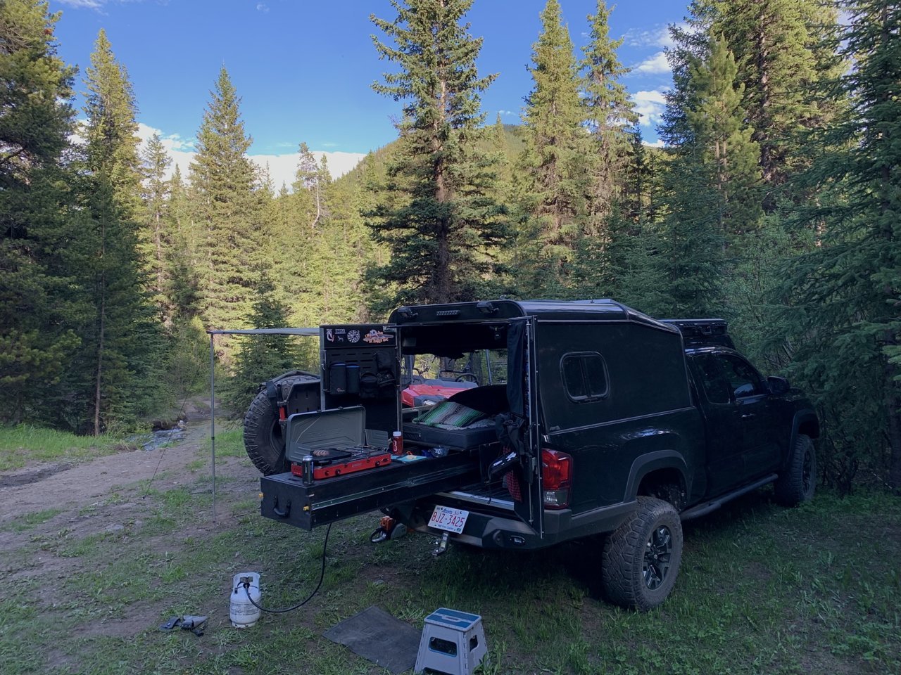

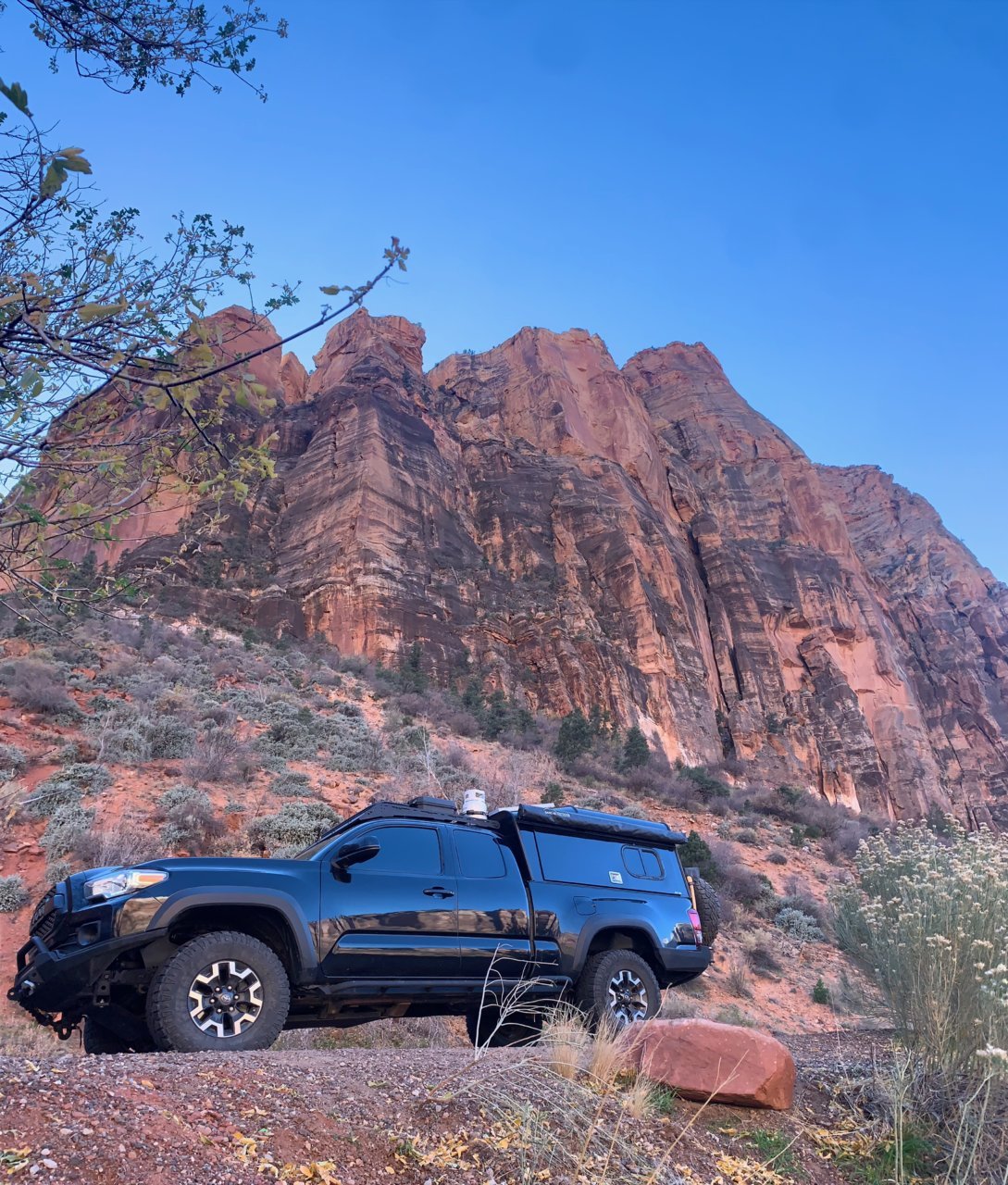

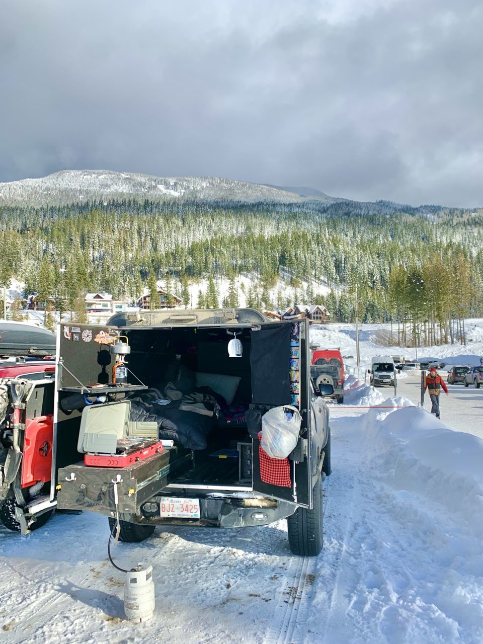

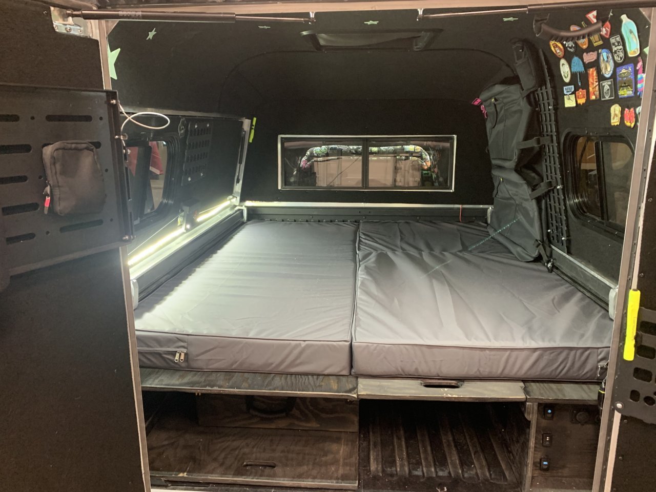

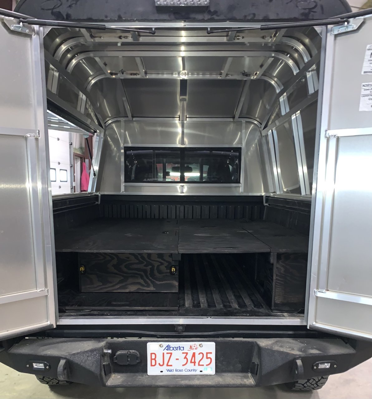

    After a couple years coffin camping out of 4Runner with slide, the wedge has been a game changer for us.
    Added my own windows and a marine hatch. Solar panel mounts perfect to the wedge section. Lots of room to sit up. I built my platform modular so when going solo I could remove a section and have a bench seat.

    I love your setup! Do you have any pics of the platform build I love the drawer system you made. Also was it hard adding the windows? I’d like to able to open the side doors but also have slider windows when closed and inside but ARE doesn’t offer the slider windows with the side hatch I don’t think

    They don't offer slider windows with the side hatches, which is why I went with my own. They're just RV windows. I fabbed some frames and bolted them in.
    Ordered some custom outdoor cushion covers and just cut foam to fit. I run a Jakery 1000 for power, it's stored under the front corner of the platform and powers a small fuse panel for lights, and the fridge (which is in the back seat) 400w anytime mod charges the jackery when we're on the move, solar panel does the rest when parked.

    Dang brother you got the exact setup I’m hoping to build lol the platform is perfect I like how you can remove the center portion when not needed and the single drawer on the left. Good work!

    The removable portion is also the same width as the slide and fits in a grove i routered into it to act as a table. You can see is some of the earlier photos with the bbq on the slide.
