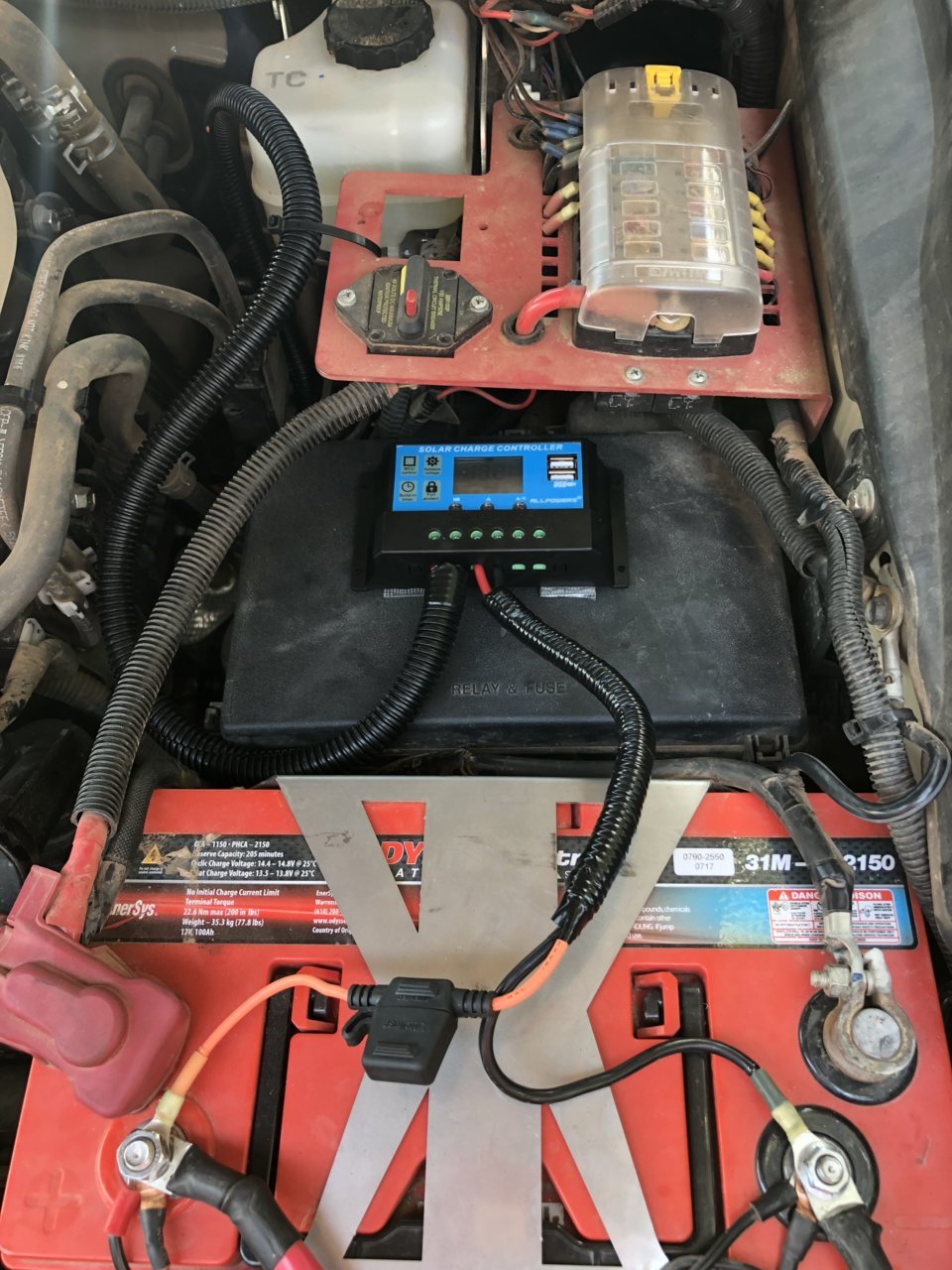

    6F12E9D5-E715-414C-AEB4-D7DE51F7B897.jpg 4DE810F0-55FD-4932-B193-95B77A055C51.jpg

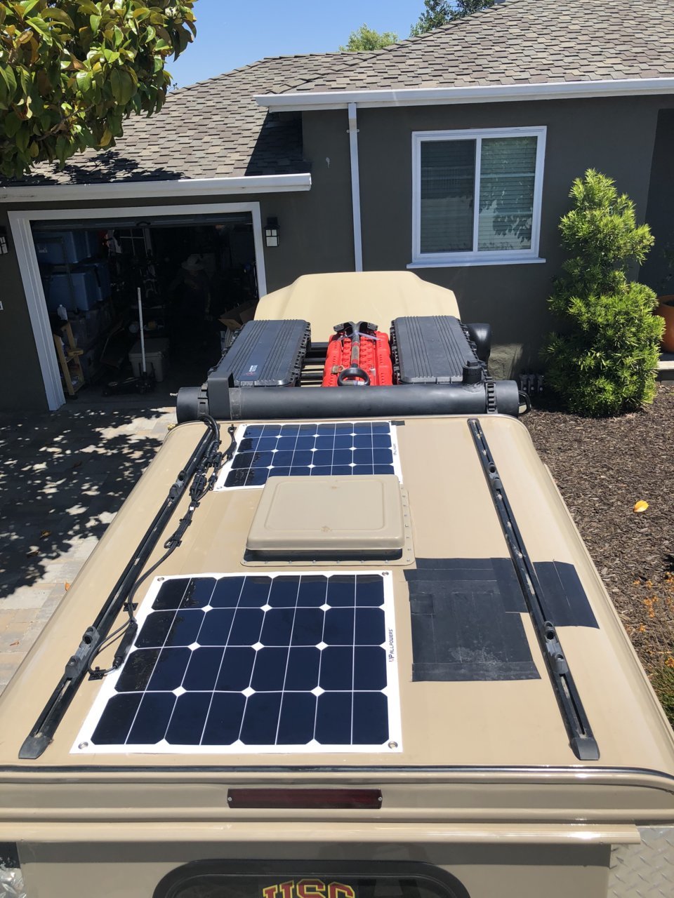

    Put some thin solar panels on the top of the Tradesman using RTV silicone. I was told to use it by someone who did it on their trailer a couple years ago and they are holding strong. Actually an easy instal.
    A couple of these:
    https://www.amazon.com/gp/aw/d/B013DZWDI0?psc=1&ref=yo_pop_mb_pd_title
    One of these:
    https://www.amazon.com/your-orders/...ryId=&returnUnitIndices=&shipmentId=D4zlH2CwN
    This:
    This:https://www.amazon.com/your-orders/...ryId=&returnUnitIndices=&shipmentId=D4zlH2CwN

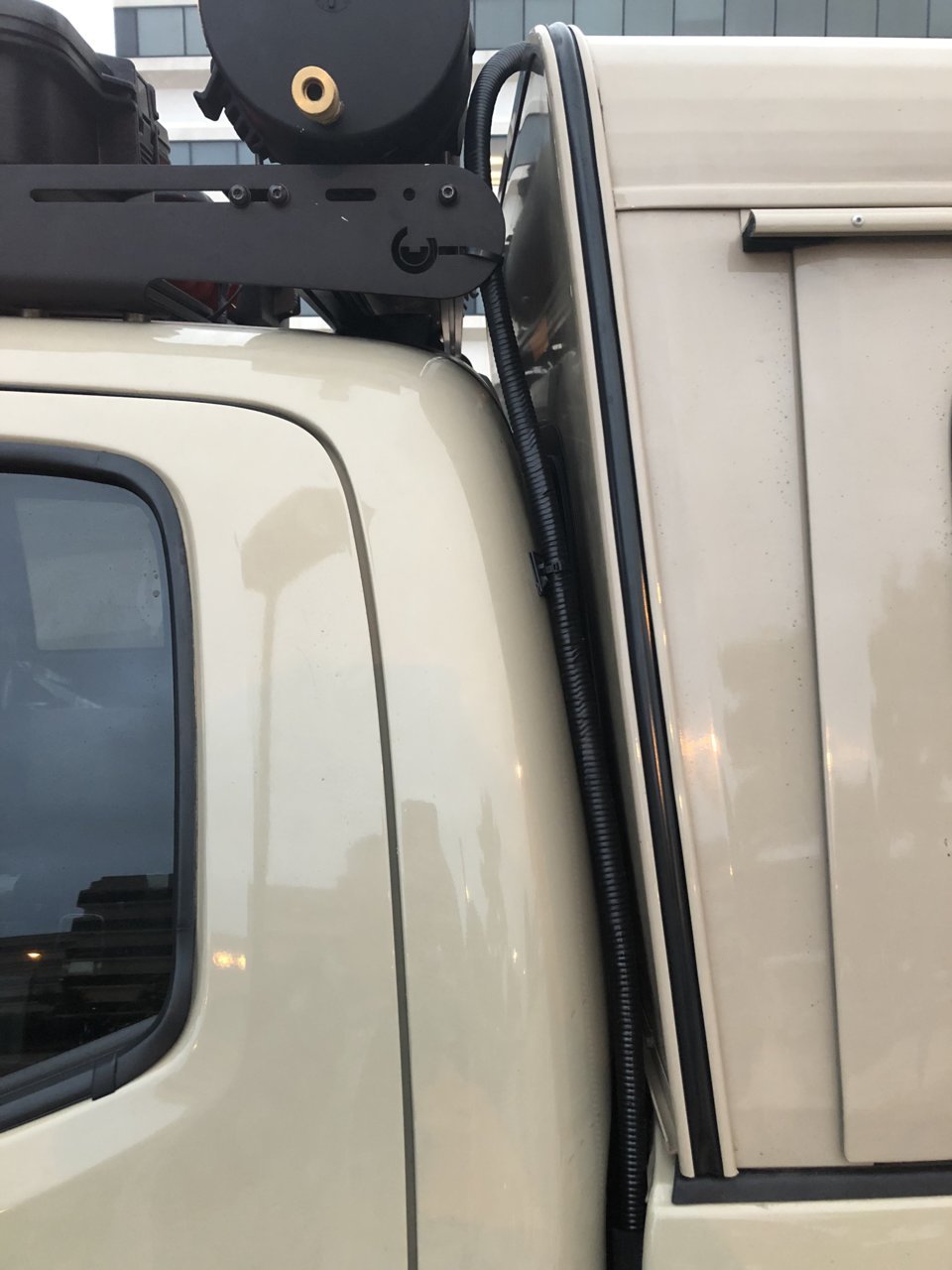

    And some 10AWG wire, in-line fuse, and ring terminals coming off the battery. And split loom from controller to the panels.
    The controller is attached to my fuse box with 3M double sided heavy duty Velcro
    100W is MORE than plenty to keep my battery fully charged with the small draw from my Snomaster 56D fridge/freezer

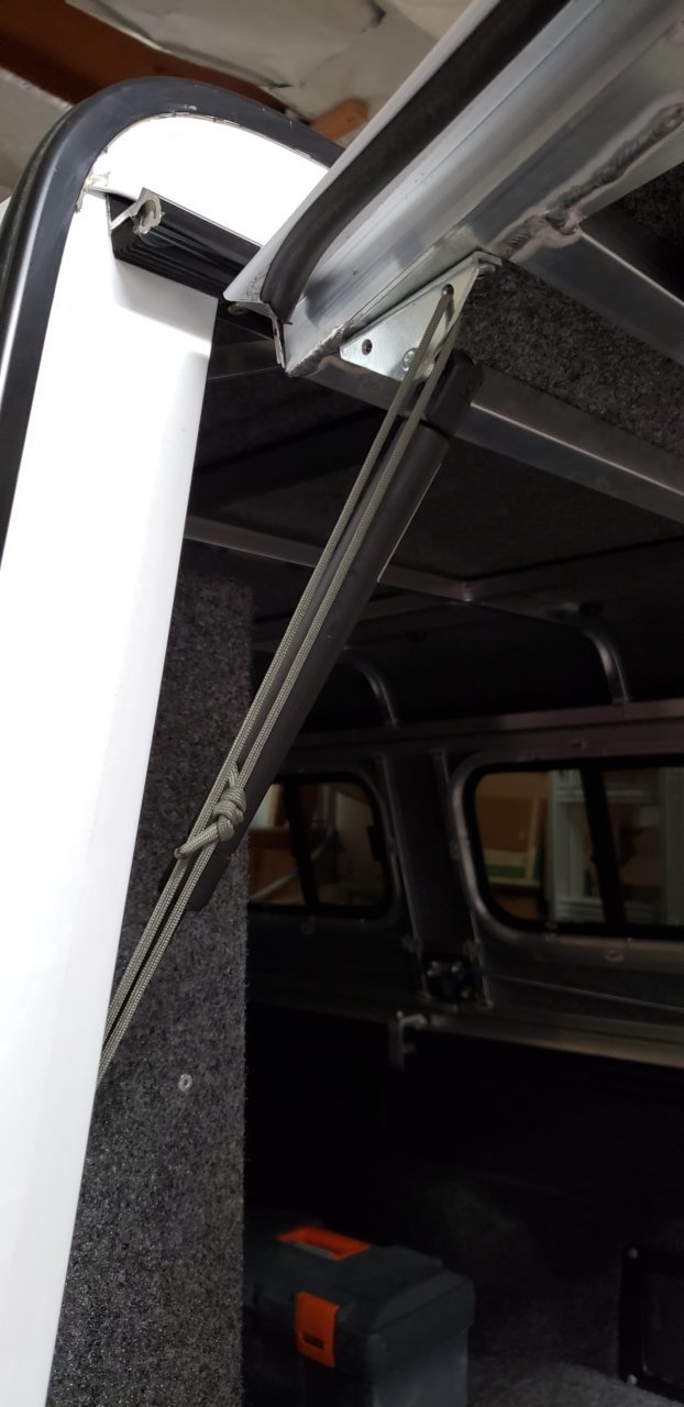

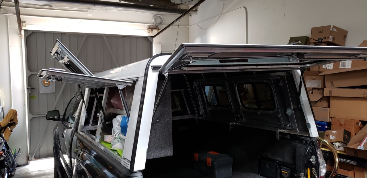

    Well I did a quick easy mod and hope it's ok to post here. I plan to use a tarp over the chuckbox and rear of the truck/shell. I didn't want the doors of the shell to cause tenting of the tarp. What I did was use 30" of 550 cord and a fisherman's knot. For the small doors it's best to use two pieces of 550 cord, one on each side. The larger doors only require one cord. Works great.
