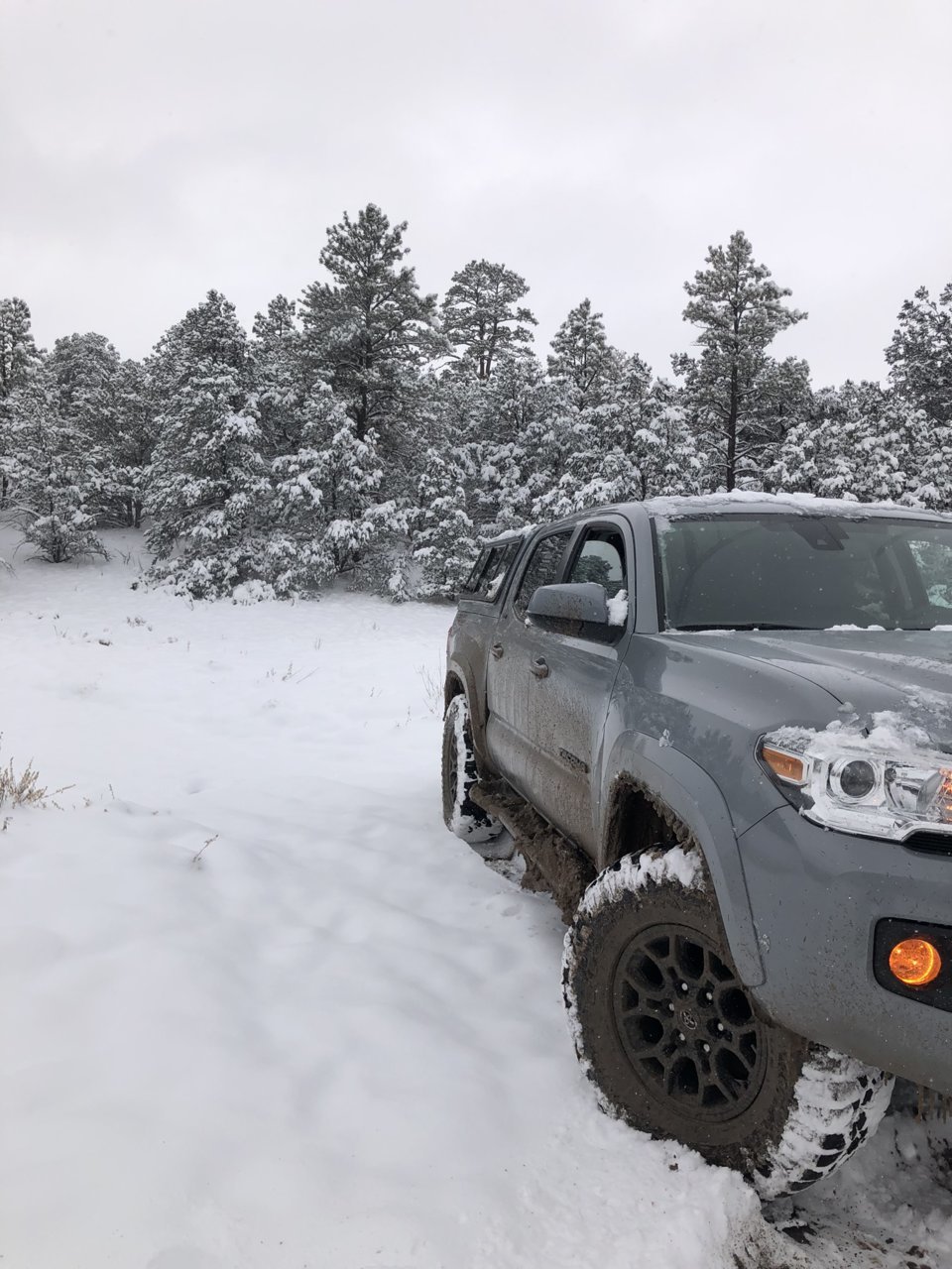

    4hi, a good set of snow tires (duratracs) with studs or chains should do the trick
    been in some decently deep snow and the tacoma (really the tires) have done great
    not sure you need to mess with the diff’s, again tires and studs should do ya
    pics cuz why not
    Red Alert likes this.

    That looks like what I would be doing:thumbsup:
    Studs are awesome on ice but are no longer allowed on public roads in MN.
    boston23[QUOTED] and Red Alert like this.
