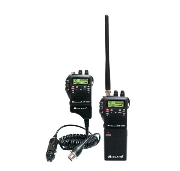

    I'm a HAM that still uses CB. I like the quality of President CB radios. I'm currently using THIS ONE. It's tiny, making it easy to mount in the Taco, and I get great audio reports from folks I talk to. Meaning it sounds great over the air. And it receives weaker signals than other CB's I've used. It with a standard antenna could work for you. Most important is to have someone that knows what they're doing help you mount and tune the antenna. I mount that CB to my headliner. You can see it in my build thread link in my signature.
