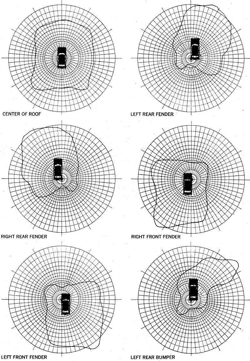

    Placement radiation patterns (ground plane):
    A ground wire likely is useless.

    For trail use, having it on the bedside towards the rear will work fine. Don't let charts and graphs worry you. It will work just fine with a good ground.
