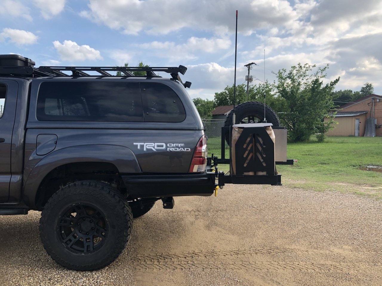

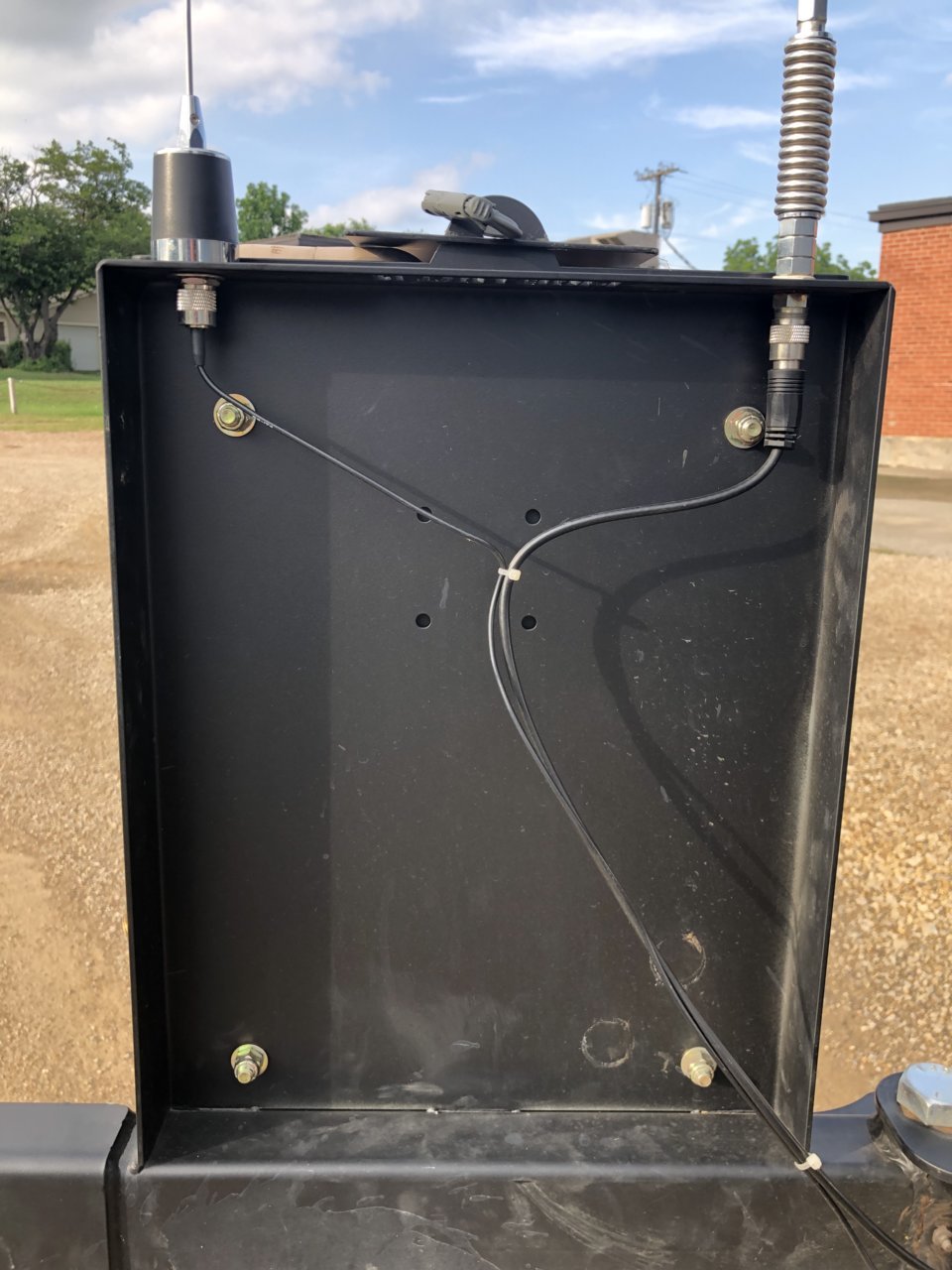

    No, I didn’t try different spots on the truck. I chose that mounting location due to practicality and location. I guess I’m hoping a longer antenna could compensate for lack of ground plane.
    They have a new tiny antenna that might work well mounted to a Prinsu rack on the cab, I think @ETXTacoma is looking at.

    I have a motor mount that allows me to use a decent length antenna. Remind me what frequencies you are on (2M, 440?, HF?, or just CB) as naturally that plays into it.
    I didn’t research that coil but, coils don’t have the same properties as a true antenna.

    440
    I’d like to keep the swingout mounting location and add the longer antenna (that I’m quoting in this post) to gain better reception, as it’s 5” longer.

    Cool. Ham radio is a lot about try it and adapt. I find the pickup shape is pretty decent overall as a RF ground, although my best performance transmitting is when I have it mounted anywhere near the center of mass.

    Now I’m second guessing myself.
    Tall antenna mounted on swingout.
    Short/stubby antenna mounted on cab.

    Ham conundrum! :). Wish I could give you “the” answer...I can only give my anecdotes! Frankly ignore me and go forward.
    Theoretically you can model and predict. Practically, well, that’s not been my experience. I generally fall back on an approach that keeps my options open. I have mounted, tested and used countless antennas on vehicles since doing so for my Dad first in 1978, though and including today and beyond. The best performance I ever got was dead center on a 1982 station wagon. My current setup is off center roof, owing to practical requirements (other crap on my roof) and I can hit simplex and repeaters at 30+ miles on 2M regularly. My Shack gives me much better. But mobile is “good enough”.
    You can always try it. Duct tape. Get a buddy or two that are ~15-30 miles away and test, at low power their signal received from you simplex. You can also hit a repeater (off hour) and drive away slowly until you can’t open its squelch. (Ask the owner best times off hour and defer to any traffic) or engage a friend or both.
    It may come to pass that it makes a lick of difference for how you might mostly use your rig. Don’t forget to test on 2M (if you can) as it has different ranges from 440.
    Or, as I started, ignore everything I said.
