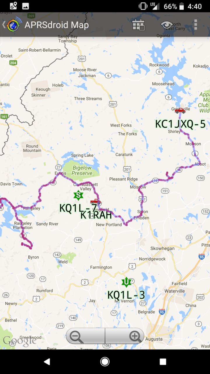

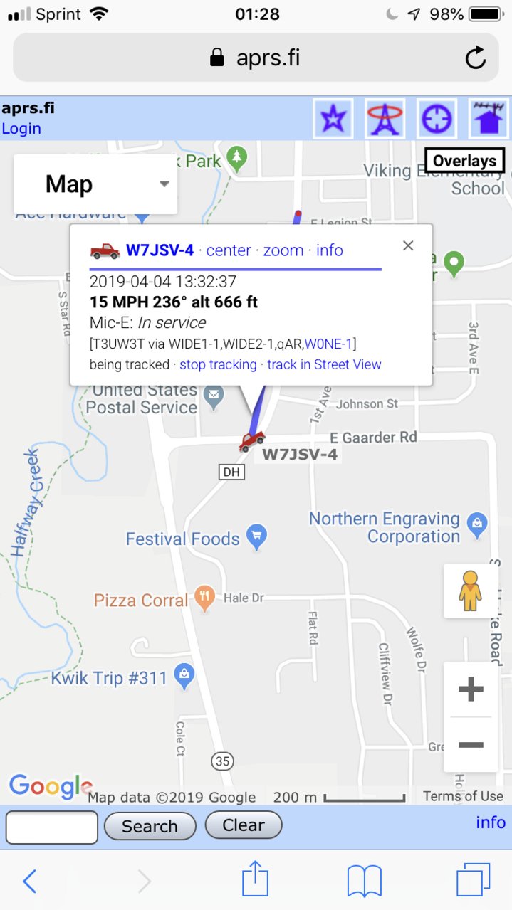

    I'll keep it short.
    Uses radio waves to share information such as frequencies other people are on, their location, messaging, and also plots their track if you'd like. Can be fed to a map like this. Needs no internet.

    Automatic Packet Reporting System. Digital packet radio is essentially using your radio to transmit small bursts of data to other radios and the internet.
    It’s most frequently used to report positions and send text messages to other radios and to SMS systems.

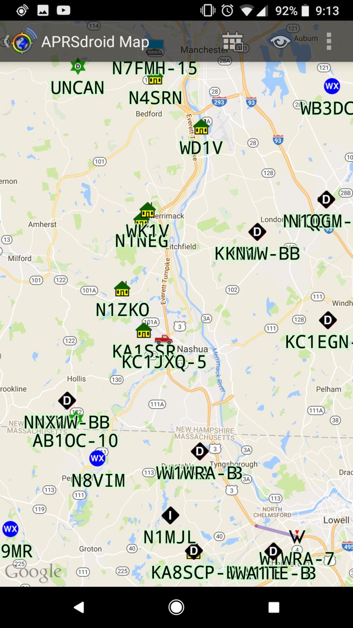

    I think the biggest thing is there are towers that gather all this information. They all use the same frequency . I think the thing right now with GMRS is they haven't really put up towers with a GMRS frequency yet.
