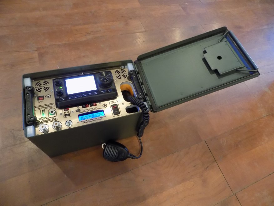

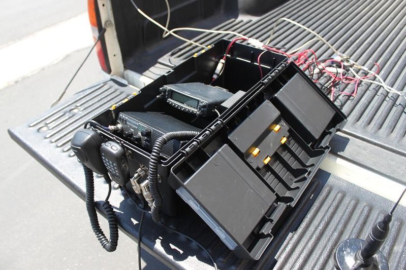

    My radio box that I am ALLLLLMOST finally done building.
    I plan on taking the CB out and putting a CB/SSB unit in its place. The HAM radio is a Yaesu FT-8900R 4-band. Technically, my radio box will have 4-bands, LSB, USB, and "CB" for a total of, again, technicallllly 7-bands.
    When it was under construction. Currently in storage because of moving. But anyways...

    Within the "10m band"? Very interesting if that is the case?
    I work with SSB related comms. What is being described here is pretty interesting for it being a "native CB unit".

    That's awesome ! I'm looking to do one with an IC-7100, mtx115 and a cb that's yet to be determined for deep woods safety.
    Might set up a tablet so that in a true end all be all emergency the mrs can use a code generator to key out if need be.
    I'm more safety concerned with my trail comms than I am group conversation wise. Packs are short. Like mentioned above, most CB and GMRS are well up to the task.

    Mine is going to end up being battery (i.e. only for short burst emergency TX'ing), external power, and/or car cig port capable. Meant for HQ type setups or SHTF deal setups. I've seen setups at the "Field Days" and hoping to get mine ready this year by then??? I doubt it though and will have to wait until next year as FD is just around the corner... allllllready. :oops:
    That Icom is nice and :spending:. My old boss had a few different Icom radios and that being one of them. :thumbsup:

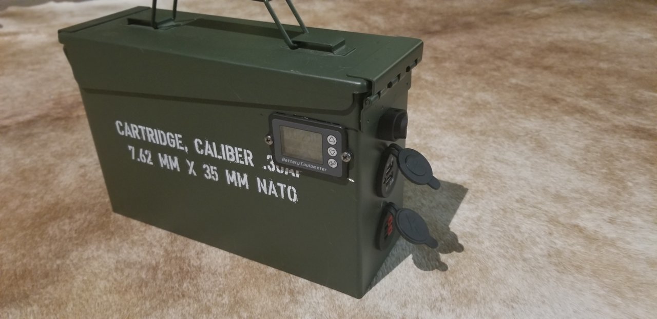

    Yes.
    pickup truck
    DIY 30 cal 25ah LiFePo battery.
    VE7OSR, SR-71A and m603holden[QUOTED] like this.

    I've got some pretty big Lipos I'm going to use

    I'd be interested in what your method is to get 12-13V nominal from Li polymer batteries. Stepdown xfmer?

    I can back feed it through the charger. I'd be restricted to qrp, but if I'm using CW hopefully someone in the area would have the ears to pick me up.
    Or I could just use it as is, the ic7100 will take up to 15.9v. The bigger thing for me is the c rating. It won't be my primary, but for small and portable it's not bad for emergencies
