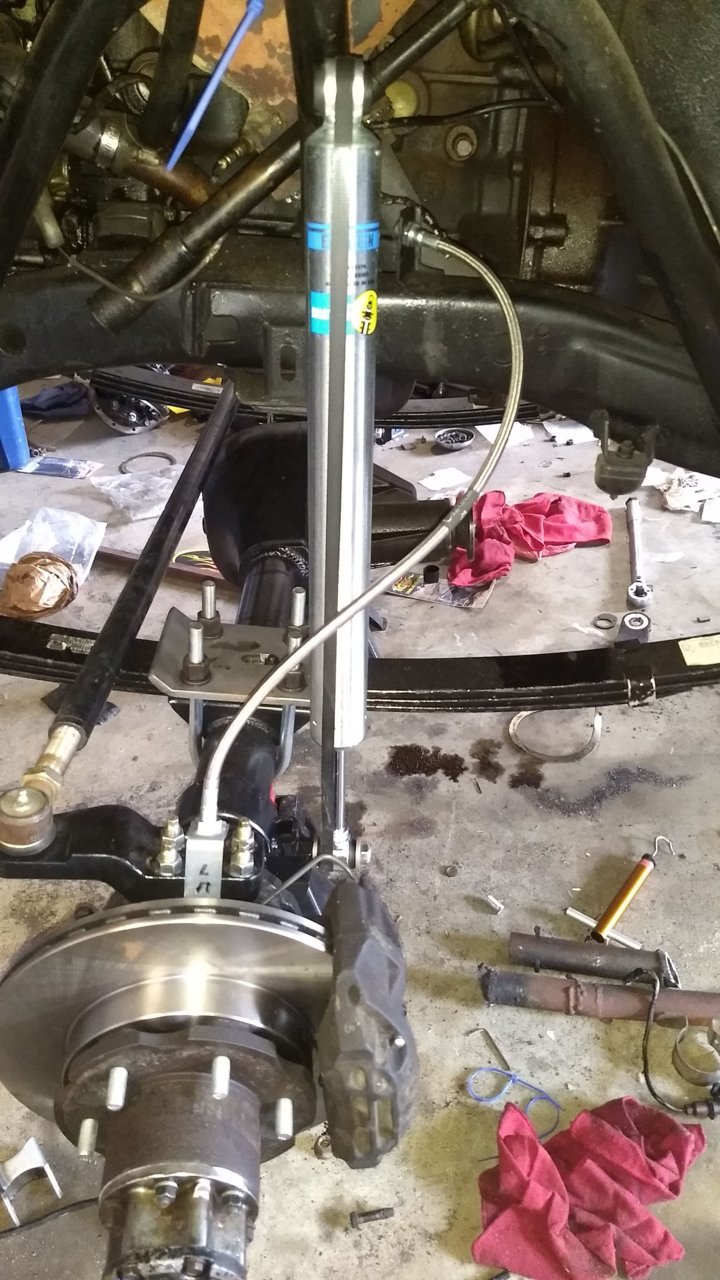

    Just an FYI...
    83 Tacomas are narrower than whatever truck the Trail Gear "Tacoma" axles are for by like 5 inches. :annoyed:

    You tried installing the TG Tacoma axles in a "83"?

    The perches fit

    That's why it is referred to as a "+5" housing. It is Tacoma width. There was no '83 Tacoma, they started in 95.5.
