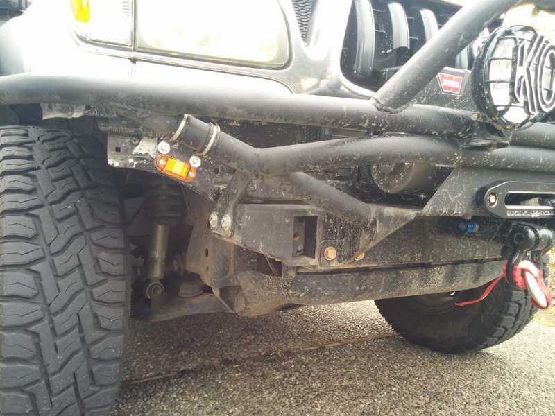

    I recently installed the low profile front bumper from Trail Gear. I notice that there's a wire harness that's exposed on the passenger side.
    I assume that this will be an issue when I encounter some brush that has hopes of yanking that spot.
    So with that, any idea what that is? Also, any ideas of how I can protect that area?
    Thanks for the help
    http://postimg.org/image/8l8mb6in9/

    That is the wiring for your windshield washer Reservoir. Many get a different fluid Container and relocate in the engine bay.
    whitey420[OP] likes this.

    From the link you sent I read in the comments that someone found this reservoir to be compatible with the oem connections. I've purchased it and will report back how it works out. Thanks again for the help!

    I wanted to update on the installation as it was completed this past weekend. It does indeed fit and works; however, I had to swap out the water pump with the original one I had pulled off of the reservoir. When I first installed everything with the included pump there was no water that went through to the nozzles and I could hear the pump struggling. Luckily my old one was still working just fine. I'd recommend to others to purchase a different reservoir for a lot cheaper (especially if you can re use your original pump).
    Will work on a better looking bracket eventually.
    Empty spot now needs to be touched up now.
