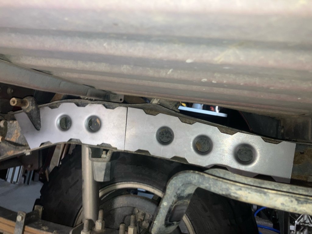

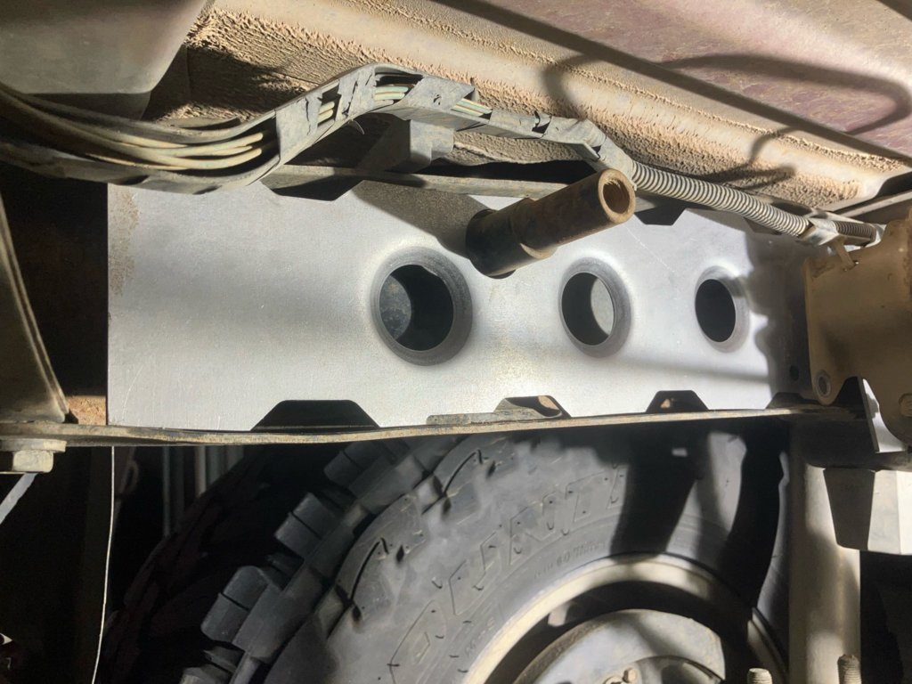

    Thanks for the support! We designed ours to not require relocating anything and to be as plug and play as possible. We actually just confirmed they fit DC Tacoma's as well:
    You only need to notch the D2 plate a bit to clear the E-locker breather if you have one.
