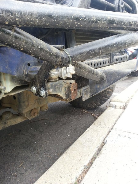

  20. Jun 15, 2017 at 8:27 PM
    #20
    Fuergrissa
    Fuergrissa If you build it, trails will come.
    Jan 9, 2013
    #94858
    2,125
    Devin
    San Jose
    2000 T4R Limited
    For people who need an answer
    cut off the cross member housing the skid plate nuts, smooth the frame posts with grinder. After posts are smooth the mount plate fits like a charm.
