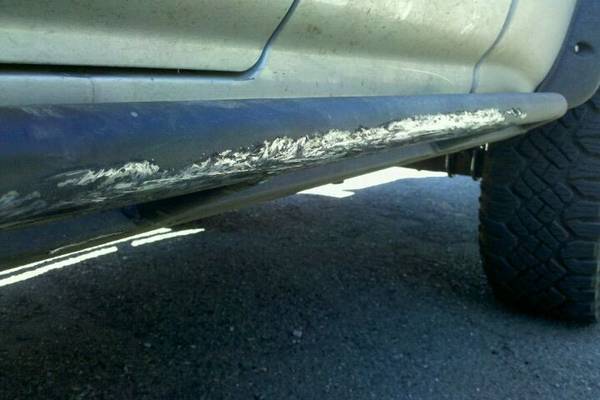

  6. Jul 15, 2011 at 10:12 PM
    Mike330R
    Mike330R [OP] Well-Known Member
    Jun 23, 2011
    #58757
    2,644
    Far West Phoenix
    '16 DC Offroad
