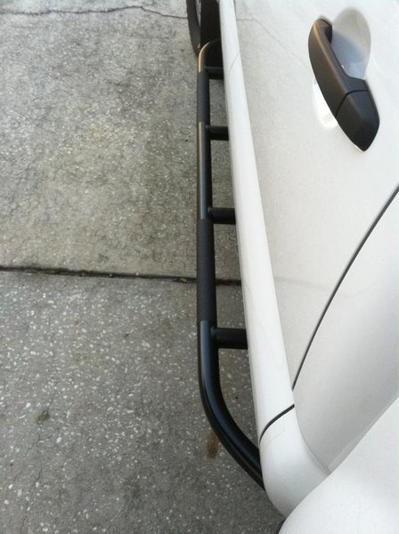

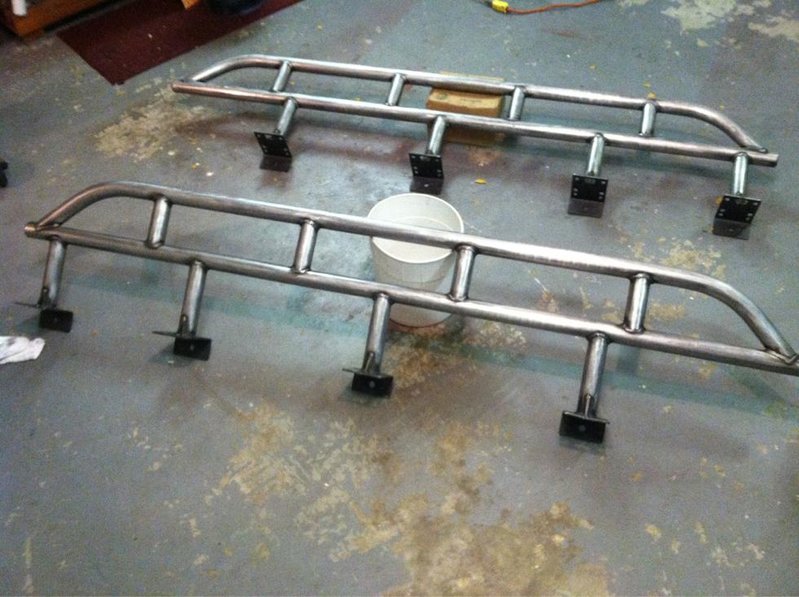

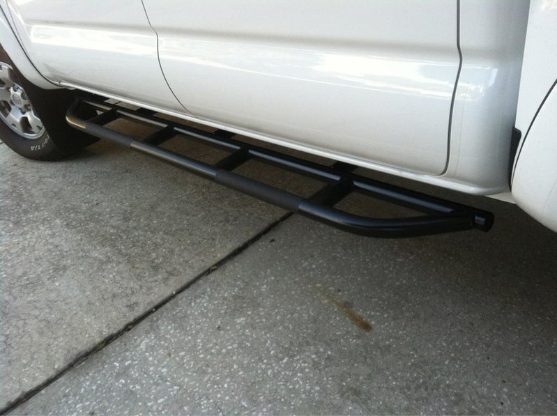

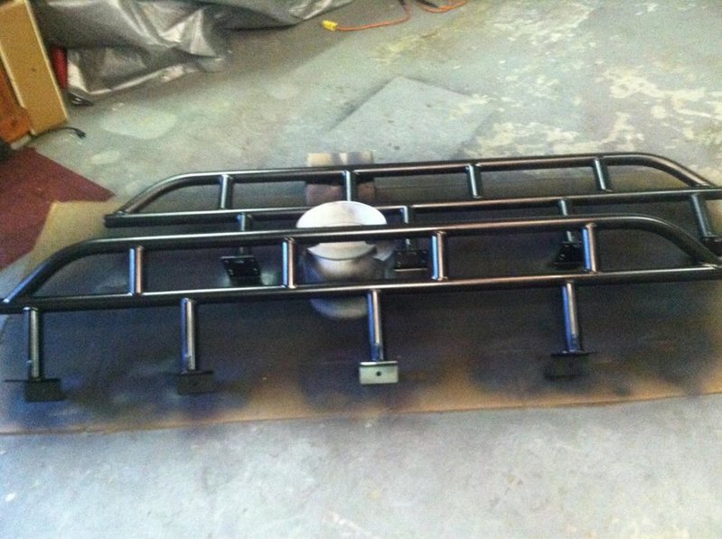

    I'm not sure why Tacoma world does not promote Trail Gear sliders. They are one of the toughest sliders out there. I think they are very good looking and the price is very good. They come raw and you have to drill to mount them. They are at 0 degree, so they stick out far enough if you bumped into a tree the sliders would stop before hitting your door.
    I had them on my FJ and had Trail Gear on it.
    No I'm not from Trail Gear and I'm not getting paid for saying this.
    Prep
    Prime
    Paint satin black
    Drill and bolt on

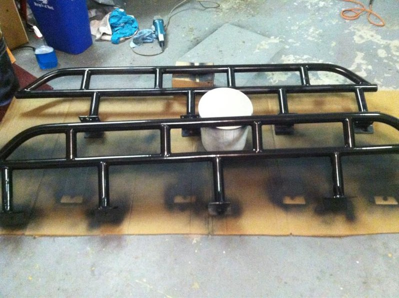

    For prep I sanded the sliders with da sander and hand sanded any spots that the da could not get.
    Next I used a mineral spirits and clean rag to remove oil. Next I used a metal prep solve to prep the metal. Then this is my finding, I use windex window cleaner.
    Now Prime 3 coats. Progressively heavyer each coat. Wait min. 12 hrs.
    Next paint 4 coats. Last being heavy coat.
    Now the hardest part. Wait 2 days before mounting them.
    Then touch up bolt heads with paint to prevent rusting.
    Done!!!!!

    Thanks OP :thumbsup: I sanded today but couldn't paint. Will clean with 2 cans of brake cleaner then prime with self etching primer tomorrow. Problem is I only got one can... I feel like I'll need more? Got 1 can of flat black paint and 1 can of textured flat black paint.
    Is there anything you think I don't have enough of?
    Also how long was your drilling and mounting process? How did you get them at 0 degrees? I bought them during their free shipping sale and they have slight angle.

    Little slim on the paint, but that's ok. I will tell you drilling the double frame is a bi**ch. Make sure you drill in steps, little by little. I drilled two holes each side. Then marked all the holes, pulled them down and finished drilling. I used a air drill 90 degree, it gets in all the hard spots. If you can and know how, sharpening drills after every two holes will make your life better!!
    As for 0 degrees that is how they come. Should not be at a angle after mounting.
    Have fun, Bret
