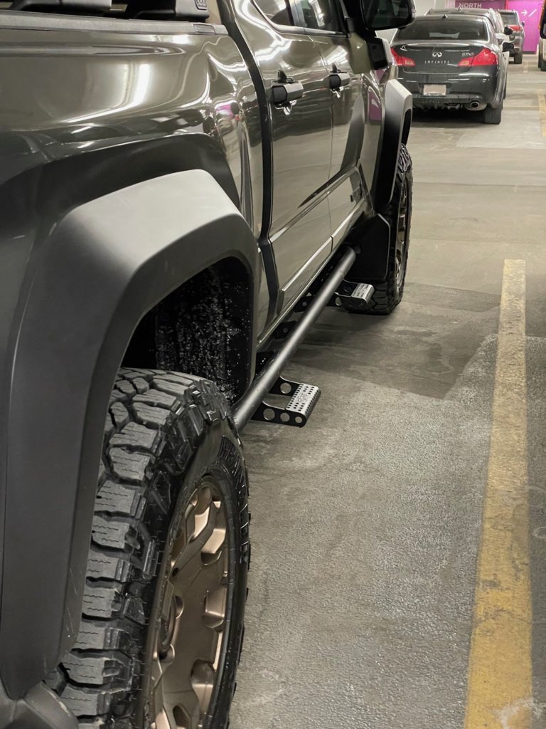

    Yeah I was also committed to spending more money for step rock sliders as well if this low cost option didn’t work out to my satisfaction but so far I’m happy with the NFab steps.

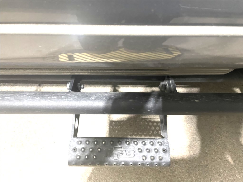

    From below the slider lift the Nfab steps tight against the gussets between the inner and outer step tubes (they may fit better on one side or the other of the gussets as you don't want to mount the steps against the gusset to tube fillet weld as it won't sit as flush) and mount with the bolts and nuts supplied through the holes in the gussets (no drilling required). Tighten until the step and gusset are reasonable flush.
