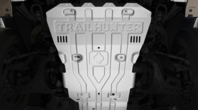

    Reaching out to the group, does the 2024 Trail Hunter steel skid plate fit a 2024 TRD pre-runner.?
    I tried to purchase the parts through the dealership online and the confirmation doesn’t clearly state if it will fit. Gotta love the statement and check out (“This part may not fit this vehicle” the Toyota website is not very clear)

    The Toyota website is super slow to update fitment. For instance, it was only after many months did the TRD Pro finally show up in the Toyota parts selector.
    Does your truck have that front crossmember?
    Example of what and where:
    2024-Current Toyota Tacoma Front Frame Cross Member — NYTOP | Not Your Typical Original Parts
    These instructions are for the LC250, but they are very similar to the Tacoma for install. The skid plate is almost identical, save for a few bolts specific to the Land Cruiser. But other than "Trailhunter" on the Tacoma version they're essentially the same.
