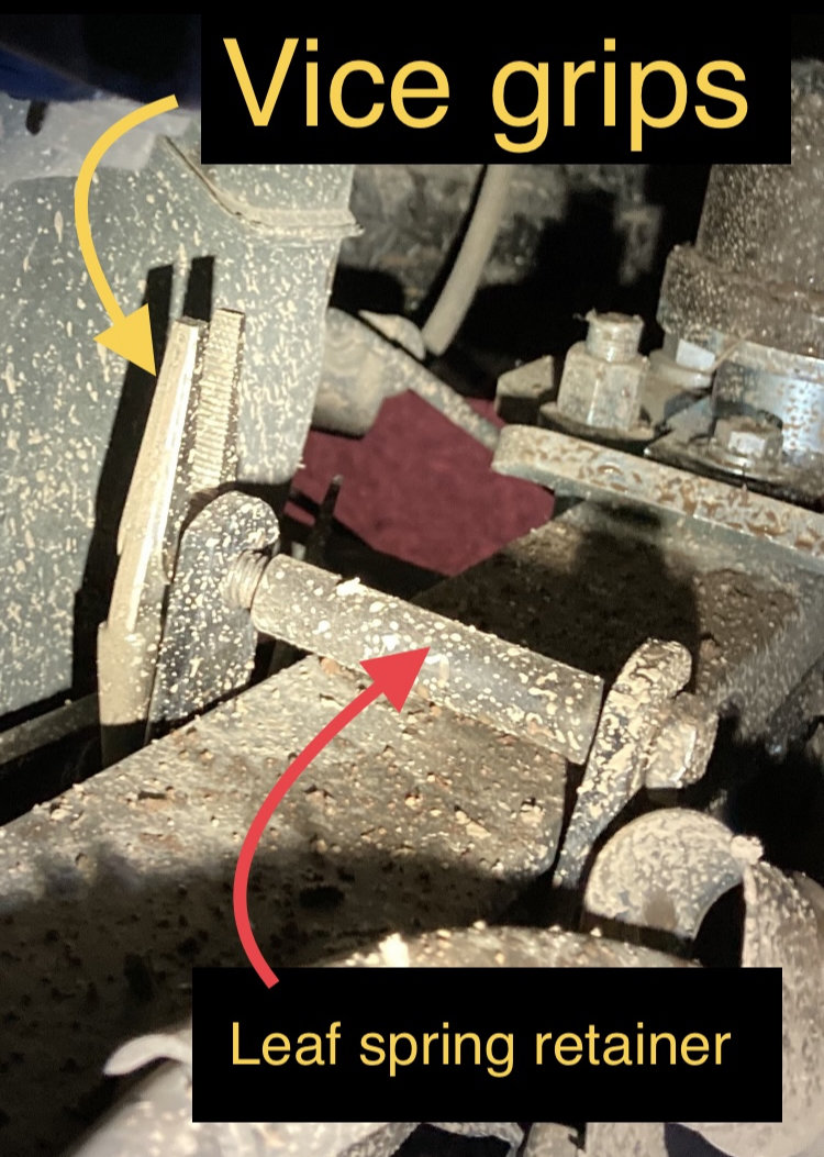

    I keep hearing about recoveries performed with field-expedient parts and tools, then it happened to me today. It wasn’t some emergency, but I had to think of something so the situation didn't go from bad to worse.
    I couldn’t find a thread dedicated to MacGuyvering on the trail, so here’s what I did today when I lost the DS leaf spring retainer nut:
    D516EF17-DF66-4D98-8041-4D8F4383497E.jpg Guess I didn’t torque this one enough during 3AAL install, but vice grips clamped around the retainer bolt, then held clamped with zip ties worked great on both high-speed and technical trails the rest of the day.

    Oofadoof, even with a zip tie I would be nervous as hell about that holding. I'm glad it worked!

    Suggest to replace that bolt. I'm sure the vise grip bodged the threads.
    Then use lock nuts. The most resistant to vibration are the lock nuts with the nylon ring. Generally, called Nylocks.

    yup just did this with grade 5 bolts and nylocks!

    Educate me... what is the worst that could happen if retainer was removed?

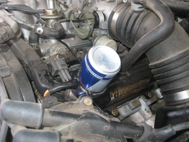

    Driving my 1991 Pickup back to Colorado form Alaska I had to fashion this oil filler cap after forgetting to put it back on....

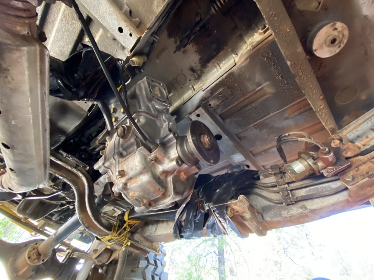

    #206408
    1,312
    Gilbert, AZ
    2021 Lunar Rock Tundra TRD PRO DC
    Sheared all three transfer case mounts on the Samurai at once a while back. Got it lined back up on its mounting points and secured with duct tape, bailing wire, and paracord to get me off the trail. I like this thread a lot! I've done plenty of this crap over the years!

    Yikes how’d you manage that!?

    6.5:1 low range in the case, original rubber mounts from 1988....
    It's in a hard mounted cradle now. Tons of sound and vibration in the cab but its a crawler.

    Holding "a little bit" is better than not holding at all.
    I've heard of people using duct tape and/or bailing wire, hose clamps, etc...
    You do what you gotta do to get you home.
    I'm no expert but that seems bad.
    If that were true, why to leaf spring manufacturers use them?
    Probably to prevent this:
    217321d1382562719t-leaf-spring-fanning-o_939d84c9361f7771ba9f7803269d88617c500d19.jpg

    ok, well, you go ahead and not replace it or do anything to try and fix it if it fails on the trail.
    I'd rather not take the chance, and I'm going to take the 5 minutes to try and fix it if I can.
