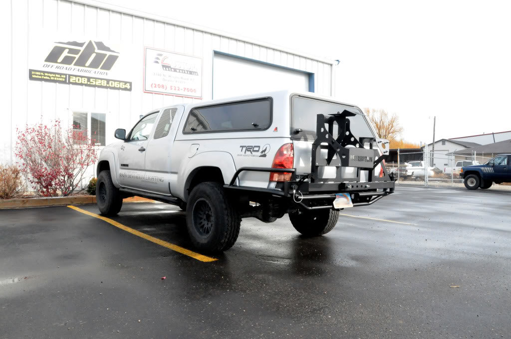

    You'll see when you get it... Simple to secure your stuff. ;)

    and then there was three.... :yay:
    I see a few alterations but overall it's the same as mine - I'll be adding the dual can carrier to mine as well. :D
    There were some subtle differences between Brant's & mine too.
    Welcome to a very exclusive club. :cool:

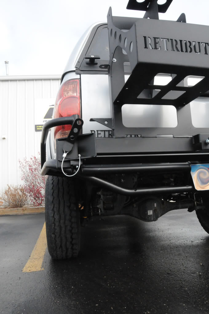

    I was at a meet this past weekend where there were several brands of HC rear bumpers w/ tire carriers.
    This design offered the highest bedside clearance by several inches as well as having the most secure latch mechanism.
    I'd also add that none of the other tire gates swung out to 180* either... :cool:
    I know i'm partial to my own, but those are facts... :cool:

    I didn't even think about trying to swing it out 180* Haha. How is your latch to keep it open though? I know there's a ramp type thing to push it up when opening the gate, but it still gets caught and I have to pull it up and then keep pushing gate. Then once it locks, it's a bitch to pull it up again and close the gate. I've never had a swing away before but pushing it open is hard too :eek:
    Still a sick bumper though!
    It's an awesome design!

    Mine has the tube that is cut at an angle. I did have to bevel the pin to get it to slide up the angle nicer though. I would try that. And yes, the more weight you have on the gate the stiffer it is open. But that does come in handy when you are not level and want to open the gate.

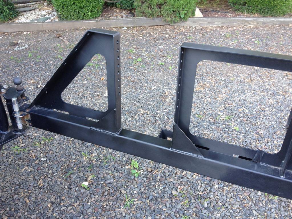

    I'm thinking about tapping a zerk into the upright of the swingout. My gate is getting tough to move. :eek:
    Gotta love the NE for rust. :rolleyes:

    Apparently I'm tough on my shit... :eek:
    Last weekend I had another member weld on a few gussets onto the swing out.
    Note to self: avoid backing into trees on the trail.:rolleyes:
