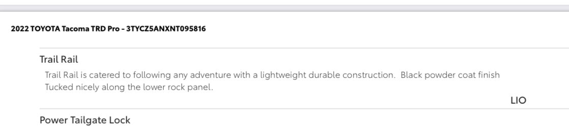

    Hey guys - getting a TRD PRO in a couple weeks.. it comes with a “trail rail” and was thinking to replace if with the tube step but the salesperson says it can support the weight of the truck… is this true? Is it bolted to the frame ?

    Seems legit. Made by n fab

    I hear it’s legit and made by nfab. It doesn’t say nfab so I wonder how people know that.

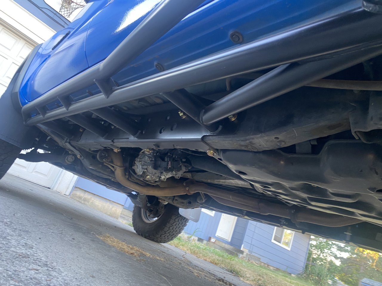

    If you want protection you want frame mounted sliders, not steps or the trail rails. There are multiple companies that off sliders that are big enough to work as steps as well.

    I would not consider those trail rails as heavy duty. Anything that bolts to the rocker panel is only as strong as the rocker panel sheet metal. If your looking for strength you want a set of frame mounted rock sliders. They are made from a high strength steel tubing and plate and are bolted or welded directly to the frame of the truck as it is much stronger than the sheet metal cab. Here is an example:
