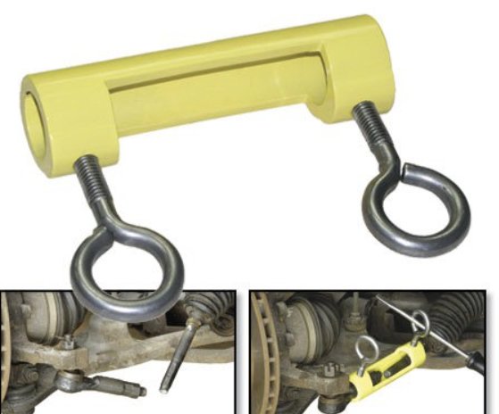

    If I need to do a trail repair of a broken tie rod on my 2016 TRD Off Road what tools should I bring?
    What parts do I need? Just the outer, as I believe it is most common to fail, or the inner too?

    It's not a common failure unless you rock crawl, and these trucks really shouldnt be bashing rocks too much.
    They do sell these bad boys though, wouldnt hurt to find a tie rod sleeve either way.
