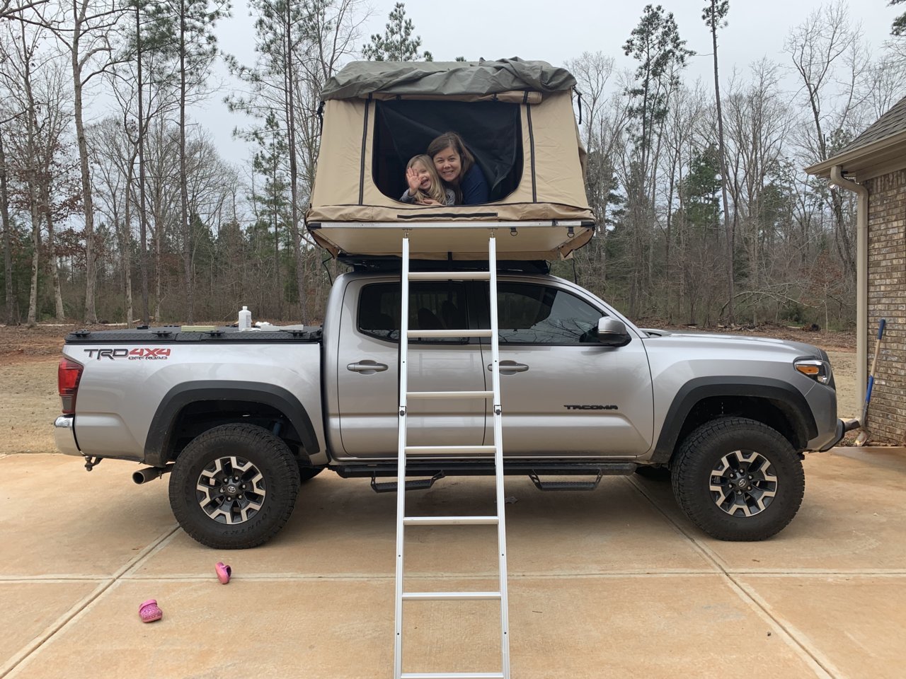

    Hello everyone,
    I am a new member but have been using the forum for reading and research purposes for a few months.
    Currently I have a:
    2018 Tacoma OffRoad4x4 DC SB
    Bilstein 6112 (front)
    DiamondBack bed cover
    Warrior roof rack
    Smittybilt RRT
    I want to add a semi hidden bumper and winch but I’m worried about the overall weight of my machine.
    My question is how heavy is your truck when you go camping, wheeling, and or “overlanding”?

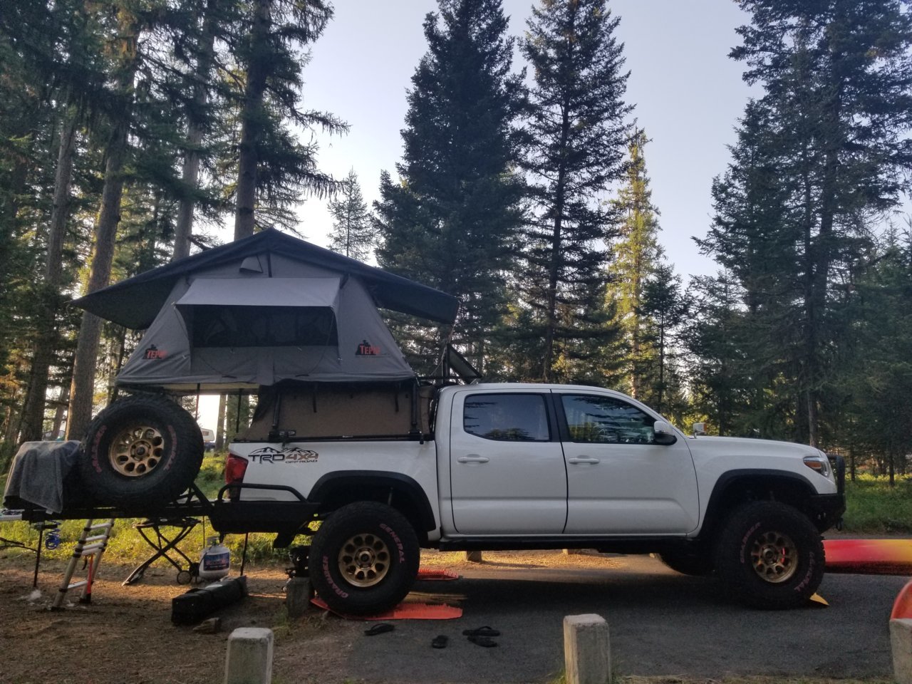

    Camper top with sleeping platform, tools, camping gear, food, fridge, sliders, full skids, HC rear with swingout, winch front bumper, tires, roof racks, awning, firewood...
    The factory SR5 DCLB 4x4 is quoted at 4480lbs stock. I wouldn't be surprised if I'm at 6000lbs or more loaded. It adds up quick. I have 700lb rate springs up front and Dakar leafs with sumosprings in the back, so it still rides nice. I get about 18mpg city or highway, doesn't matter.
    Most of what I do is trails, nothing too heavy. I wouldn't hesitate to take it anywhere considered "overlanding" or mild to moderate offroading. There's tons of crazy stuff I wouldn't do at offroad parks, and I typically avoid mud since I have ATs, not MTs. I haven't had any trouble other than beaching the middle of the truck on a berm from a lack of ground clearance.

    You don't sound too heavy right now. The tent and roof rack must weigh under 150 lbs. And that's pretty much all the weight you're carrying. You're thousands of pounds away from that straw breaking your back... Now, steel front/back bumpers and a pop-up camper in the back... then you're pushing it.
    Also -- what happened to the rear passenger step? Catch a rock?

    Believe it or not... a tractor trailer tire at 3am doing 80mph.

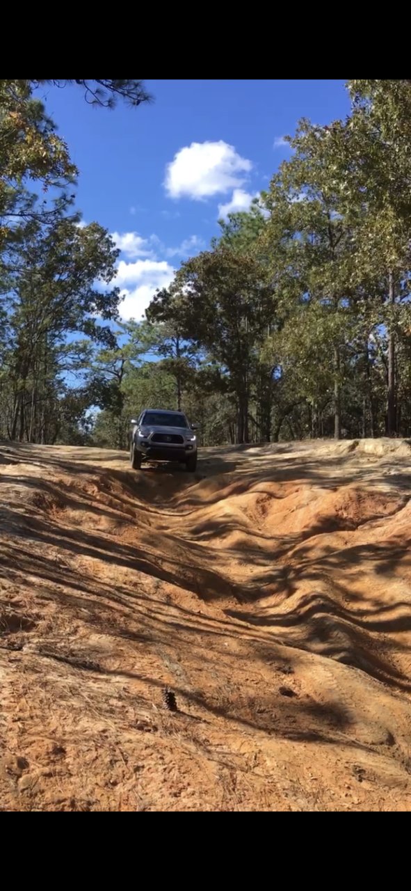

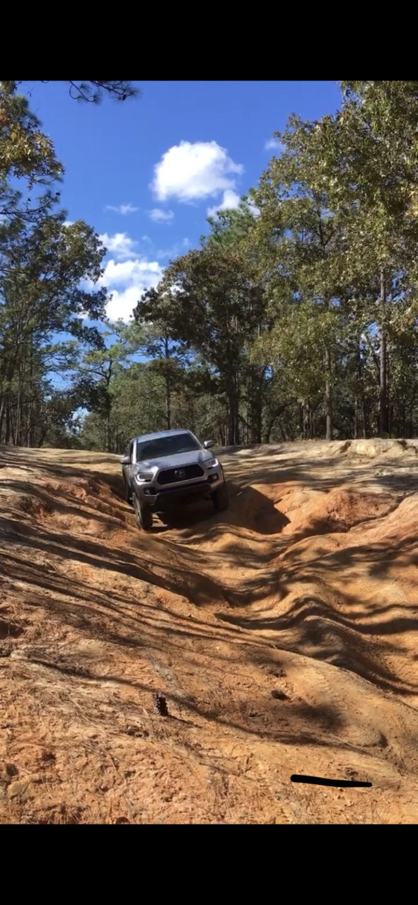

    Had no issues here. 182118BD-7CFB-4F87-B449-82AC7D8C83F0.jpg2B9C29A7-2C54-47AA-BF39-715E87B1E5E0.jpg

    Wow. That could have gone really bad.

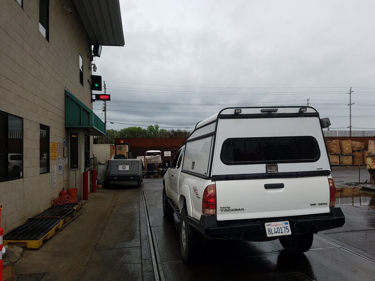

    my rig was very heavy fully loaded. hit the scales on the way to red clay rally last year, 6420#, minus the RTT which I picked up on the way, so add 150# +/-. likely the reason 2 ring gears kerploded on me over 2 years. :anonymous:
    https://www.tacomaworld.com/threads...-gossip-thread.411211/page-6704#post-17945180
    truck was 2015 access cab, full armor, bumpers, winch, rear swingout with tire and jerry can, extra spare tire underneath, HD skids, sliders, plenty of tools, gear, extra fuel, water, camping gear, spare parts, etc.
