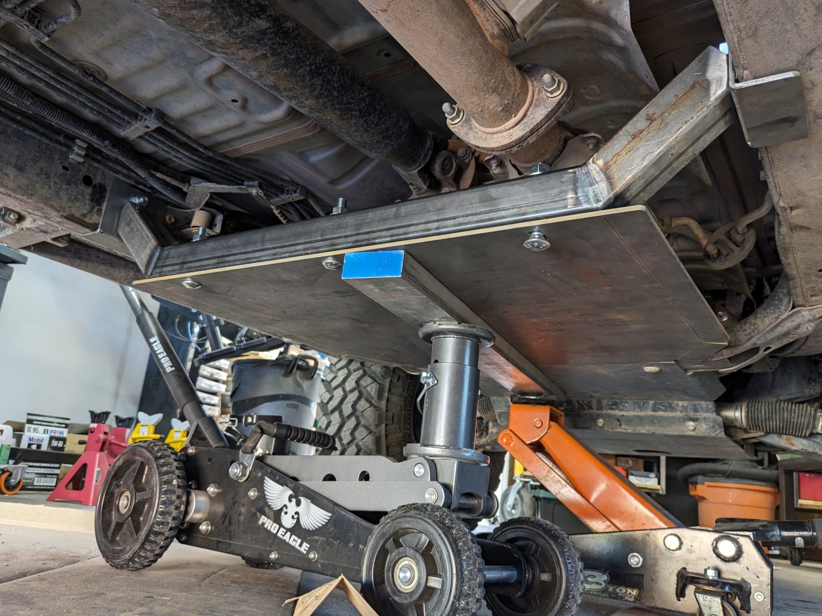

    Thank you! It's been quite the journey!

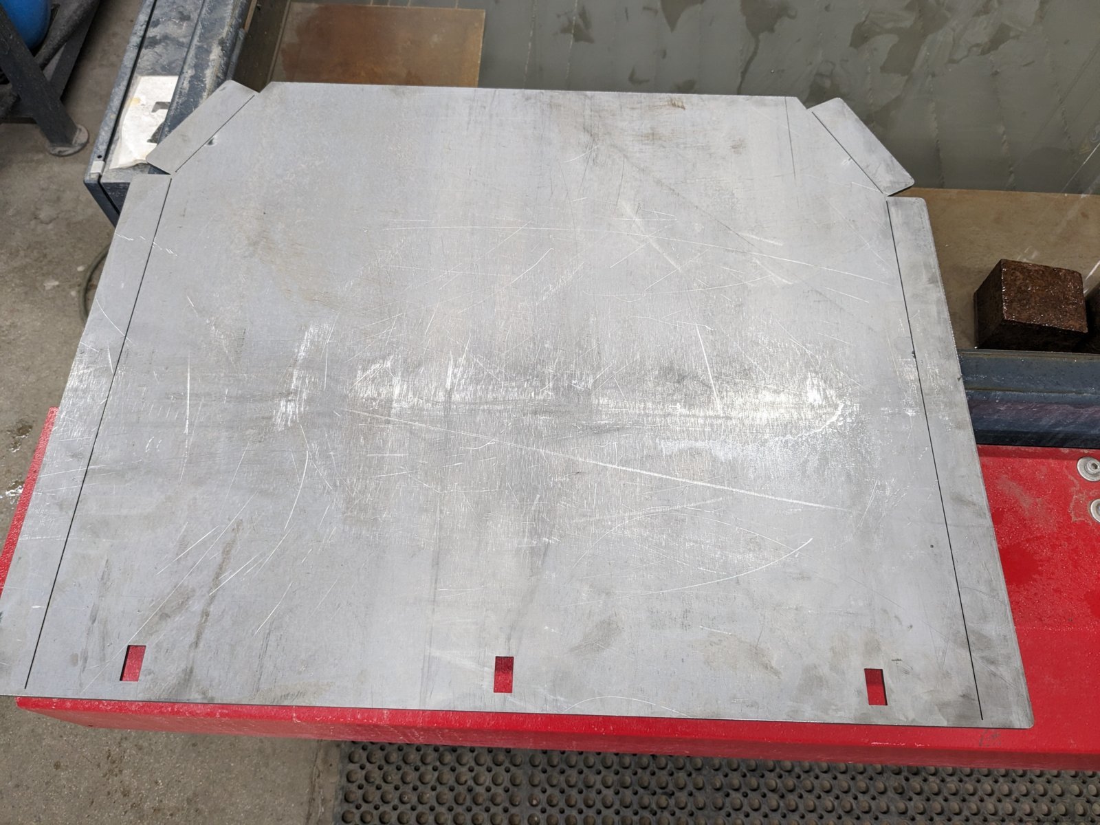

    Here is the skid: I made a new cross member after the transmission member that bolts to the frame. This will help mount the additional skid that I plan to weld to my transmission skid:
    I haven't folded up the edges just yet. I need to finish it today.

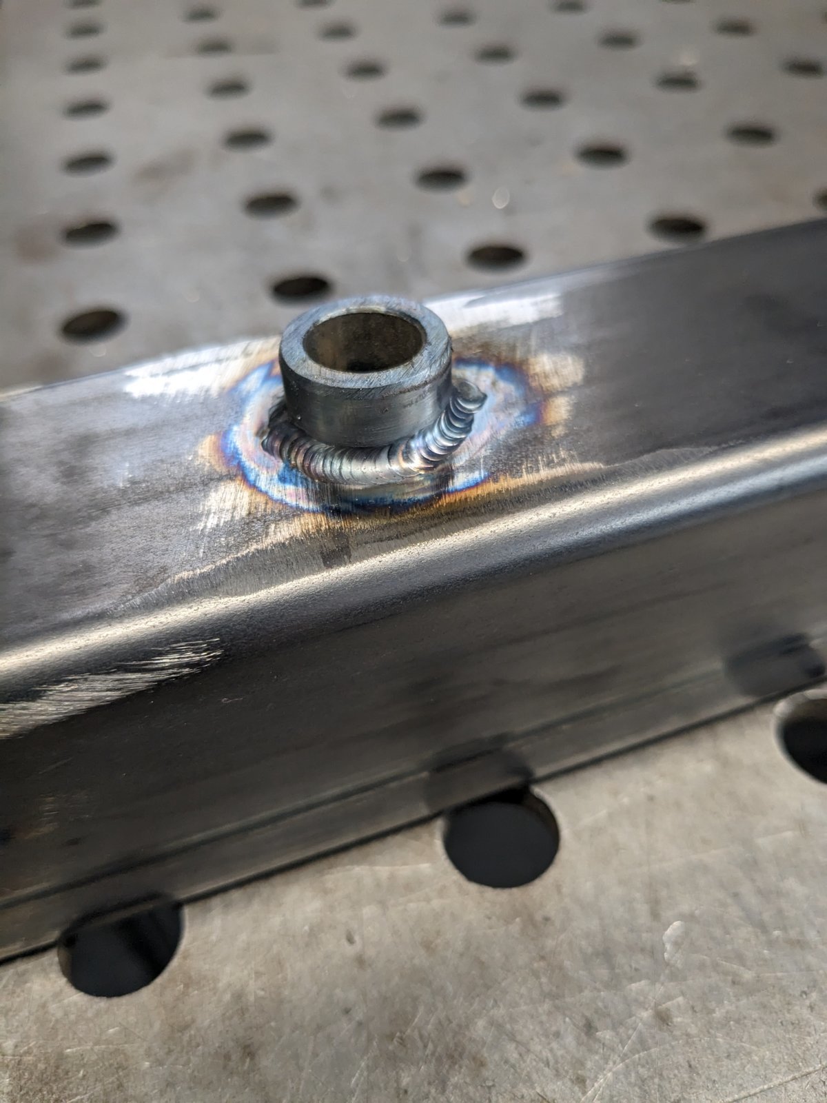

    I use carriage bolts so I can still remove them after I grind the heads on rocks .
    I stole this design from @cbechtold and made my own changes as I saw fit. Mostly I made the cross member sealed so junk doesn't get inside (sleeves where the carriage bolts penetrate the cross member)

    Hope you can make it!!
    Looks great, clean work. Will be fun to put some scratches in it.

    Pretty slick:thumbsup: Nice to have a laser and cut them nice square holes! I like it, Nice job
    @TACOTU3 This would have been a great option as well. Think we went for the extra Beef, we should revisit the bolts. I didn't think about carriage bolts for the three in the middle..
