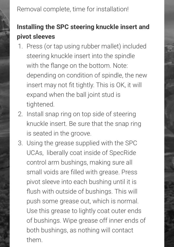

    How loose is it? I don’t remember mine being particularly tight, certainly not press fit. Different brand but here are the @turbodb instructions I followed on mine, specifically mentions the stud will expand it. Perhaps JBA is different tho.

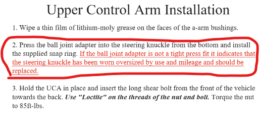

    The JBA instructions say if its loose the knuckle needs replacing upload_2025-3-26_9-45-37.png
    That slug is pretty solid and thick, I can't imagine it'll expand much under the BJ torque but maybe it would

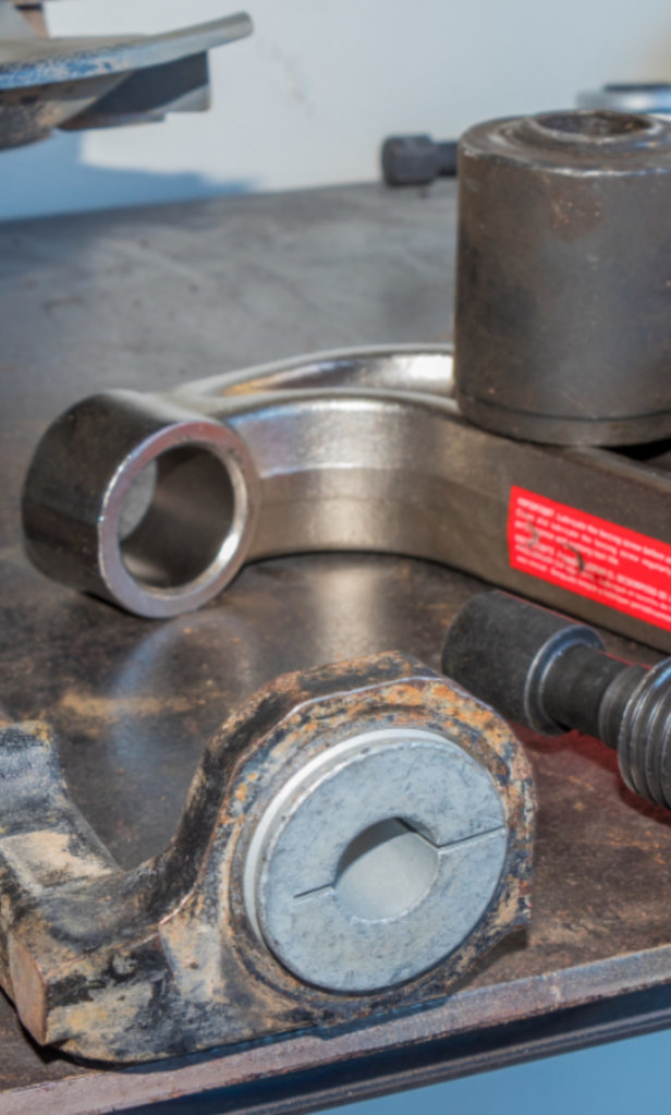

    Ah, okay, looks like the SPC insert has a slot in it for expansion. Bummer! Good luck man, hope you get it sorted!
